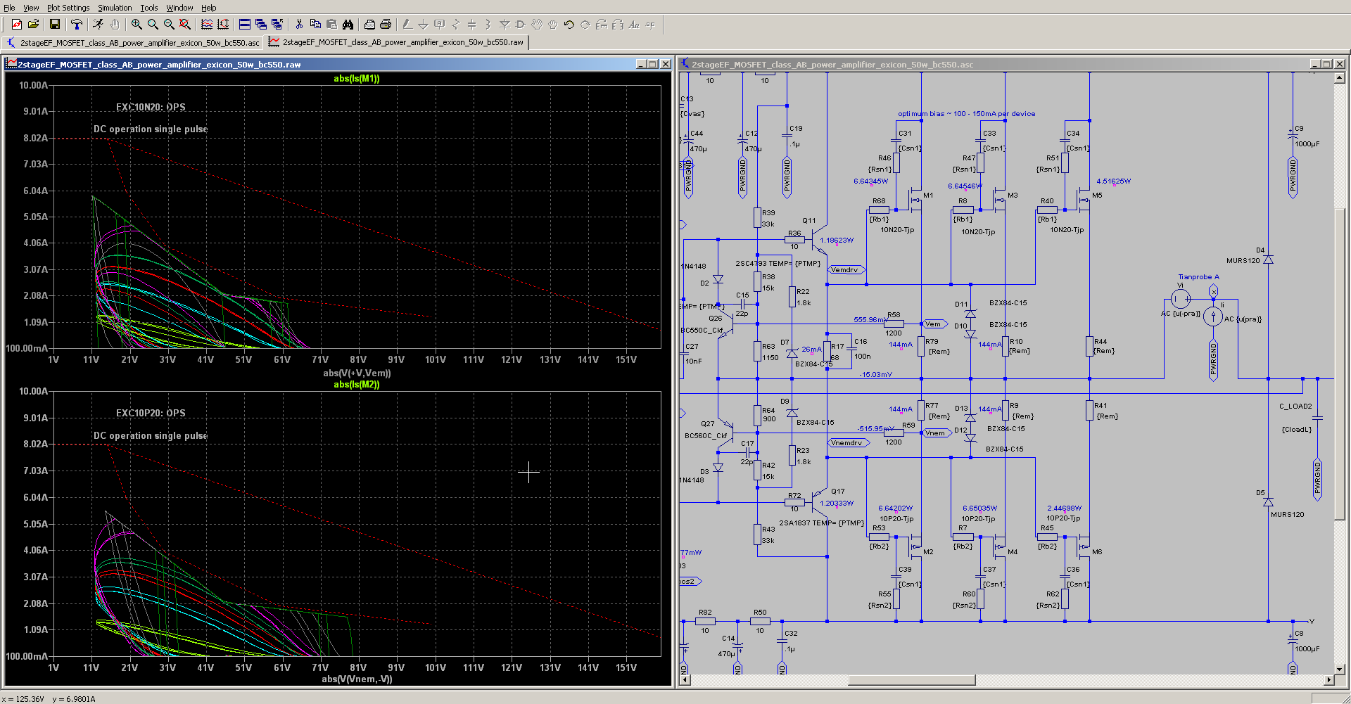

... just developed a simple plot file generator (perl based) for LTSpice to be able to faster design the current limiter ...
Attached a plot of relevant SOA lines generated from a definition file like:

In the example SOA is displayed for stepped 8 to 2R load using full power square wave and sinus wave.

loading with resistance is realtively non stressfull.
Every amplifier should easily drive half it's rated resistance, i.e. all 8ohms amplifiers should drive 4r0 dummy load.
Very robust amplifiers should be able to drive 1/3rd of rated impedance when it is a resistance. Some might do even lower.
Attaching some reactance to the load changes the stress levels.
If the load is mildly reactive (at some frequencies), then that would be a 30degree phase angle for the load.
Moderately reactive is roughly accepted as 45degree phase angle for the load. Severe reactance is generally accepted as 60degree phase angle.
These reactive load lines transgress much higher into the available SOA. Even worse if the output stage, or the drivers have an elevated Tc requiring temperature de-rated SOA
Because the reactance tends to be worse over narrow bands of the bandwidth and because the current demand of a reactive load can be much worse for short period quickly changing transients, we can use the shorter period SOA.
100ms is typically suggested as a useful indicator.
I suspect that 10ms would be more appropriate for some analysis.
That means you need DC plus 100ms plus 10ms all plotted to see if any of the reactive load lines transgress which SOA and by how far.
That is not what David Eather's paper shows.
Bensen's spreadsheet uses Eather's method and the plotted load lines go further up to the right and passed the SOA as phase angle increases from zero degrees all the way passed 60degrees.
I use that at 60degrees for all my analysis of load line vs (temperature de-rated) SOA .
