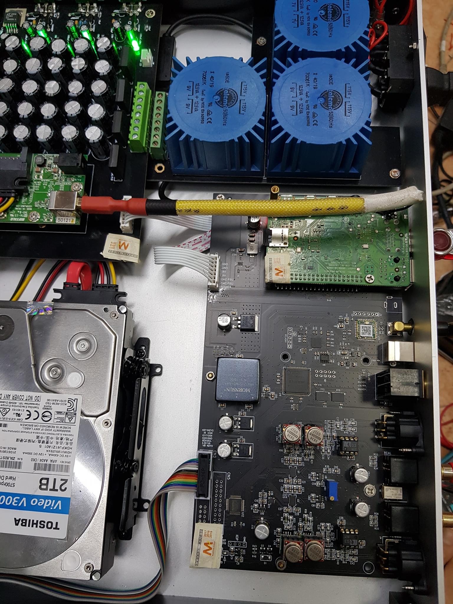

I thought I saw the board elsewhere before... looks like they all come from a same OEM factory.
