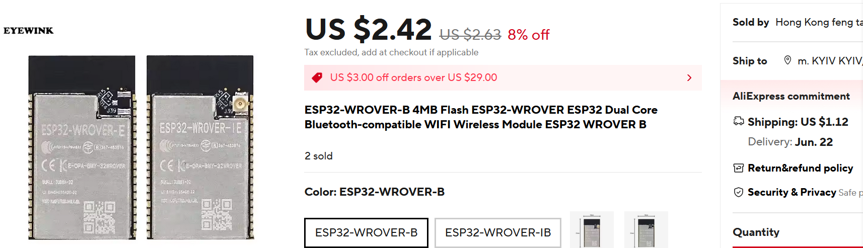

You can take ESP32 Wrover, program it with squeezelite-esp32 and get I2S output via WiFi using LMS program.
https://github.com/sle118/squeezelite-esp32?tab=readme-ov-file#spotify
