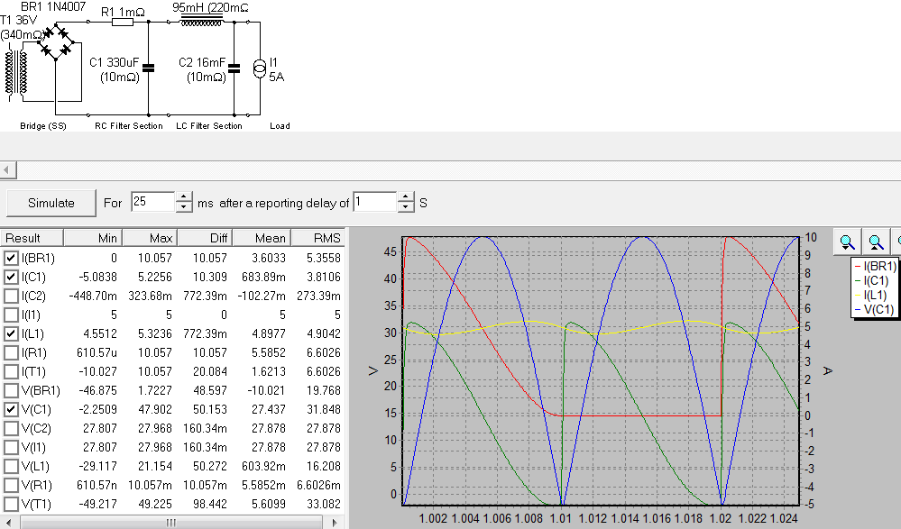

It sounds as though dissipation is a factor..high ripple and low ESR often go hand in hand with caps of 'better quality',
Regarding increasing the rating using a pair.. I had a case where I needed 330uF no more, no less. Shown below, ripple was more than 3A. I used it until I discovered this exceeded the part rating.
Would I have been able to use a pair in series, or in parallel? According to the Panasonic FC data sheet, the ripple rating is not absolutely proportional to the size of the package, nor the capacity per a given Voltage rating. Both methods would end up with less than a doubling in allowable ripple, but assuming this helps..
Which way would be preferred?

This is wrong, of course. The parallel version would be higher than double.Both methods would end up with less than a doubling in allowable ripple,
