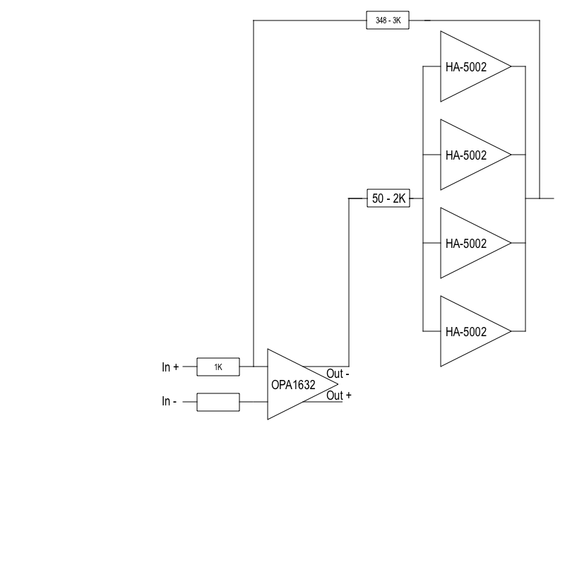

The power amp is an interesting design, I think the 9600 chips are probably better than the older 5002's I used in my amp although the 5002 amp sounds pretty darn good. It needs some tweaks but I've been listening to it for over a year everyday at my computer with no fatigue. I'm running Dynaudio x12's which aren't the most efficient speakers either but I do run a powered sub which helps.
I'm going to build an LM1875 amp to compare it to the 5002 just to see the difference. As much as I like tubes I don't like them as power amps, I'm not a big transformer fan and I think the chip buffers make better interstage (transconductance) devices. You get all the sound from the tube in the line amp in my view. Again, to each his own.
I like these high slew rate chips, I think there is something to that, the LM1875 and 3886 aren't especially hi slew rate and that's why I want the comparison.
