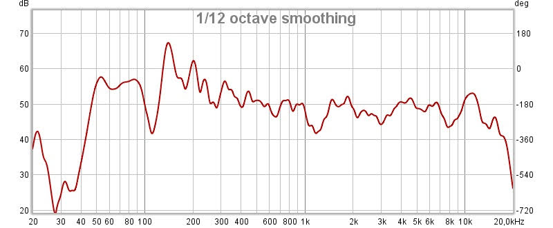

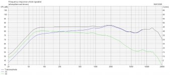

Just spinning around an idea about a new build and happened on the Dayton DA115 4" driver.

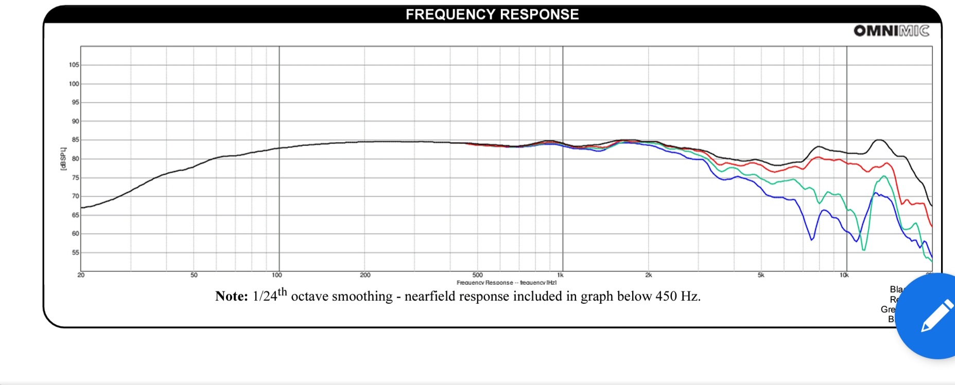

Original plan was to use it only as a woofer but looking at the FR graph it seems to play almost full range pretty smoothly. Seems like all it would need is little correction in the upper range.
Is it a bad idea to use DSP to correct the upper range and use it as a full range? So far I've only used DSP for lower end corrections where it works nicely. Of course passive crossover could manage as well as the corrections are not overly complicated.

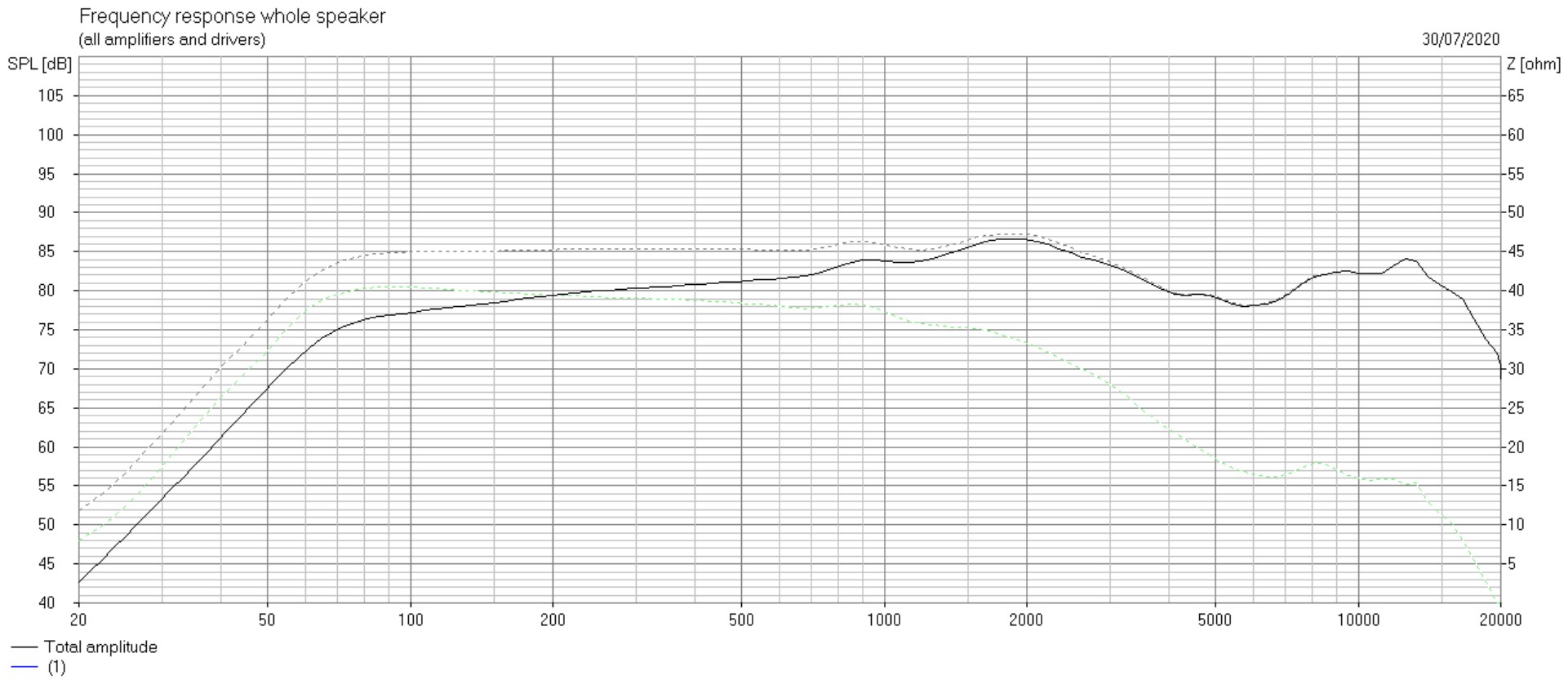

My plan is now in motion - just ordered the Zoudio 4ch DSP / Amp for this. I'm going to do this the same way as with my main speakers - room for modifications.

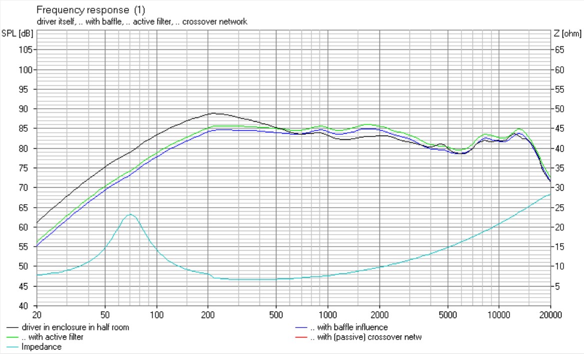

I'll start with a sealed box - 6 liters with dimensions of around 45x20x14cm. These will be placed against the wall so room gain will be significant but I'll keep an option to change these to vented, the volume is pretty good for reflex as well.
The upper range is a question mark - if it's bad I'll add a tweeter in a small separate enclosure on top, the Zoudio luckily has 4 amp channels so there's room to grow.
Attached Boxsim plot in the sealed 6l enclosure.

If this driver is qualified as woofer because the diaphragm is rigid , it breaks up only at high frequencies. The midrange sound hence the speech goes to background.
I thought so as well, just curious why this doesn't show in the frequency responses measured? There's a midrange dip and a high range wide peak but those are quite small.
Anyway, I'll measure it myself and have a listen to determine if it works fullrange or not. That's why the backup solution is to cross it over with a tweeter - Tymphany BC25SC06-04 is my current option.

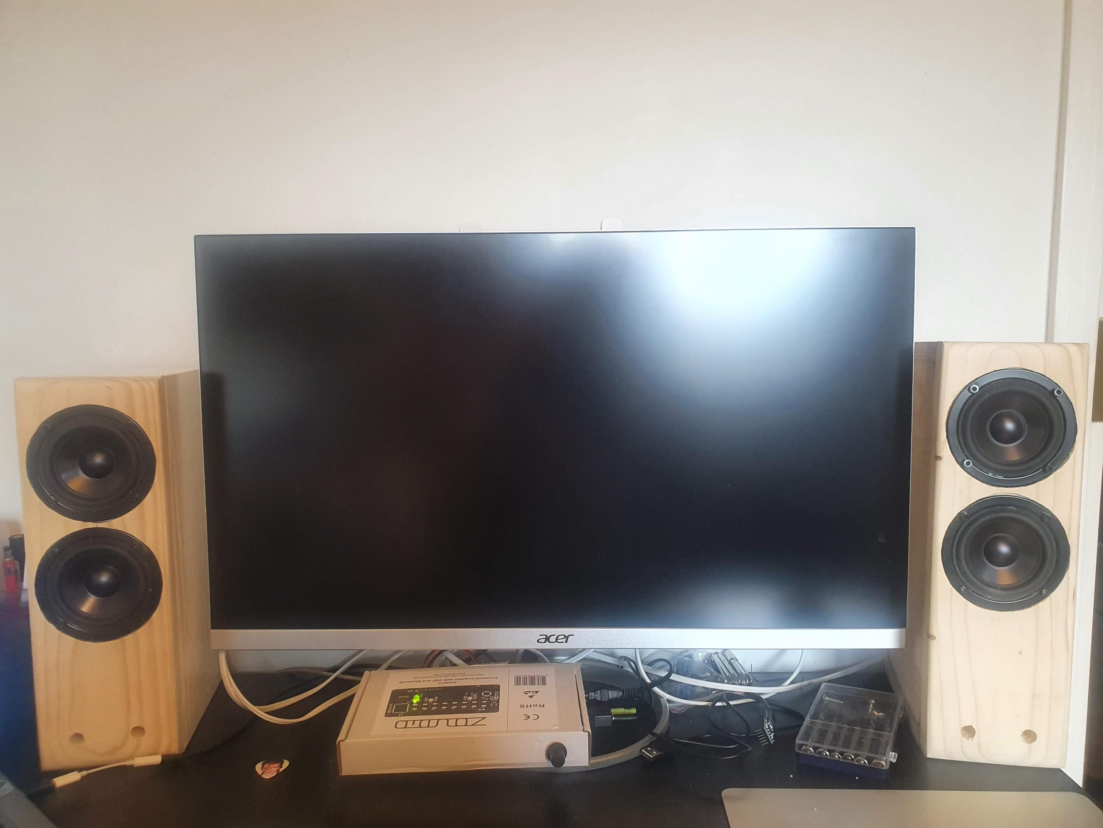

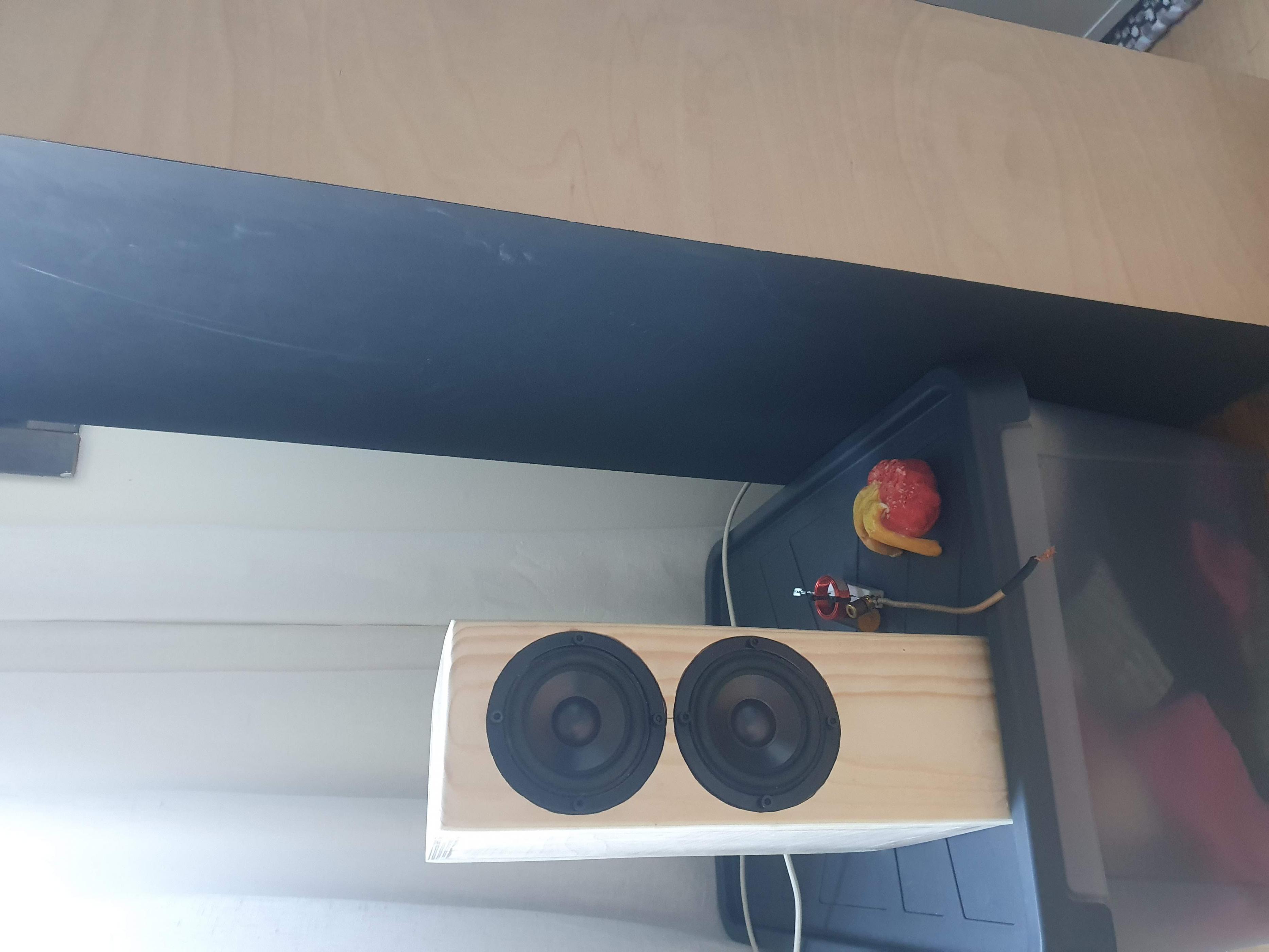

I have run to an issue that I can't fit wide enough baffle to my desk so the DA115 won't fit.
Moved over to the DSA90 as it's 3" so fits nicely to a 11cm baffle - now wondering should I put two of them in a parallel setup? This could reach a bit lower in bass as the 3" is quite limited in Xmax - only 2.5mm
I can cut off the other driver from higher frequencies to prevent comb filtering as I have 4 amps with DSP.

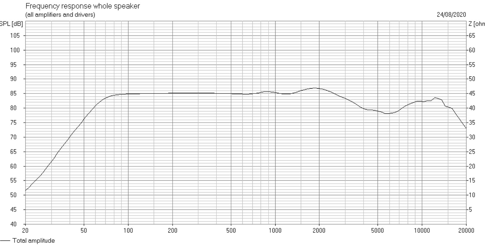

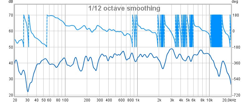

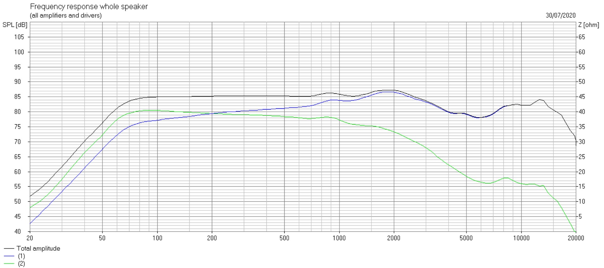

So - first piece built from leftover scraps. Although these have a tendency to stay like this if they sound good, don't want to strip a good sounding speaker no matter how ugly. :)

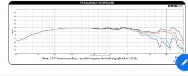

Measurements repeat as simulated - first one is near field 1m (ignore the lowend)
*Green with both drivers without any crossover
*Red with 0.22mH coil for second driver
Second one is Boxsim simulated response, quite surprised how close my build came.
Surprised that there is no comb filtering showing in the green response as both are driving full range? The lowpass coil was planned for preventing that but it seems unnecessary?
I will EQ the response after getting both built and measured at the listening position, curious to see how they play together. Listening test was really positive even with only 1 unit, sounds really nice, can't wait to finish second piece.

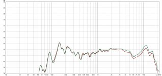

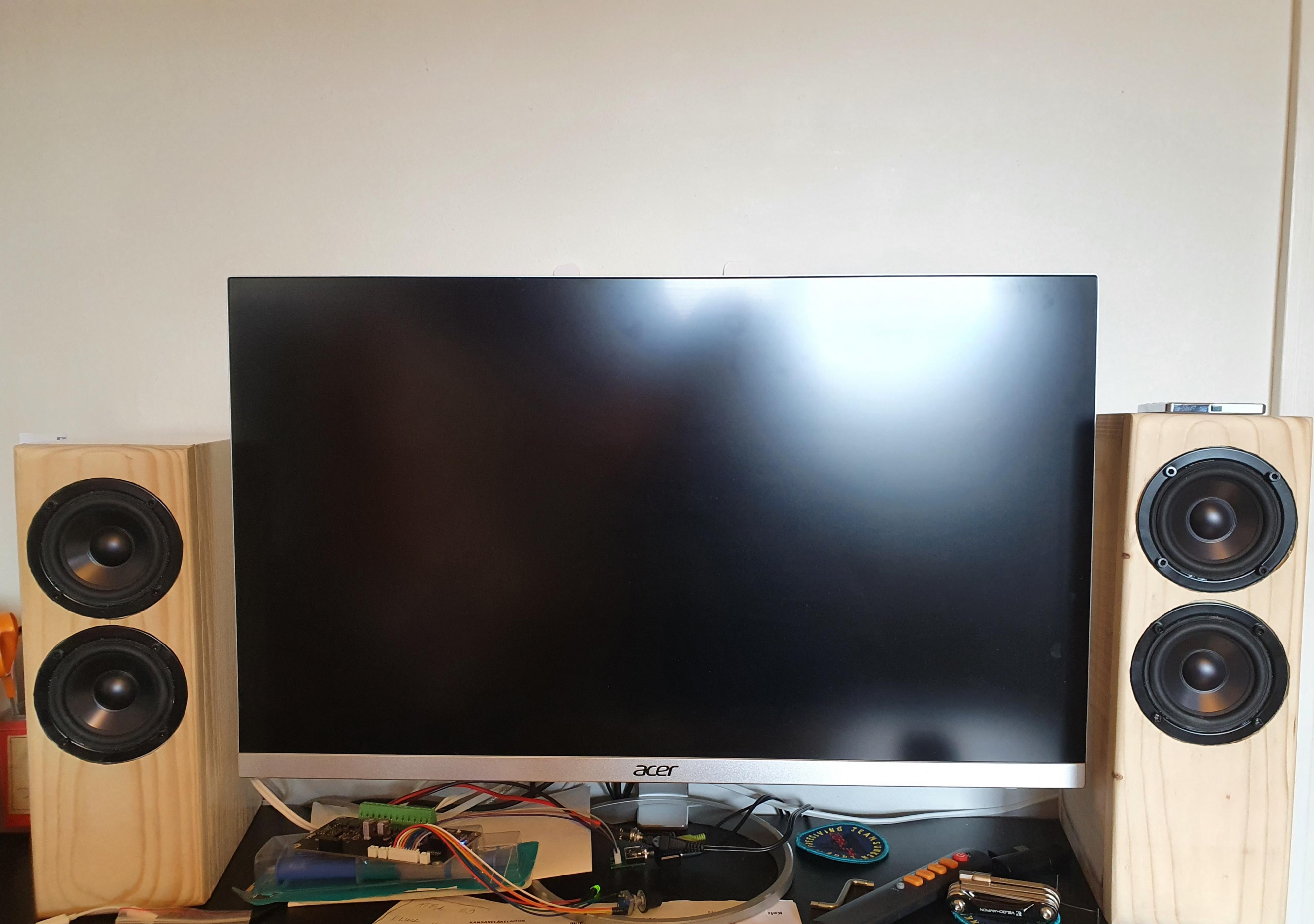

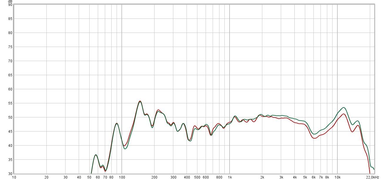

So - now much closer to final and getting there slowly but surely. Managed to wire the lower drivers in opposite phase despite being absolutely sure about it.
Response now measured together at 1m - tuning around 67hz with two ports. Bottom drivers low passed at 800hz and small peak fixed between 5-8kHz with EQ.
Still work to do with EQ, need to tone down the bass and fix those room modes but really impressed with what you can achieve with 3" drivers. :D
