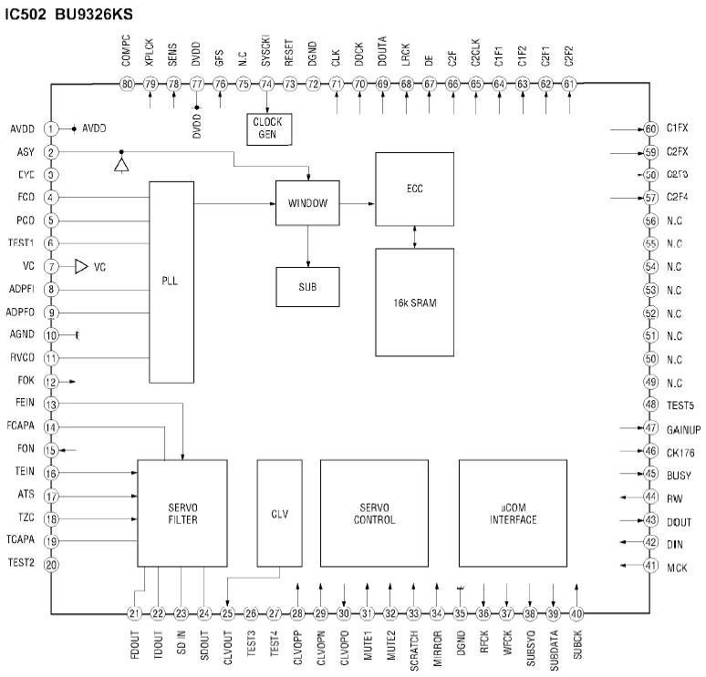

Hi Anton,
You are right about the BA6386 being only the servo controller. I meant the BU 9326. It's description says servo/digital signal processor. The only other chip on the board that could apply is the MC6BHC05L15 (what a code name) which is, IMO, a more general controller of the Discman performing functions like mute/resume/battery-status and driving the LCD display.
So does the BU9326 have a SPDIF out?
I do not have the datasheet myself but the pic is a snapshot from the Discman service manual.
Anton,
I'll send you the SM later this day to your personal email; I am afraid pin 43 is indeed the output to the interface controller. I'll check on the PCB whether the BU9326 has any other description that can lead us to the complete datasheet.
DocL
I just had a look at the datasheet for the very similar BU9321B, and unfortunately it is just as I thought, (43) DOUT is the serial data line for the microcontroller interface. So if you want to make the transport compatible with other consumer gear, you're going to have to use a SPDIF transmitter, such as a CS8406.
