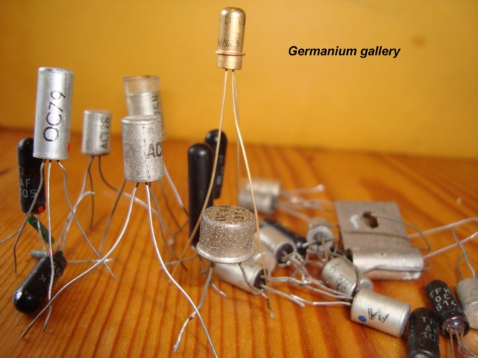

A bit of heritage is quite in order. The Radiotron hd bk has (as expected) as massive chapter related to vibrator psu's. As Tubelab mentioned the gerrm transistor, I am fortunate to have some popular ones in my pit. For amusement value only, the one in the centre photo which looks gold plated is one of the earliest produced in the 1950's.
The RF ones OC44 etc had a bandwidth which fell short of the SW band and the others mainly audio OC71 AC128 etc were hard pushed at 15Khz if that.
Of no commercial value, except the lovely low Vbe drop of only 0.2V all germaniums were photo sensitive hence the black paint. Others canned.

richwalters said:... all germaniums were photo sensitive hence the black paint.
Actually, all semiconductors are photo-sensitive. We had a fascinating demonstration of this recently at work. We needed an inverter to produce 5kV at negligible current, so we made a little oscillator with a transformer to step it up to 500V, then added a voltage multiplier to get the 5kV. But it didn't work when a bright light was shone on the EHT diodes in the voltage multiplier. It turned out that what was happening was that the photo-electric effect was producing a small voltage across each of the diodes that was enough to switch off the op-amp controlling the oscillator. A strip of black insulating tape over the (glass encapsulated) silicon diodes stopped the problem.
