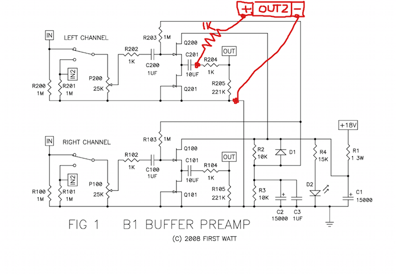

Could I use y connector cables out of the B1 to both the Aleph J and the line level inputs of a powered sub without a problem? The speakers are Klipsch rp160m's and I was considering a Klipsch sub. I'm using an Oppo bdp-95 as my disc player. My concern is that I might lose too much signal with the extra cabling out of the B1.
I would say give the y connector a try. Alternatively you might have to modify your B1 for a second output channel according to this schematic.
