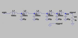

having had difficulty both with the sine voltage source of LTspice, and in finding a low distortion oscillator for prototype testing, i've designed a 1khz resonant low pass filter. in radio, the reason a class C amp can be used with the output showing no harmonic distortion, is because of resonant circuits and filters that are used to get a pure RF sine wave.
i was having problems with LTspice's oscillator, as it has distortion products only -60db down from the fundamental, which is not low enough for my purposes. i also plan on using my sound card as a signal source for testing, but also need a low distortion source for distortion testing of prototypes. since distortion tests are usually only done at a handful of fixed frequencies (similar to the radio world where devices are usually used at fixed frequencies), it's more cost effective to filter the oscillator output, than it is to buy an expensive oscillator (and hope it's still in calibration).
the filter consists of 5 series resonant sections made with 100mH inductors and capacitors selected according to frequency. the capacitors have odd values, but are more easily "built up" from smaller capacitors than would be the case with inductors.
since i generally use only 3 different frequencies, i only need to find 3 different capacitor values. i have simmed the 1khz filter, and even created a symbol for it, so i can use it in amp design tests as a 3 terminal device. it has a 5 pole chebyshev response, and a -100db/octave slope above cutoff. real world components probably won't perform the same, but will still be quite useful.
btw, you need to use resistive loading with the sim filters, unless you like starting at 1mv output and having your voltage climb to thousands of volts within a simulated second (it makes a great demo of how resonance works, though)
i found 250 ohms in series with the input, and a 1k load at the output to work ok, but you may want to measure a real world 100mH coil and use that resistance in series with each inductor in the sim version.
for 1khz, the cap value is .93uf, and after i finish this post, i'm going to finish the 100Hz and 20khz versions of this filter and report the cap values.

ok, values for 100hz are 93uf, and 20khz is 2.33nf
series resistance for 100mH is probably going to be about 200 ohms or more for each coil.
this probably can be done in the form of an active filter, but an op amp might introduce distortion in place of what has been filtered out.
