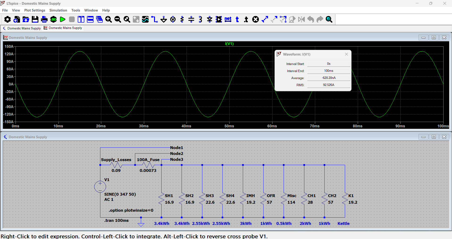

I actually have a simulation of our mains electricity supply (don't ask 🙂) that shows all the resistive heating that can be on at one time. SH are storage heaters. CH convector heaters. IMH immersion heater and OFR is oil filled radiator.
This works out at about 2.56 ohms slapped across 240 volts. Scary.
(Mains is nominally 230 but measures as high as 245 at light loads)

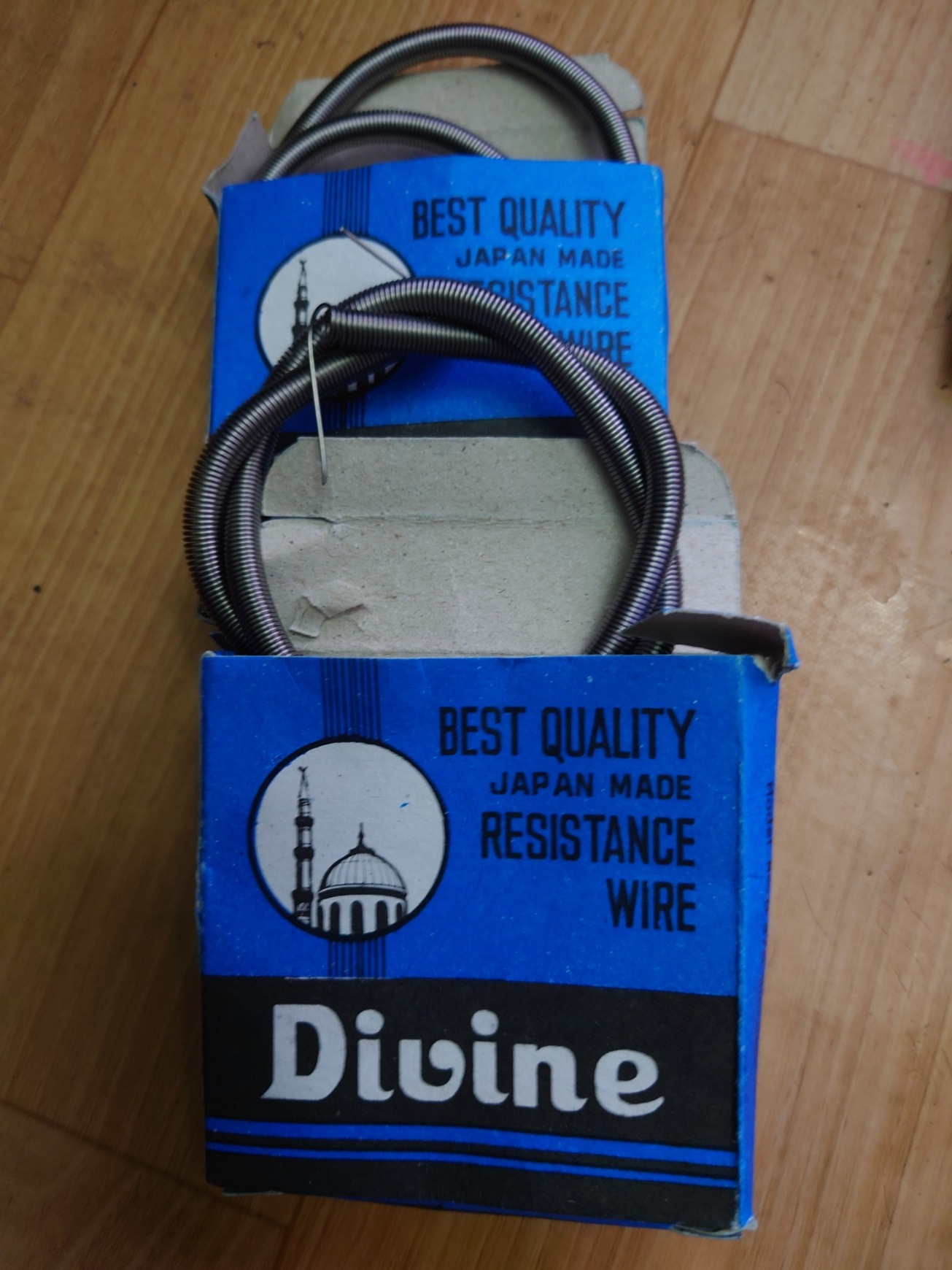

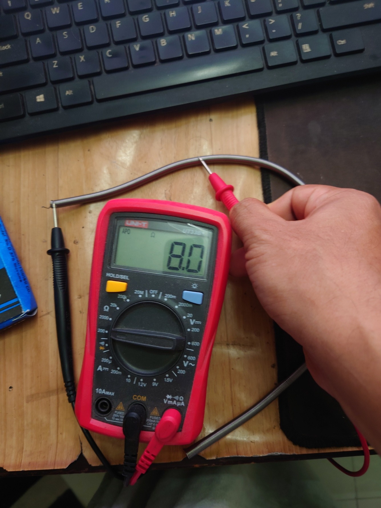

I remember we did the same 25 years ago with my friend to use it his repair shop. Purchased a few meters of resist wire from electric hardware store, hang it between two posts and fire up the amp. Then when the power goes up wire started to shine red and the wire grew longer softer and then touched the table surface and burned it 🙂Yes, you can. You can also use an electrical oven or heating coil. Less than a Doller, I bought two coils to make a dummy load!
