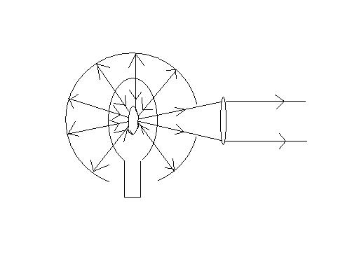

I wasn't thinking of a parabolic reflector here - instead, a spherical one.
I.e. Put the light source at the dead centre of a soccer-ball-sized sphere with internally reflecting surfaces.
Make a hole in the sphere big enough to allow a wide enough beam of light out and colimate that beam with a lens.
Basically, it is an elliptical reflector with a very round ellipse.
Attached is a sadly poor attempt to draw this... 🙁
Bill.

woneill,
sorry, must have slept, you said spherical reflector.
With a spherical reflector and lightsource at the center of the sphere, which is 2xFL, you only have to create reflecting surface on that area, which is surrounded by a lines drawn from the lens's border right through the lightsource to spheric curvature.
Spherical reflectors reflect light directly back to the lightsource and create a 1:1 image of it which means double brightness.
The rest of the sphere doesn't contribute to light emission into lens's direction!
And what's about cooling?

Hi Xblocker,
I have no actual scientific basis for proposing this arrangement, except that if only a small portion the sphere is present, then a lot of light gets lost, and if the objective is to have an external light module feeding a cannibalised projector, then we don't want to light up the room.
If nothing else, the light reflected back into the emission centre of the bulb might be re-absorbed by the charged gasses, and contribute to new emissions in a more appropriate direction. (Like I say, I have no actual scientific basis for this arrangement except that it will definitely limit stray light floating around.)
Cooling would be easy - stick a fan/blower under the base of the bulb with appropriate ducting so that air goes into the sphere from below, and out through the light exit aperture... 😉

If my guess is right, this should work to prevent light loss and it would be easy to implement. But, a spherical reflector that is just right for the bulb should be more efficient. Correct?
Yes!
The sphere should be smaller and it's enough to have a half sphere! So, if you draw the said lines, the angle of captured light will increase!!

As Xblocker says, a sperical reflector wastes much light and the light bulb has double heat focused right inside bulb where fan cannot extract heat. Likely chance bulb overheats.
Cut your spherical reflector in half. Place light bulb at 1/2 radius then you getting parallel rays.
Better solution for parallel rays is traditional parabolic reflector. Unfortunately bulbs used by DIY people have larger light emmiting area than manufactured projectors with point source expensive light source so we have to make do with improvised bulb/ reflector combination to achieve best results with materials used.

OK. So if the main point of light is at half the radius of the sphere, you'll get the desired effect and have parallel light waves?
No need for additional lenses in between that and the panel then?

If you are using this arrangement to drive a panel, then you will need to bend the parallel rays into a cone so that they hit the main objective lens, using a lens (probably a fresnel) either in front of, or behind the LCD. See main discussion thread.
The idea of using parallel rays here was to drive a projector which is assumed to be expecting parallel rays from its original light module.
