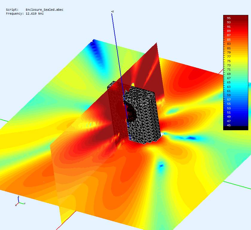

A screenshot of a compact sealed is shown below. I want to compare ABEC results to LEAP 5 in particular for diffraction effects.
