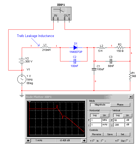

Well, I have the choke tuned to 120Hz by way of a capacitor across the leads... so I *guess* that functions like the .68u cap you suggested since in my arrangement it goes from diode bridge-to-ground across the choke, and I have bleeder resistors across the capacitors too, which should help. I think I'll bypass each diode in the bridge with a .1u cap just to be safe too.

this is what a high voltage 1n4007 diode circuit really looks like -- 210mH is the leakage inductance of an 800V Thordarson trafo I happen to have lying around -- so the leakage inductance, diode junction capacitance and all the stuff are modeled here.
when you put 100nF across the diode you bring the resonant frequency of the circuit down -- add enough bypass capacitance and you can hear it!

Also, I accept that a small cap before an LC filter will tend to snub choke switch-off peaks, but it is always better to address the source of an interference without going through other circuit parts, especially in the case of high voltage peaks. In that respect I personally would prefer to mount an RC directly across the choke.

PS I placed bleeder cap directly across the choke. I have measured no voltage spikes.
