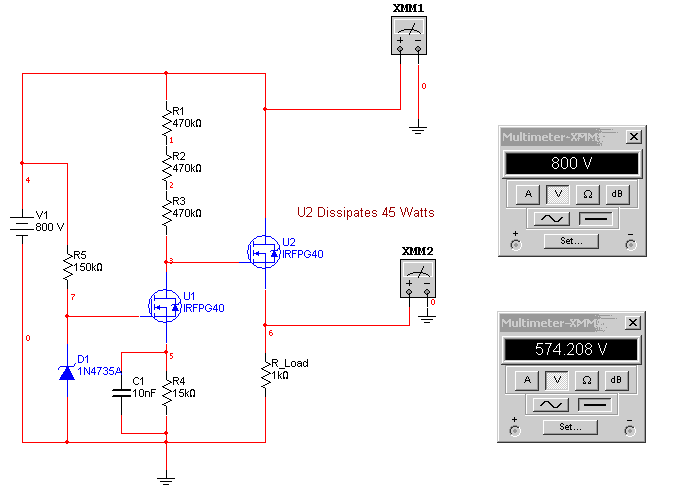

It does dissipate a lot of heat, a auto-transformer would be a better idea -- but this is how it is done:

That's good to know... but... it will vary with load... Jackinnj provided an all mosfet diagram of what I verbally described... but then there's all that power loss... and heat sinking and isolation from ground cautions...
