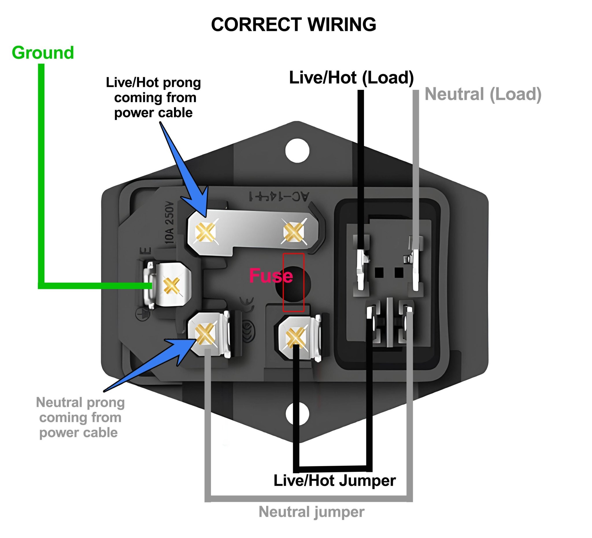

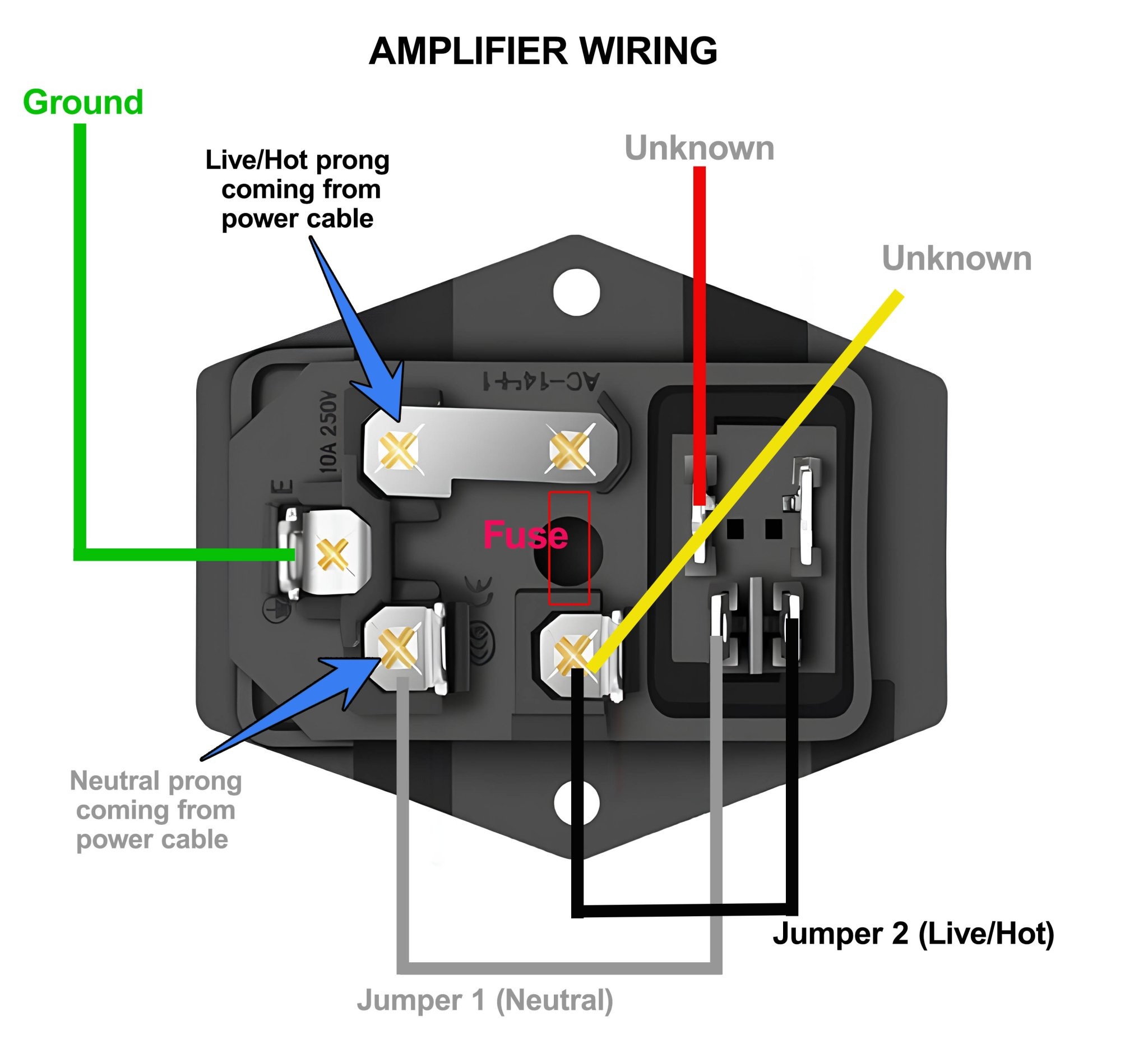

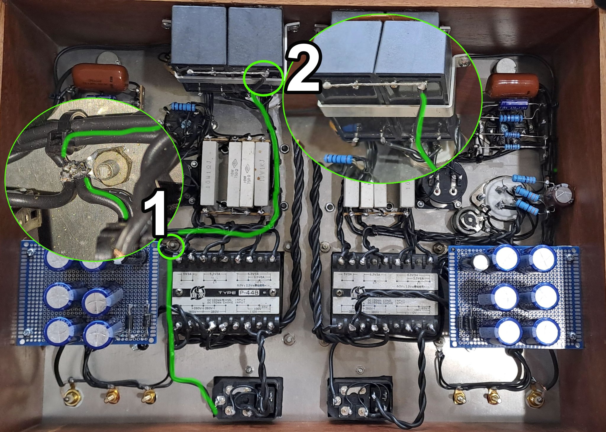

Zooming in on the photos above it looks like the PE connection to the chassis is done with with a fork lug, not a ring lug. I'd suggest to change that to prevent the lug from falling off. Also, a spring washer may be a good idea to prevent the screw from coming loose.

Even very expensive tube devices sometimes have 3 prong IEC inlets with PE not connected and Audio GND connected to chassis. Then there are also owners that don’t have the time/money/motivation to have PE wall sockets in their home to connect their 5000 Euro device with PE equipped IEC inlet to. Safety is not on the priority list.
