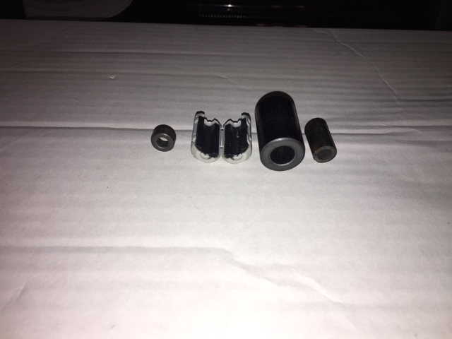

Do you´ve a photo to share. I´m finishing 211 Melomania Monobloc using two 866A (or 3B25).
JP
Here is a variety that I have on hand. The larger one can take a couple loops if you desire. I've never actually checked for the reduction RF hash but I've had no issues. I've have a couple of amateur radio pieces that use them. Back then there were no ferrite chokes but the power supplies were enclosed in a cage.
As far as matching, I take several known good MV's and keep switching them until I get a set that "glow alike" under load. Just for looks mind you
One more thing. In addition to the HV delay I put a manual HV standby switch to acclimate new or recently disturbed tubes which has been stated here I think. Choke input PS is your friend.

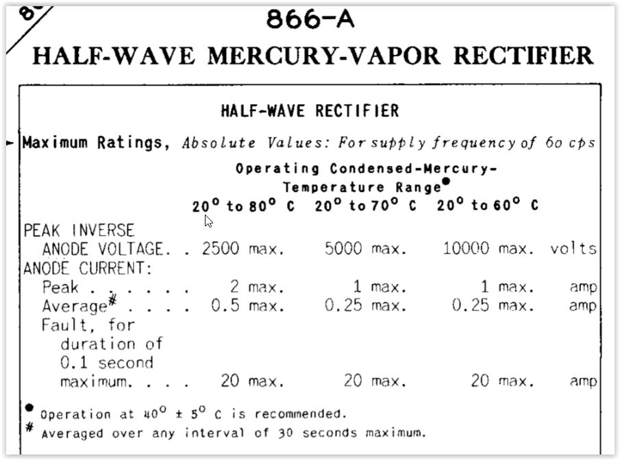

Well...it is advisable...but not a must always...depends on the tube...PSUDII is your friend...and old data sheets like this one: http://www.r-type.org/pdfs/866a.pdf
The use of a tube, for a particular project, should use the manufacturers data sheet for guidance. No two projects are usually identical, but similar.
If you are going to use a tube well below the max rating, then you could probably (broad statement) go a little higher in other areas without causing damage to a tube.

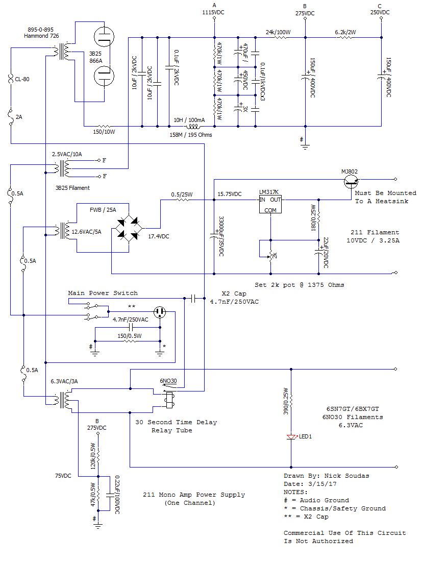

For example, in my 211 SE mono amps, I am using a CLC (20uF/10H/150uF) filter with 866A's. However, I am only drawing 100mA from the power supply with a final B+ of about 1100VDC. This use is well below the max ratings of the 866A tube and I have never had any issues in almost 17 years. 20uF is not that much capacitance (to overload an 866A), but it is enough to reduce ripple (in the first stage) for a nice CLC type power supply without having to revert to a higher plate voltage transformer.

What I found from those articles/ datasheets so far:
- It is important if you use FW and a 2.5V/10A winding to feed two 886A, that the socket pins are in parallel connected to the x-former. Internally the 866a is assymetrical, so it matters that both left pins are connected to the same x-former secondary connection.
- If RF is present -to be checked with a small radio - than a 1mF choke in front of each anode is recommended (Rca data sheet 82)
- and/or a 1nf to 10nf cap from secondary to CT (two times)

So i'm working two 866 with C input (10uF) L (20H) C (47uF) ... 450-0-450v for 420V and 130mA output. Following the dasheet an suitable R on the plates has been necessary.
