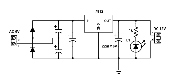

7.01 V DC is too low for a 7806. It needs its input voltage to be at least 2V above output voltage so 8V.

That relay uses 33 mA a piece so 100 mA in total for 3 of them in parallel. We round it to 150 mA worst case. That is a very light load. But... your filter cap is way too small even for this light load. Please use a 2200 µF 16V cap before the regulator. I think you can get away with it when having such a light load. The output capacitor is OK with 100 µF.

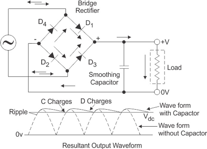

Have a look at what that filter capacitor does or should do and try to imagine what happens when the cap is chosen too small. It helps to see worst case i.e. "wave form without capacitor":

Hi, your way of dealing with this stuff is incoherent. So the load is 150 mA for 3 relays and 4 LEDS of each 20 mA. I don't believe this as normal modern green/red/amber LEDs need 2.5 mA to glow otherwise one goes blind when looking at them. That makes a maximum of 160 mA and this will be lower in real life. You don't need to double anything except that you need a large filter cap to minimize ripple voltage either with 6V or with the voltage doubler (which makes its necessity exactly 0).
Just buy that 2200 µF cap and be done with it. It will work OK. Also use the 1N5817 Schottky diodes. If you only have 470 µF well then use a few in parallel. You need to get ripple voltage down in any case.

You really have all the necessary stuff except a 1.60 Euro electrolytic cap...... The voltage doubler also needs larger caps than you have and then the reg needs to dissipate power to useless heat without any reason. You will then still use 7806 as you have 6V relays....A 7806 dissipating 1W then while feeding a few LEDs and relays.

For the twin caps, I usually use 1000uF. The third cap isn't necessary for the relays and can be omitted (like the picture of the "Little Delon, vs the picture in the first post of that same thread).
The 7812 can be replaced with 7806 for 6V output (obviously).

I tried the voltage doubler with 2x100µF twin caps, 470 µF at input and output of a 12V regulator. I get 11.77 v output with or without the 3 relays engaged.

Edit : not at all, i get 10 v with 3 relays engaged...
Everything is working so far with 10V on the 12V relays and a 12V regulator?!? I am glad I can't follow the logic. What you created with the fully redundant doubler is a higher voltage with still too much ripple voltage as the caps are still too small 😉 Instead of being closer to a solution you are further away from it as the regulator does not regulate anymore.
Is it so hard to understand simple electronics? After rectifying a pulsating DC voltage is available that must be smoothened with a filter cap. The filter cap value determines the ripple voltage. Or is this the in this section famous "just doing something" doctrine?
