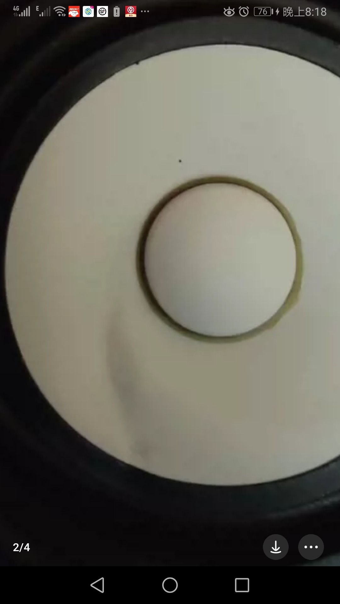

Sorry, this is the driver: https://www.iwistao.com/products/hi...for-monitor-speakers-tube-amplifier-diy-audio
- Full Range
- Using 2 identical full-range drivers per speaker
