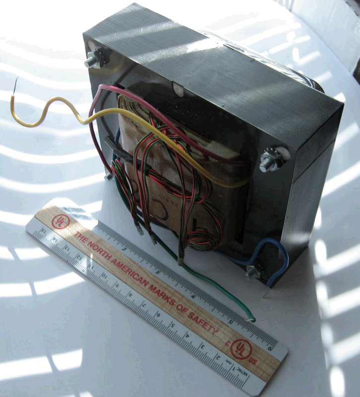

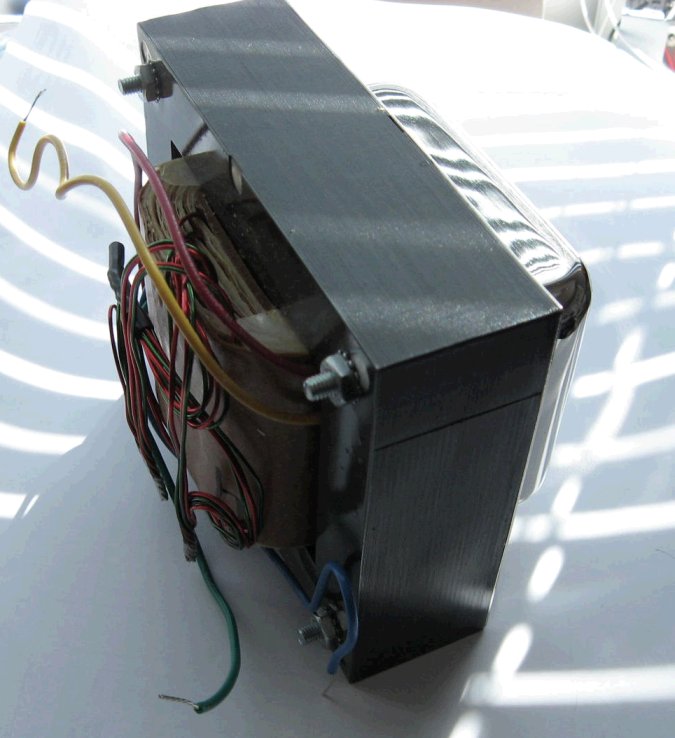

The Quicksilvers shipped today - delivery is scheduled for tomorrow, as the Quicksilver guy is just up in Stockton. The package weight is 21 lb, so I have some expectations as to quality. It'll be interesting to see how these compare to the 3k Transcendar "jumbo" transformers I have. I also have some fairly wimpy "would be James" transformers I got through E-pay from Taiwan. I should probably throw them into the comparison as well, as I haven't given them any bench testing. Lord knows what's actually inside them.
The monsters arrived today, here's a picture of one next to a 6 inch (no apologies to you Euro types - work it out) ruler.

Hello Wrenchone and All,
Now that your new transformers are safe at their new home let me toss out a question.
I recall reading some Lundahl literature that said that Single End output transformers are gaped for an optimum idle current and any increase or decrease from the optimum idle current will degrade the output quality. Something like there is a center best level, most linier, level of flux. Higher current is closer to saturation. A lower level of flux looses linearity the other direction.
Your transformers are 120 ma what happens to the output quality if they are biased at say 90 or 150 ma?

They are gapped for a maximum peak current, when all is said and done. If you run your bias too hot, you'll saturate early on the positive output peak. If you run your bias too low, you'll run out of excursion early on the negative output peak. Best operation would be biasing for symmetric clipping for a given set of conditions, which is a juggle between tube characteristics, B+, and transformer maximum current.
As far as I can tell. the current ratings on SE transformers refer to the max amount of DC bias level, with the expectation that one will hit 2X that level on max positive peaks, and run the current down to zero at the negative peaks, In any situation, this is the max that you can wring out of a given SE design. How liberally this is specified will depend on the transformer designer. Some will design their transformers to leave some room at the top end, and others will design so that the positive peak is at the ragged edge of saturation.
With an SE design, what goes up must come down, so that the negative swing can be no higher/lower than the DC bias level - that's it...

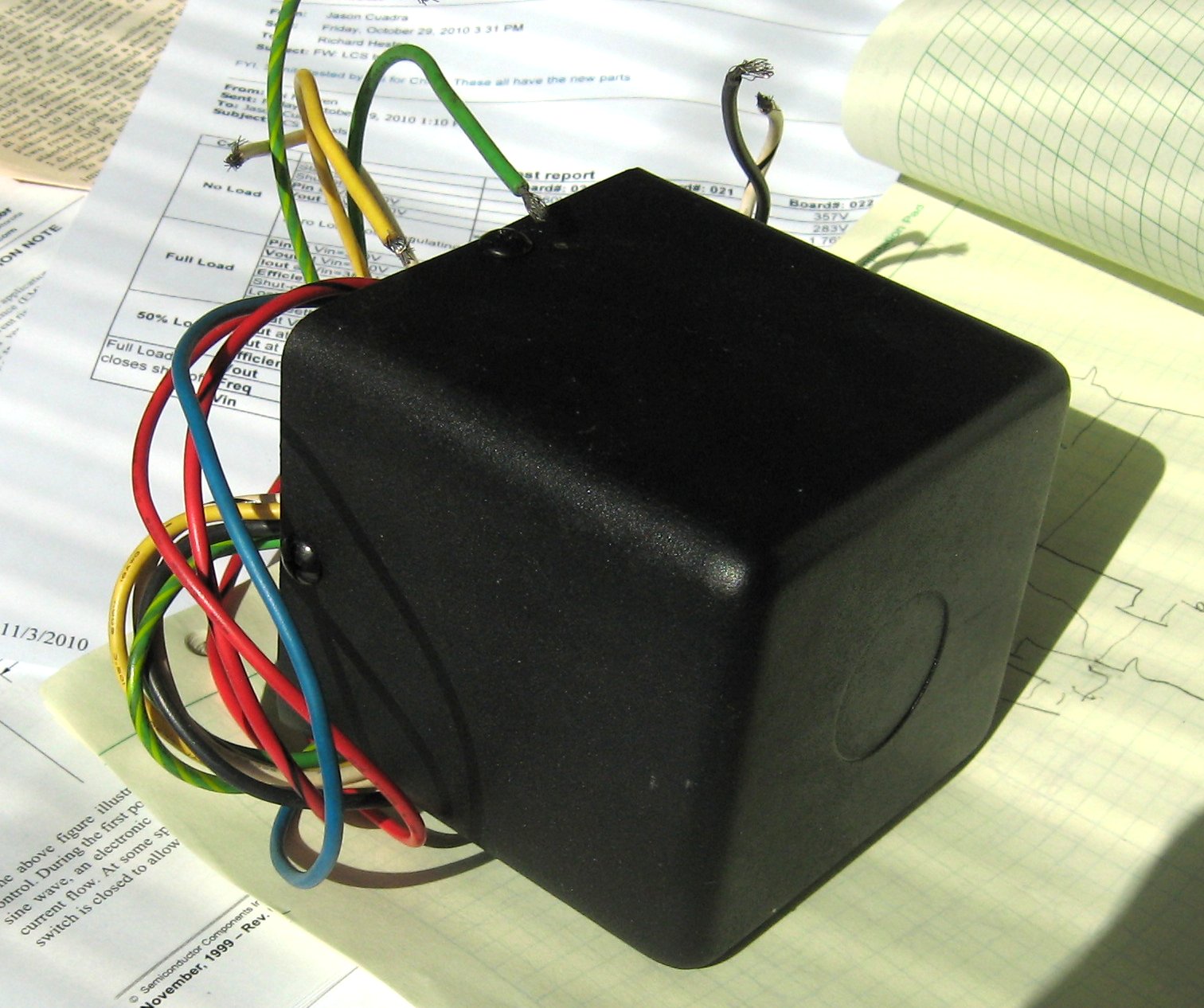

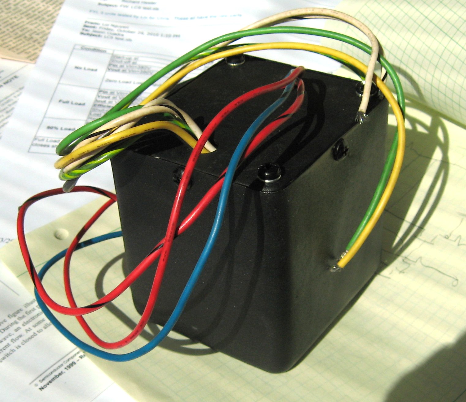

Here's a pic of one of a pair of "Would Be James" transformers, bought from an E-pay seller in Taiwan. It weighs in at 5.4 pounds (that includes the fancy case and potting), so I would suspect that it's capable of 10W or less, unless some cheating was done on primary inductance/current capability (likely). It looks nice, anyway. Measurements will follow.

These transformers look to be from a lot of screw-ups. The calculated impedance for the 8 ohm tap is 2500 ohms, but 2800 ohms for the 4 ohm and 16 ohm taps. There's a very hot secondary tap as well whose purpose I don't immediately understand. For 50V input the 4, 8, and 16 ohm taps give me 1.89V, 2.83V, and 3.77V respectively, while the hot tap gives 18.7V - maybe this is for some sort of cathode feedback.The no-load excitation current was 0.43 mA for 50V, 300 Hz excitation. This calculates out as 62H primary inductance. This value is suspiciously high for such a small and low impedance transformer, which means that the primary resistance will be real high (lotsa turns), and/or the primary current capability will be pretty low.
The primary resistance is relatively low (70 ohms) so I doubt these will be good for much current. It's a good thing I checked... They may work with a relatively small tube like the 6B4G/6S4S. I was thinking of pairing them perhaps with the 6S41S, but I fear that's way too ambitious. These may definitely be a candidate for the test method I was mentioning in my last post for determining their real current capability.

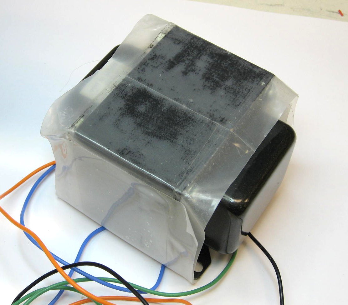

Next up, a Transcendar TT-010-OT. This transformer is one of the "baby budget" Transcendar series. Through the protective plastic film, you can see that the core stack is respectable. It weighs in at 4.1 lb, and looks like it might possibly be able to fit in the case for the "Would be James". With 50V, 300 Hz excitation at the primary, output voltage is 2.7V. This translates to an 18.5:1 turns ratio, or a 2.74k:8 ohm impedance ratio. This is fairly close to the stated 3k impedance value. Open secondary excitation current is 0.97 ma at 50V, 300 Hz excitation. This works out to a primary induxctance of 27H, which is reasonably respectable for a transformer of that size and impedance. I'll take a look at the 15W Transcendar when I find it in my pile, and may also drag in a One Electron for comparison.

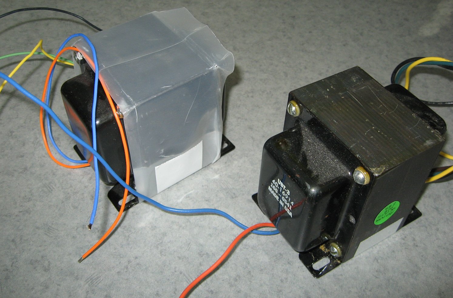

A two-for one deal here. The photo shows a One electron UBT-3 and one of the large "original series" Transcendar 3k, 15W output transformers. Both have 4 ohm and o ohm output taps, but no primary ultralinear taps.
Transcendar:
Tested with 50V, 300Hx excitation, findings were as folows - 4ohm (Blk-yel) yields 1.925V output. Turns ratio calculated as 25.97:1, impedance ratio, 2699 ohms: 4 ohms. The 8 ohm tap (Blk-Grn) yeilded 2.716V output. Calculated turns ratio is 18.4:1, impedance ratio 2711 ohms : 8 ohms. This is the first tapped secondary SE transformer I've measured where there has been reasonable impedance agreement between the two secondary taps. Open circuit excitation current was 0.78 ma, for a calculated primary inductance of 34H. Primary resistance is 263 ohms.
One Electron UBT-3 :
Teated with 50V, 300 Hz excitation, output on 4 ohm tap (Blk-Yel) is 1.97V, so calculated turns ratio is 25.38 : 1, and an impedance ratio of 2577 ohms : 4 ohms. The 8 ohm tap (Blk-Grn) output was 2.852V, for a calculated turns ratio of 19.36 :1, and a calculated impedance ratio of 2998 ohms : 8 ohms. As can be seen there is a large variance in reflected impedance between the two secondary taps. Open circuit excitation current was 0.89 ma, for a calculated primary inductance of 29.8 H. Primary resistance is 294 ohms.
George has noted the high primary resistance of the One Electron UBT-3 in the past, and its implications for efiiciency and output power. The Transcendar looks to be similarly lossy. I should go back and measure the resistance on the Quicksilver transformer as a comparison. Having said that, this is an indication that there are enough turns to support the claims for output power, maximum bias current, and primary inductance. The indictance reading on the "Would Be James" is suspiciously high as compared to its low primary resistance, an indication that it would no support as much bias current/power as the other transformers measured in this thread.

I'm wondering whether the WBJ is using a core with a higher permeability than the others? I've run across a few permalloy core transformers that are exceptionally good and very small relative to their power handling capability. Perhaps you lucked out or these are questionable as you say. The low excitation currents seem to imply that the core material might be better than average.
Those WBJ cans and potting could weigh significantly less than 1 lb..
