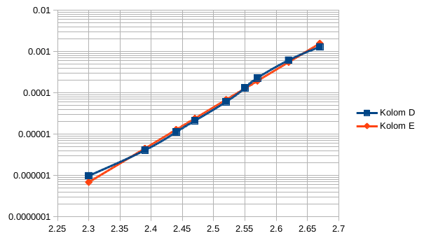

It's close to an exponential curve of 155 uA at 0.5 V, increasing by a factor of ten for every 104.5 mV extra.
It's also reasonably close to 2.4991E-11*(V + 1)^38, which doesn't mean much, of course. I don't see how to make a parabolic curve close to it.

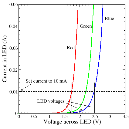

I have only used LED biasing a couple of times, and in both cases I added a resistor to "inject" additional current so the LED will be working at at least 10mA. Maybe it was not strictly necessary but I did that anyway, because all I could find were "generic" I/V curves for LEDs.
If the slope at operating point is low enough its diode'y exponential contribution to local circuit resistance can be forgiven for its other virtues; if not, not. The higher the slope, the smaller its contribution to total resistance (and so, distortion),
I looked into this for my book. It turns out there is no need for extra 'feed current'. The LED nonlinearity is always so much less than the valve internal cathode impedance nonlinearity that the LED contiributes no measurable distortion (but it does add noise if it is not bypassed with a capacitor). In fact, extra feed current increases the bias voltage slightly, which makes valve distortion worse!
