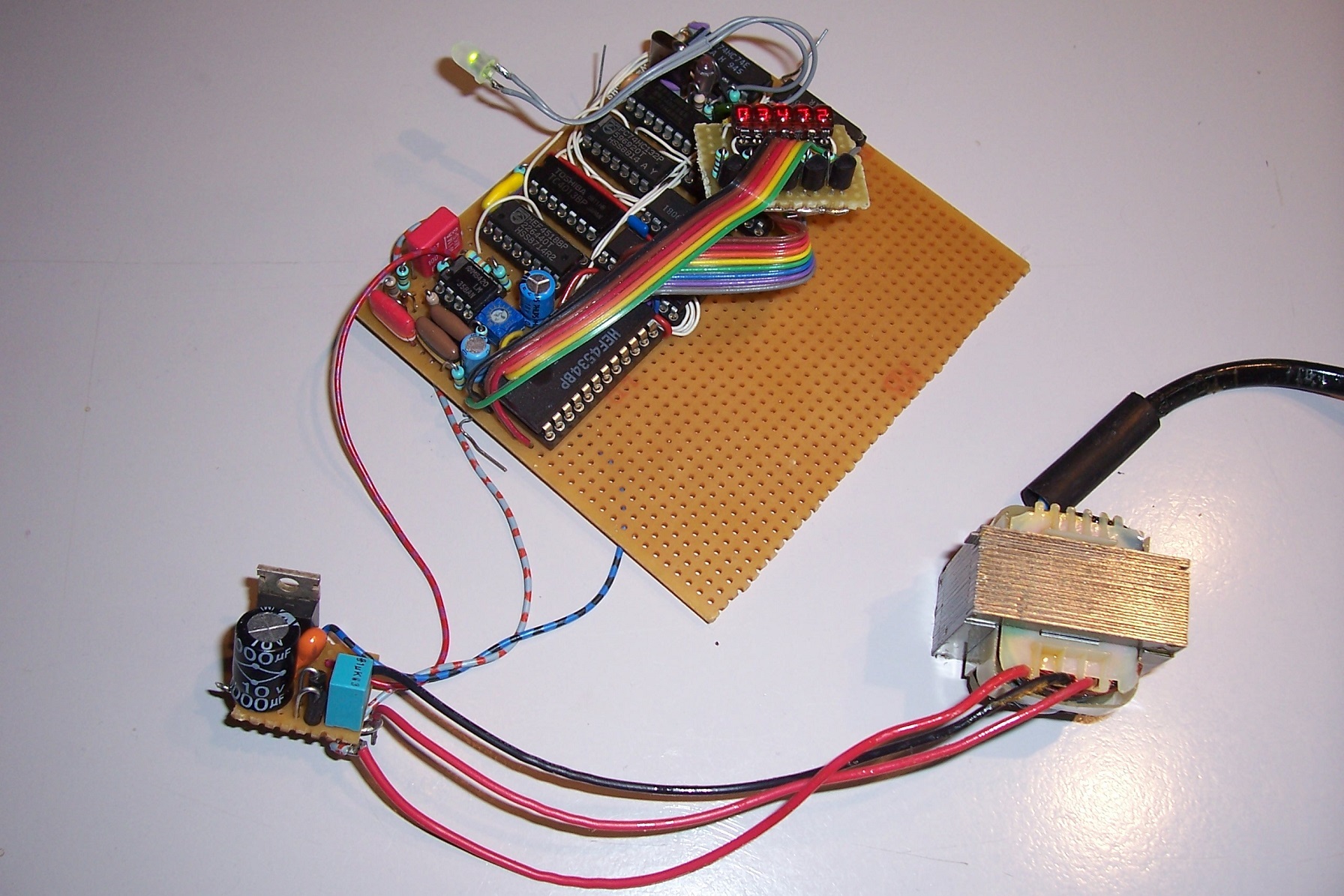

This frequency can be measured with an ordinary frequency-meter, but a dedicated instrument is preferable because the jitter caused by various polluting signals should first be eliminated, and the frequency should be averaged on a sufficient number of periods in order to extract a stable value.
It is also preferable to display just the deviation, absolute or relative rather than the actual frequency, which can be cumbersome and leads to mental gymnastics.
Here, I have chosen to display the absolute deviation in positive or negative: all the decimals above or below 50Hz.
In fact, this circuit is not actually a frequency-meter, not even a deviation frequency-meter in fact: what is actually measured is the period, which is converted to frequency, not with an inversion, but with just a mere change of sign.

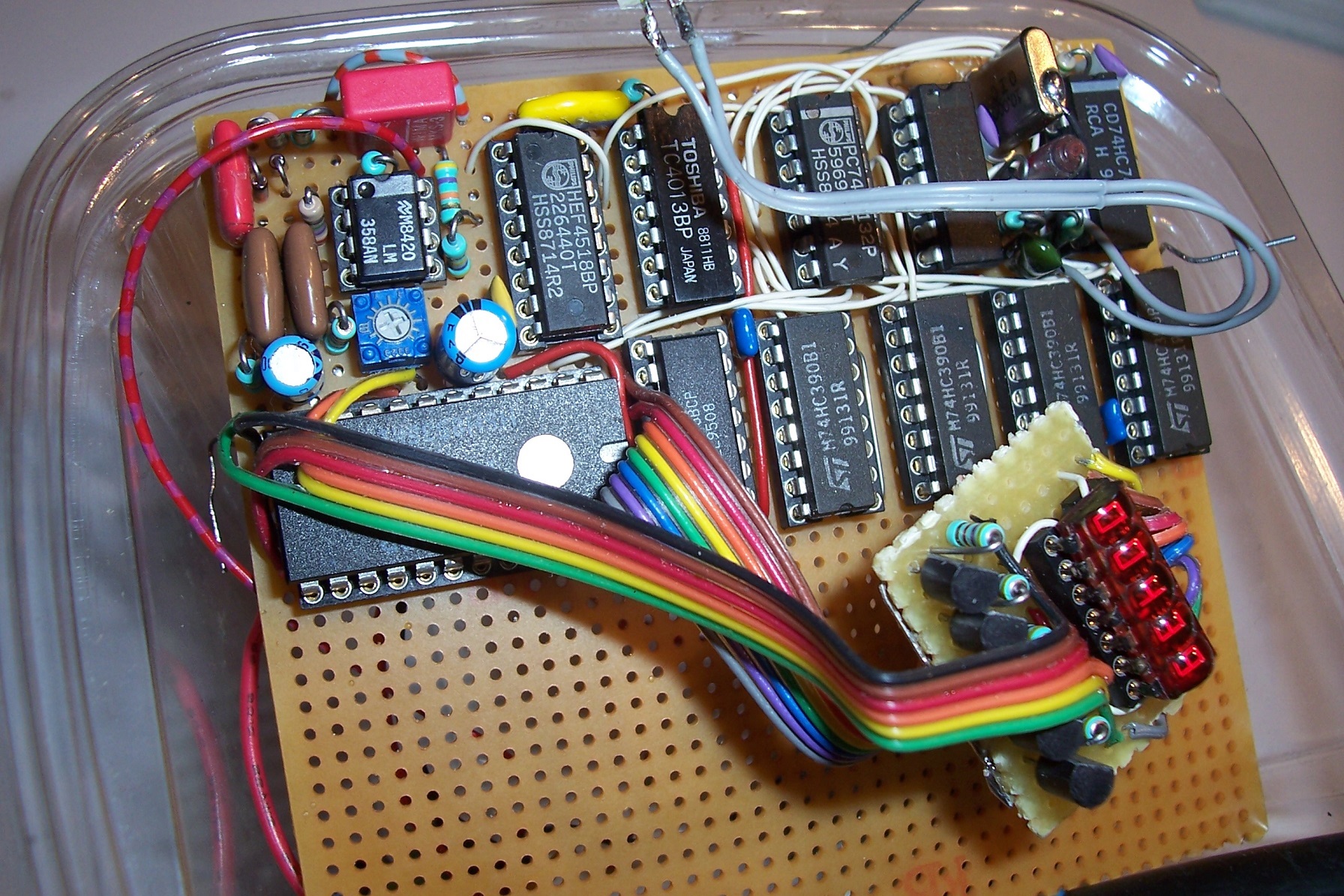

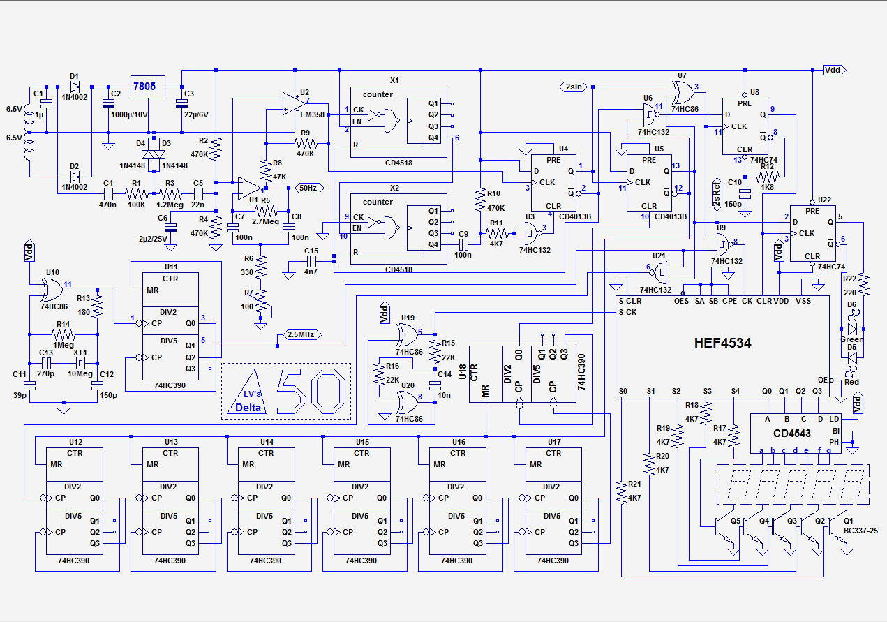

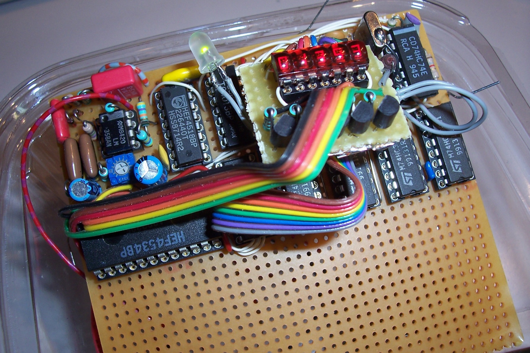

The 50Hz to be measured is first clipped and crudely filtered thanks to C4 to 6, D3, D4, R1, R3 and is applied to a high Q selective filter, U1.
The resulting signal is squared by U2 and applied to the logic.
This front-end happily accepts signals from 0.5V rms to 150V, even very polluted ones: a 60cm wire hanging from the prototype was able to collect a sufficient signal.
X1, 2 and U4 count 100 input pulses and generate a 2 second pulse.
This pulse is compared to a X-tal generated one, with a string of counters and U5 fed by a 2.5MHz reference.
This reference establishes the final resolution: 10E-5 Hz.
Initially, I had planned for a 4-digit instrument, because the range from 49.90001Hz to 50.09999Hz was sufficient, but the LSI counter and display I had in my stock were 5-digits, and it ended as a 5 digit.
The first digit will always read 0 (unless Vladimir and Donald decide to have some fun with Kim), but it doesn't matter, it is free: the HEF4534 is dirt-cheap anyway.
The two 2-second pulses are compared in U7, where the counting window is generated.
The 4534 is rather crude, and does not include latches, which means that the counters reset is made "on the fly", at the start of each counting period by U8 wired as a one-shot.

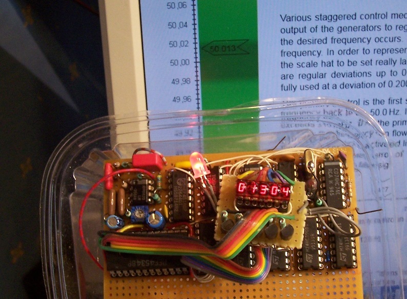

The counting is in real-time, and is not hidden, but it lasts a few ms at most, which means it appears as a barely visible flicker every 2s on the display.
U22 extracts the sign of the deviation.

It is fun and instructive though, and it can also show local, temporary swings that deviate from the global average, possibly indicating some local stress conditions.
The resolution is also finer: 10E-5Hz on 50Hz is 0.2ppm, and the update rate is quite fast at 0.5Hz.
The mix of input analog filtering + digital averaging on 100 periods provides good and reliable readings, even with this relatively fast rate.

Here, the average response time is ~1.25s, 2.5s worst case, but for much larger excursions than 10E-5Hz, the filtering and averaging could be eased by a factor 10, leading to a maximum response time of 0.25s
