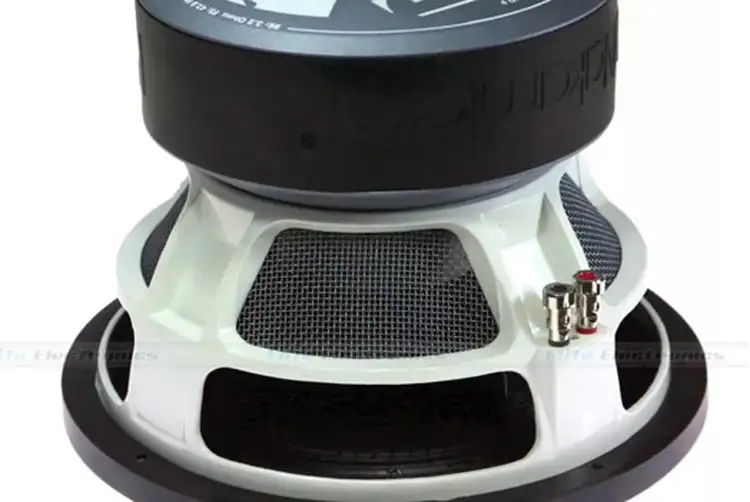

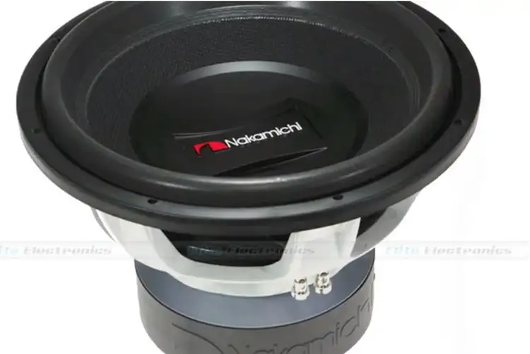

Hi I have a pair iof these old 15" Nakamichi car subwoofer drivers.
I would like thoughts on if they are useful as Subs in a HT & music system?

- Resistance: 3.2 Ohms
- Frequency Response: 32 Hz
- BL: 17.71
- Mechanical Q (Qms): 4.57
- Electrical Q (Qes): 0.5431
- Total Speaker Q (Qts): 0.531
- SPL: 90dB @ 1W/M
- VAS: 90.579 Ltrs
- X-Max: 18.5mm one way (37mm Total Linear movement)
- Voice Coil: 4 inch Aluminium (black anodised) former 4 Layer winding with thermal coating
- Cone: Bi Laminate combination Paper Pulp with woven Fibre
- https://www.elite-electronics.com.a...xW_Vs7CAirwwgUQiUM4VrXX4cpeWfSpkhfiqCWh-Lhwm2
Looks like a decent driver. The specs aren't consistent though - with the quoted Qms and Qes, Qts should work out to 0.49, not 0.53.

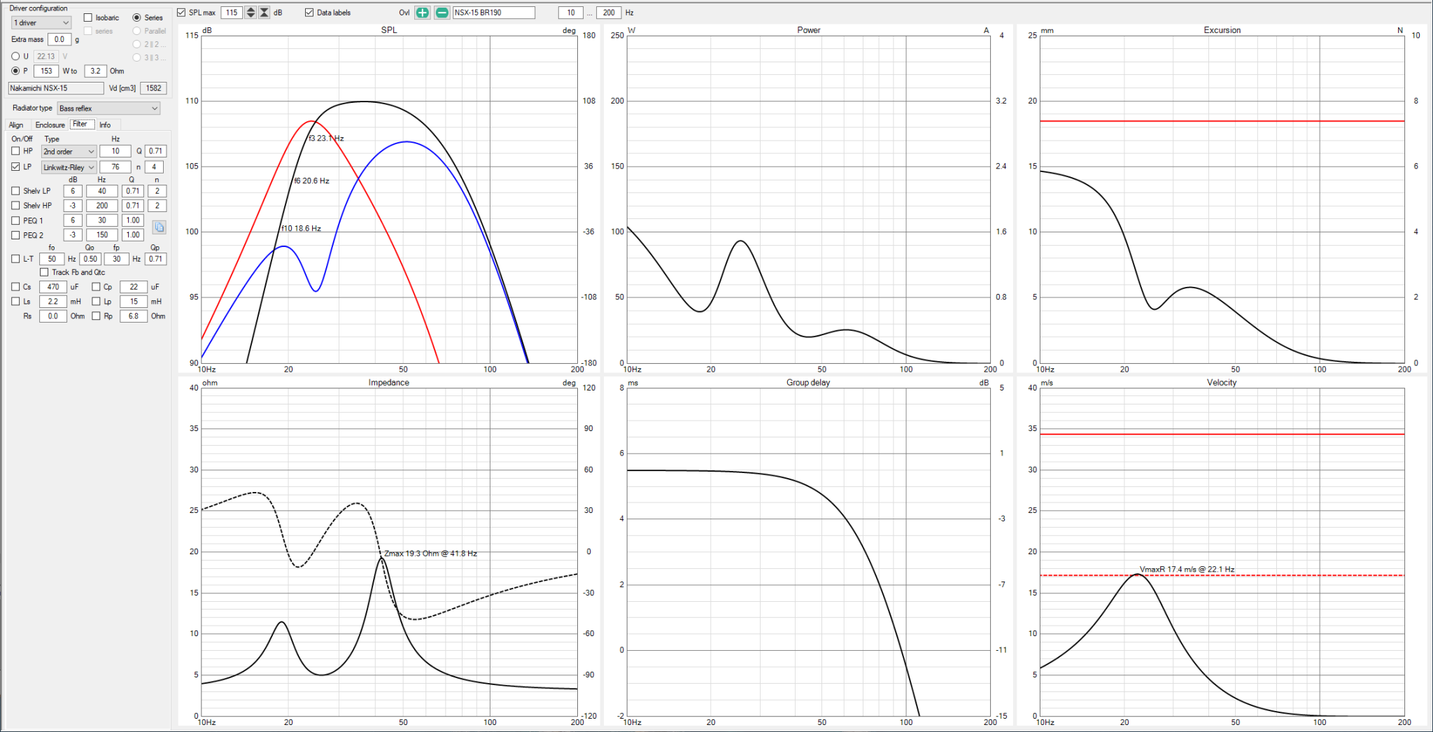

If a plate amplifier with some DSP capability is being used, another option is a 190-litre vented-box enclosure tuned to 20.0Hz. The simulated response when a VituixCAD-HP shelf filter is used together with a Linkwitz–Riley low-pass filter is shown below. Here we have an F3 = 17.1Hz, which is about 5Hz lower than the non-EQed version in the same size enclosure.
The watts required and the attendant cone travel range were shown in the simulation. The cone travel isn't all that high, but in the end that's likely to be a bit of a problem. That's because the alignment has maximum power consumption at the point of minimum cone travel, approximately 21Hz, which may cause problems with heat dissipation. Of course, the simulation has assumed values of enclosure losses QL and QA, and may not be predicting the cone excursion near port resonance particularly accurately.
For comparison, the standard 190-litre vented-box enclosure tuned to 25Hz produces the following results when a Linkwitz–Riley low-pass filter is included in the simulation. For this system the −3dB low-frequency cut-off point is estimated to be F3 = 23.1Hz.

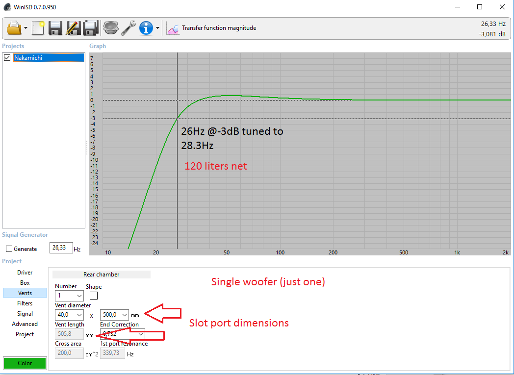

As it happens I have some enclosures that I just measured. They are 142 litres but need some bracing added so will realistically be about 140l minus the capacity of the driver once installed.
They have a slot port 40mmx500mm that is 500 long.
I am not sure how these model. I have a pair of them that can easily be bought into service. The two would be a bit larger than I would like in the room but if they work really well might be worth accomodating. Or I could mount the pair in one box isobarik mounted.
ron68 do you mind running those dimension through your software and see how that port looks? It calculates as 200cm2 so a bit bigger than a 6" pipe port.

If your box has 142 liters gross, let's suppose 120 liters net - we have to discount the bracing, the port volume (in this case external cause I suppose it is made with wood) and the woofer space, The port net volume is 10liters plus 5 liters of the wall, supposing 20mm thick. You can measure all and tell me exactly what net volume you estimate. It won't change much the result anyways.
If we consider 130 liters instead of 120 tuning frequency drops 1Hz only - pratically no difference.
With 120 liters net, you get a very good result even with a single woofer per box.
So, if you have a pair of boxes and a pair of speakers, you can build 2 subwoofers, which is much better as already mentioned - stereo subs!
Easy to build since it's ready.
You'd get FR down to 26Hz @-3dB - The tunning frequency would be 28.3Hz

Thanks heaps ron68. It models well. Looks like my intended crossover of about 100hz is very safe and will plumb all the depths I need. I have two of these boxes. They are made from 25mm mdf and very solid but zero bracing in them and they are a bit square for ideal. I think I will get them in the shed and put some bracing in them and try to break up the dimensions with some offset bracing. I will report back...
In the screenshot that was provided, a slotted port was being used. Is the "0.732" end correction the appropriate one to be used for this condition?
Can you explain the end correction? What does the number mean is it like a round over diameter or something?
Depending on how the ends of the vent are flanged, there is a correction term in the formula that is used to compute the vent length. The diagram below shows how different vent arrangements change the end correction, k. The end correction term reduces the computed physical length of the port, and the k value affects how great this reduction will be.
