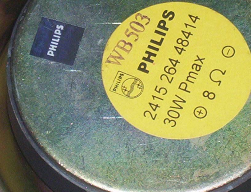

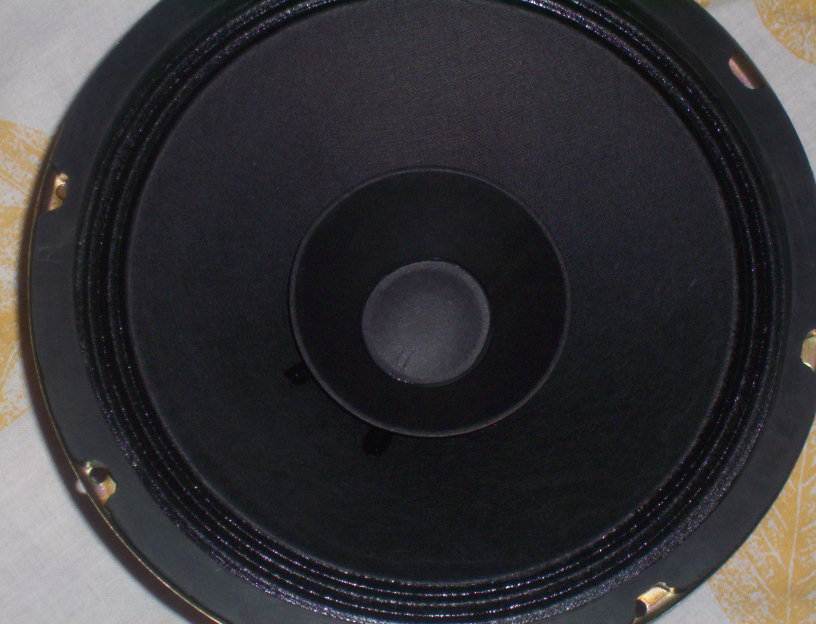

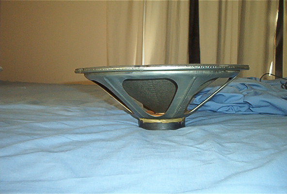

i am from india.philips india is still manufaturing this kind of full range drivers.i am not much aware of the quality of the product.but it is very cheap here.an 8 inch driver is costing only 8 american dollrs.i am just attaching the photographs of that driver.can anyone identify the type of drivers.the numbering is totally different
renjiish said:i am from india.philips india is still manufaturing this kind of full range drivers.i am not much aware of the quality of the product.but it is very cheap here.an 8 inch driver is costing only 8 american dollrs.i am just attaching the photographs of that driver.can anyone identify the type of drivers.the numbering is totally different
The fold at the end of the whizzer isn't as large as on vintage Philips FRs, but it looks like a driver with some real potential. Probably benefir form the usual tweaks.

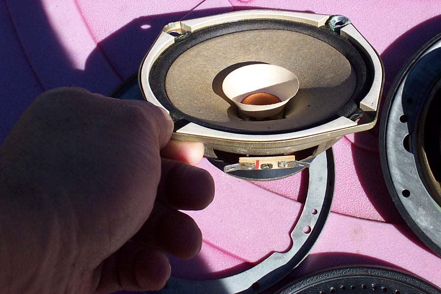

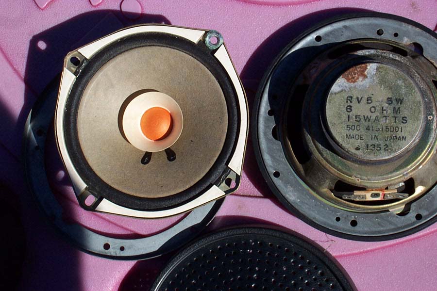

mpmarino said:I found these at a yard sale this morning. Are they run of the mill junk or could they be something decent? size: 5 1/4". The markings as follows:RV5-5W ....6 OHM....15WATTS...50C 41515001... MADE IN JAPAN...1352
They look quite good. Obviously originally intended for the car. None of the characteristics lead me to suggest any particular OEM. I'd guess open baffle material.
You'll have to hook them up and give them a listen -- i'm betting they'll sound decent....
dave

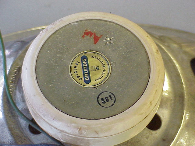

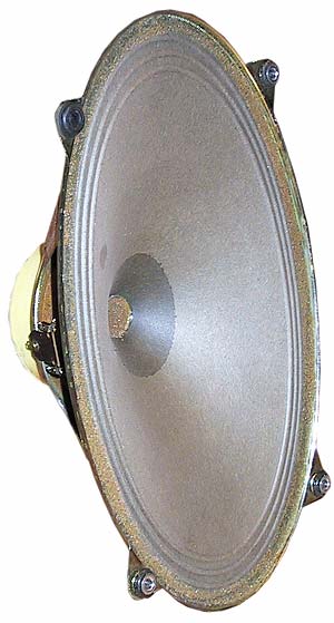

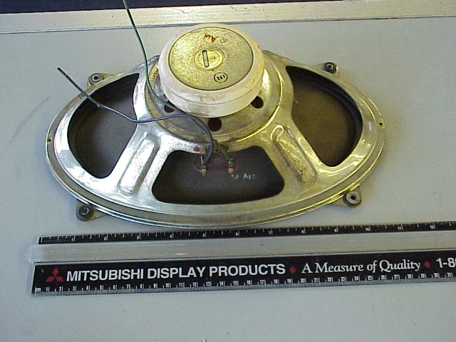

OK, By buddy found a set of oval (6 X 9 ?) drivers out of an old tube Grundig console. He sent me a couple pics. I wish he sent me a pic of the cone but ...
Would it be worth trying to pry them from his hands?🙂
Interesting, the console must be from the '60s and it also has what appears to be ribbon tweeters that were not yet removed.
7" x 11" oval.
Tweeters will be single sided electrostatic tweeters. That almost certainly implies that there is also a tube amp in there. Most of the Grundigs i've had thru here had pretty nice iron. Could be SE or PP. EL95 or EL84 (or ELL80/ECL82/86).
Speakers almost certainly do well on an open baffle. Typically sell for $20-$50 /pr

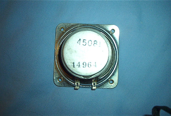

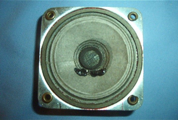

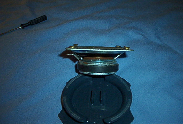

Found this tough little 3" speaker in a old reel-to-reel that was too far gone to restore.
Anyone know anything about it.
I've had it for a while and i mostly use it to test stereos( when their speakers are missing or shot to blazes). Its a pretty strong little speaker, had 20 watts put through it and showed no sign of distress.
Sound is ok, great mids and highs, fair on bass( for a 3 incher).
Wish i had two to use as Tweeter/Mids in a retro style speaker project.
