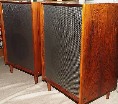

I have an old pair of Bang & Olufsen type-K speakers that I acquired because my wife liked the look of them (WAF-factor guaranteed =BONUS 😀) - this is the reason I want to stick with this enclosure instead of just making a new one to fit the drivers. Below are a few photos and data on the enclosures:
attachment.php
[model photo - mine are the same type/veneer]

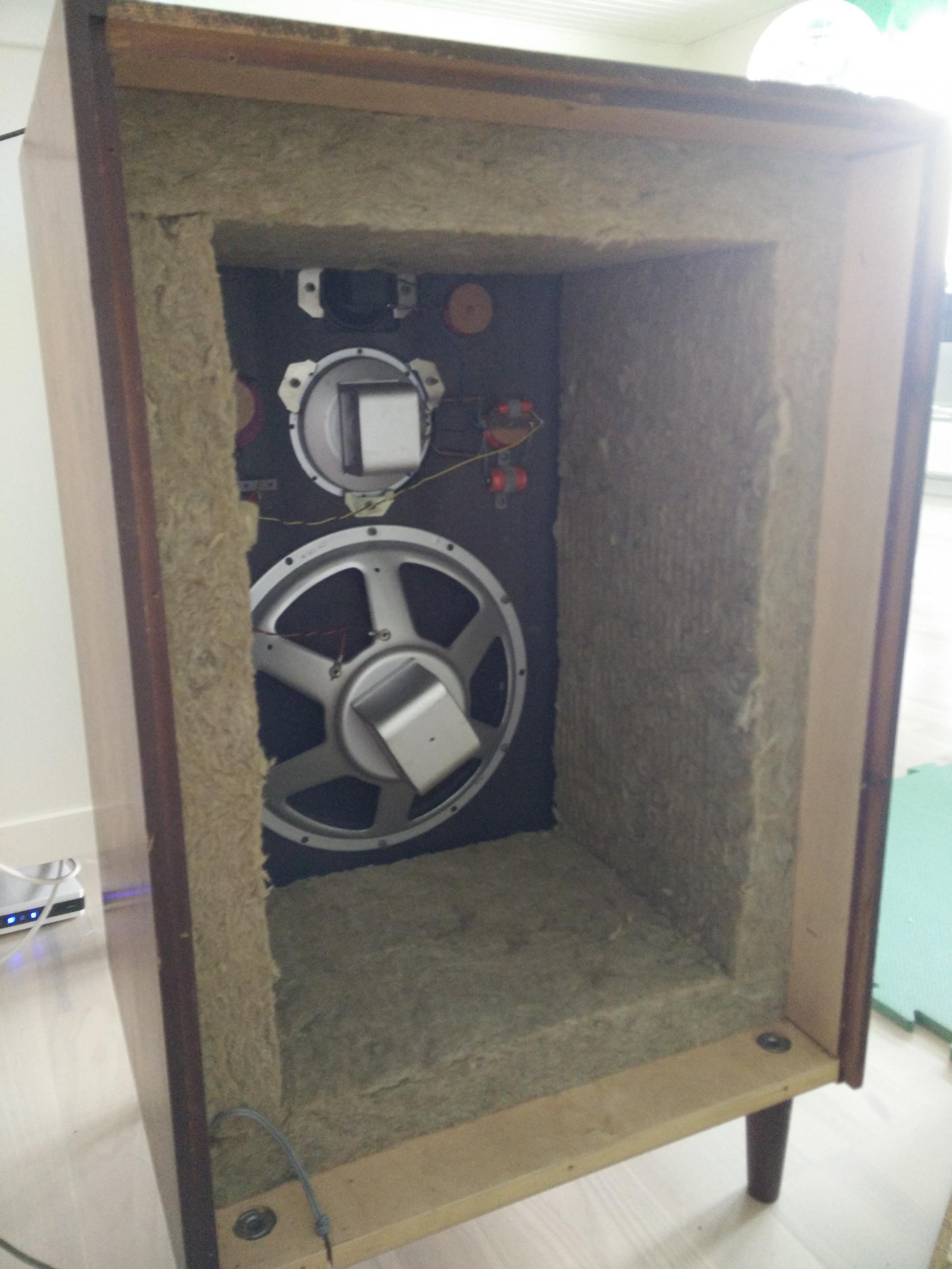

attachment.php
[The inside of the speaker from the back. It is a 3-way speaker from around 1964]
The inside dimensions (excluding stuffing and drivers) are:
Width = 44.5cm
Height = 61.5cm
Depth = 35.0cm
And the bats are 5cm thick and are glued to all sides except the front baffle. There is also an extra loose piece of stuffing at the back of the speaker making the total thickness here 10cm (it may have been added later?)
The rear plate is a relatively thin light board, and is simply screwed into place.

if you're going full range (my preference) then you need to place the driver at ear height, else you're going to be missing out on the higher frequencies, that's just the reality of a large radiating diameter, if you can't do that, then go for a dome tweeter of 25mm or preferably 19mm, keep the crossover simple crossover, design is a dark science and you can spend a lot of time driving yourself crazy, unless you enjoy doing that keep it to 1st order and two-way (in my experience), unfortunately that does limit your choice of driver combination, and size of woofer.
The thick damping is great, keep it, putting more timber in there is likely a waste of time. volume needs to match the woofer but I wouldn't lose too much sleep about getting it exactly right.
My suggestion is get an 8" and a 1" dome, cross at 3500, one coil on the woofer a really nice capacitor on the tweeter, then spend some time building a pretty cabinet for your full range driver and maybe incorporate a sub.
Those are beautiful!
I would try to find a new mid and leave them as they are. You might stiffen the back if really thin, but those are best left unmolested, IMO. Make some small boxes for your fullrangers and place them on top if you must have something newer, it will keep other things from being set on top and ruining the finish.
