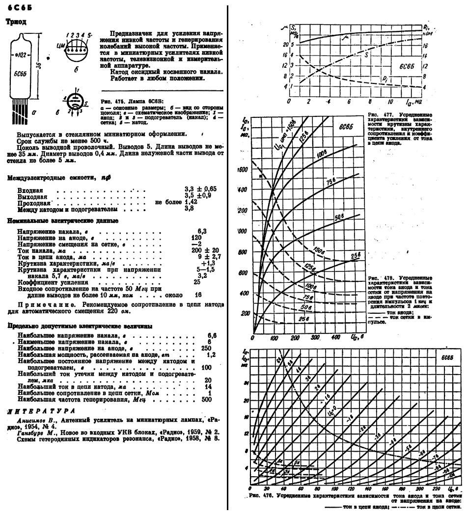

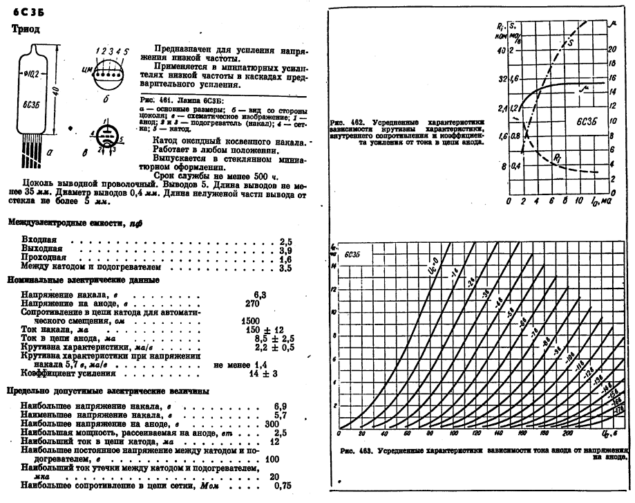

I have been successfully using 6S6B-V, which has medium mu, and now I also have a few 6S3B-V triodes, which to my inexperienced brain, appear to be suitable for a line stage, perhaps driver duty also.
Bear with me while i dig up the specs....
Some data:
6S6B-V:
Mu about 25
Ra about 5k (from recall)
2.5 to 4.5 mA/V
Characteristic circuit/charts (which imprinted but cannot find online now in look again, state a Vg of about 2V, close enough to my input stage circuits in reality)
6S3B-V
Mu about 14
Similar or slightly higher Ra than 6S6B
1.75-2.75 mA/V
Characteristic circuit/charts, show Vg of about 8V.
Seeing this, and noting my driver stage is biased at about Vg -5V using 6S6B, I supposed that a 6S3B may suit better, possibly swing more mA to the output stage.
Cathode current rating are similar between both valves.
So I then suppose that a mu follower using the 6S6B as the lower valve, and 6S3B as the upper valve, may perform well, perhaps better than a mu follower using identical valves.
Can anyone help enlighten me a little?
I believe that the lower mA/V of the 6S3B is suited to a larger input signal swing, cathode follower or perhaps mu/half mu follower.
But is my assertion close to correct? Or am I barking up the wrong tree entirely?
