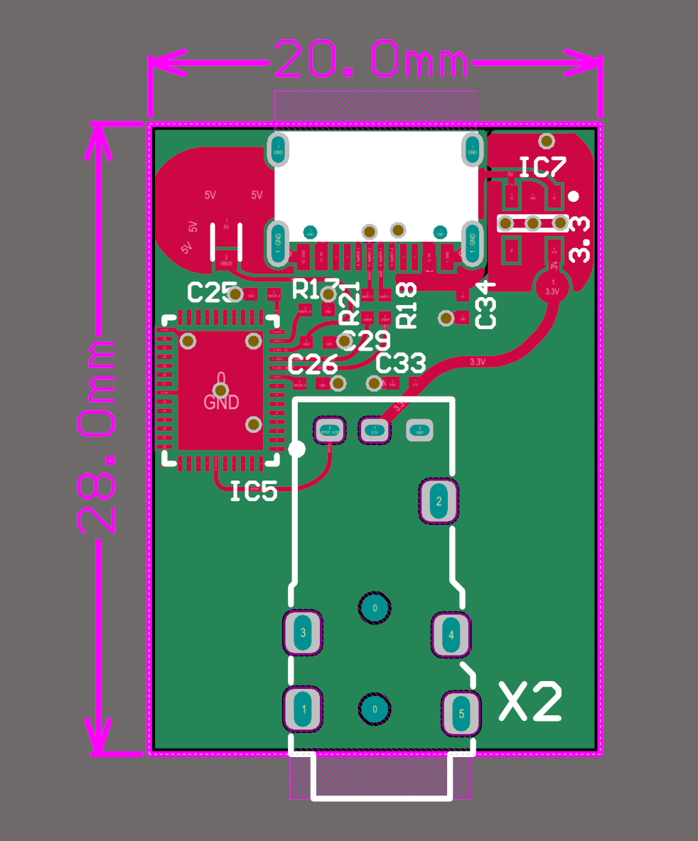

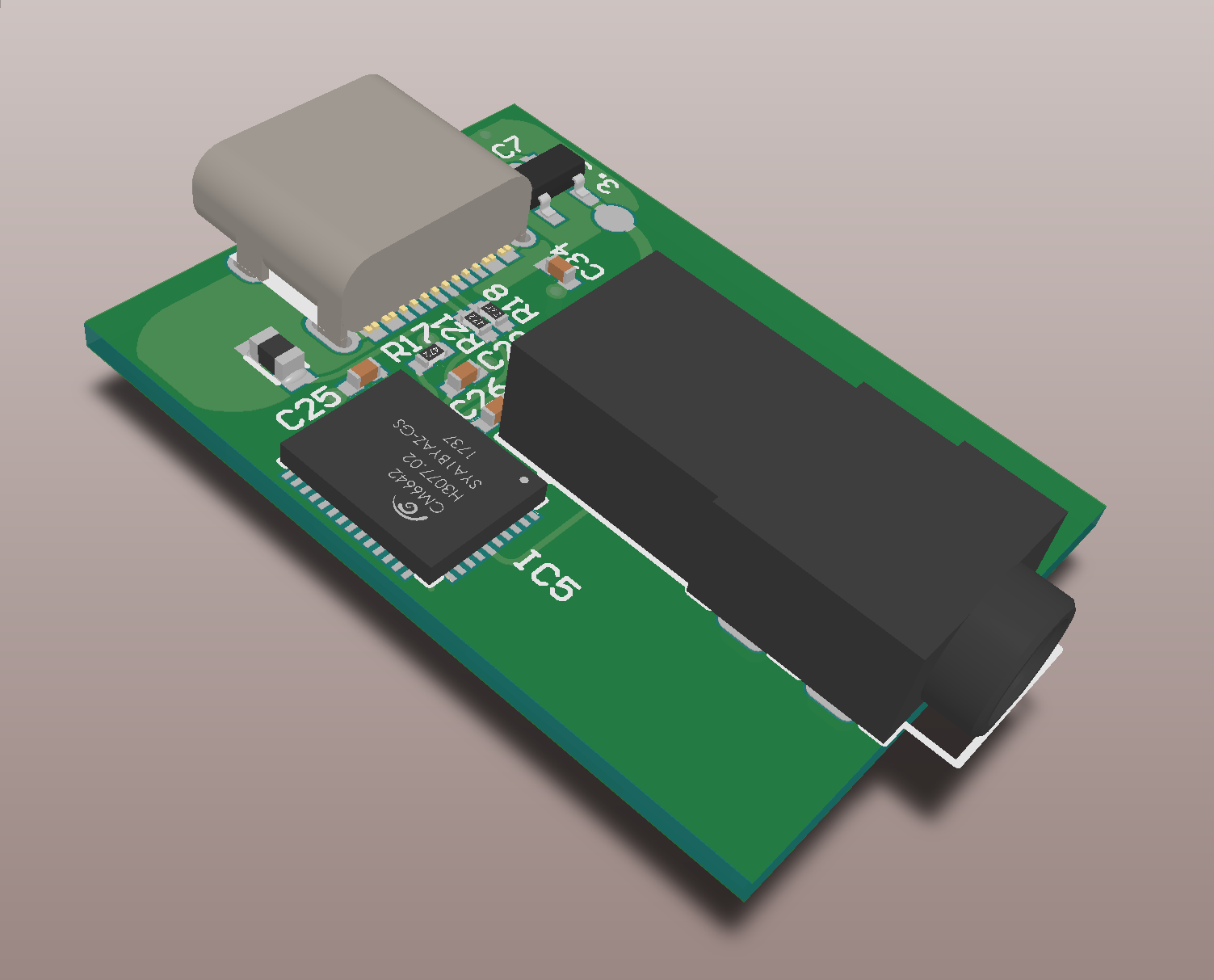

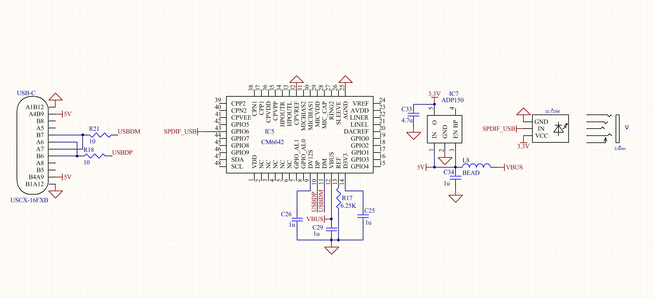

No problem, and in case if you wish to build such interface by yourself, I give you some sketch what I made right now as exercise.

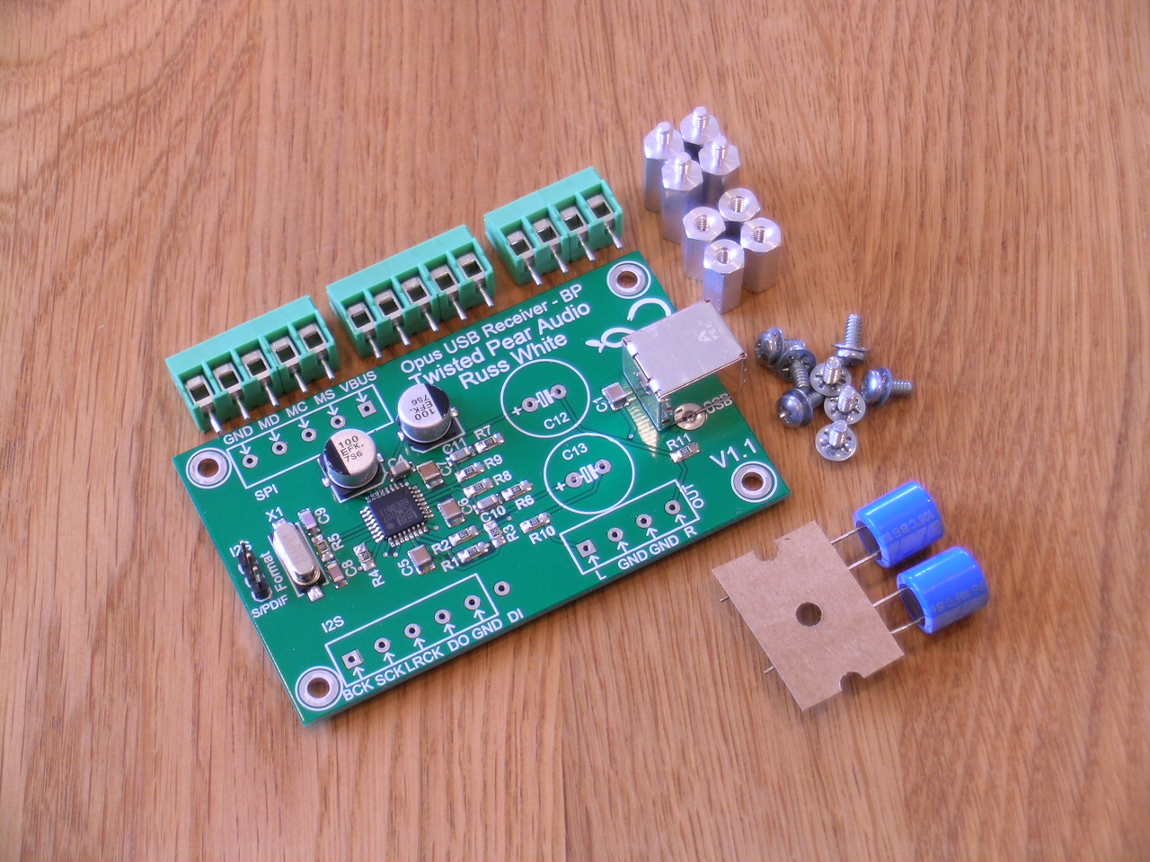

This $60 board might interest you: Twisted Pear Audio DAC/Receiver. It is solely powered by USB and can output SPDIF from USB without any special drivers. Works in both Mac OS and Windows.
