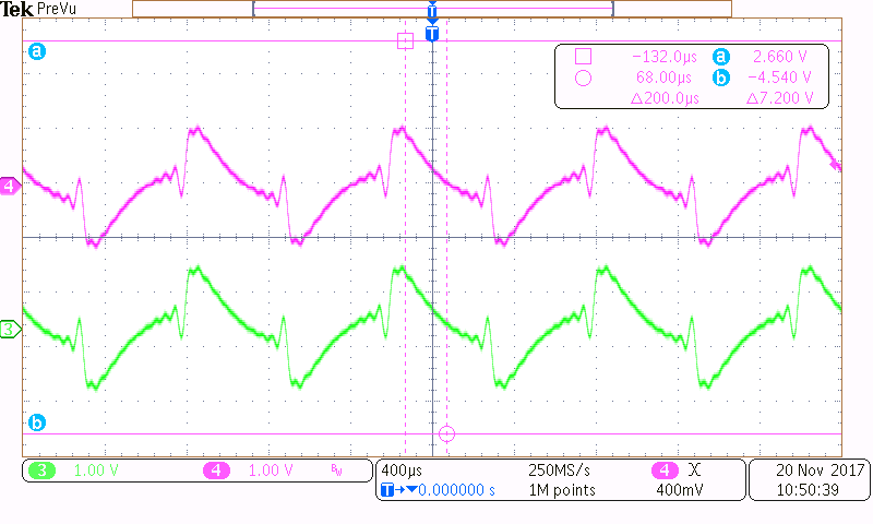

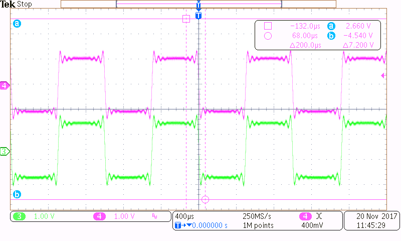

I like to make audio test signals with Adobe Audition. The Dell desktop supplied at work puts out something
vaguely resembling a square wave. This was worthless as a test signal and made lousy audio for playing music.
Boss got me one of these
https://www.amazon.com/StarTech-com...ocphy=9030961&hvtargid=pla-338189065906&psc=1
which puts out textbook audio and is a good value. Remember that "ringing" is the Gibbs phenomenon and
happens because the bandwidth is limited, not because of some fault in the system.

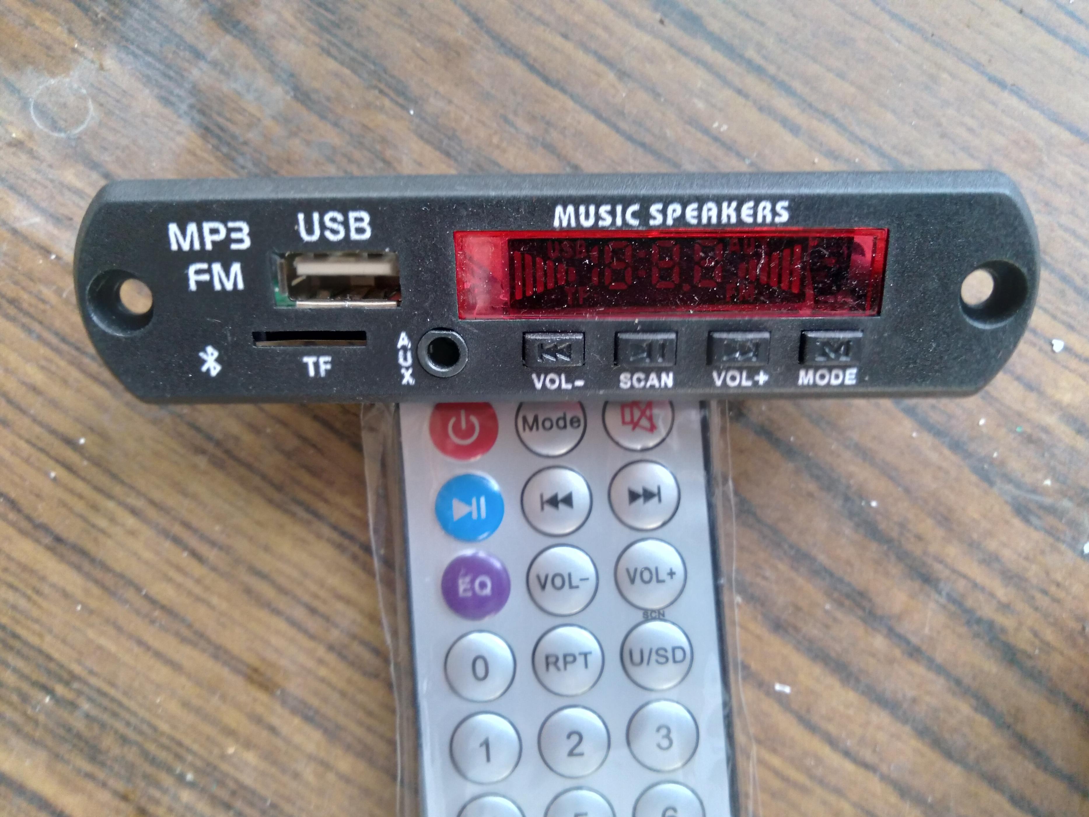

Features:
You need Amplifier Board and Speaker to use this Module. Bluetooth FM USB MP3 Audio Board with LED Display
With IR Remote Control: Yes
With the LINE input (AUX) Song Number Display: Yes Supports: Bluetooth/ FM/ USB/ MP3/ AUX/ SD
Frequency Range: 87.5-108 MHz
Led Seven Segment Display
Support: 32-320 kbps MP3 Songs
Support: FAT 32, FAT 16 File System
External Antenna
This unit is used to feed a Amplifier, from Amplifier you can drive Speaker.
Do not connect Speakers directly to this unit.
Power and Output Specification: Input Supply: 5V (You can use regulator IC LM7805 to bring the supply to 5V)
S/N: 65dB
Distortion: 0.2%
Output: 550 mV
Separation: 45 dB
Auto-Search Station: 22-28 dB
Frequency Response: (90 Hz - 15 kHz)
Dimensions: Length: 41mm Width: 32mm
(This is for the $2 module)
I am using this type of module in my car to play 48 kHz 320 kbps MP3. The unit has a pair of 4440 ICs as the amp.
It works, and cost only $5 for the amp, speakers, wire and labor were extra.
I can take the memory stick with me, no thief will bother to steal the radio/amp , and it is totally solid state, a big advantage in cars driven over bumpy roads.
Also I can change the music when I tire of it.
Currently using a $4 32 GB stick, hundreds of songs on it.

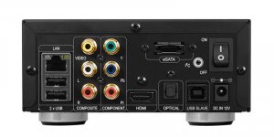

One version is for people like you, who need to add USB and Bluetooth to their audio systems, for that a sort of pre amp is sold for about $5.
It has this module, a housing, built in power supply, and RCA jacks.
Like in your photo, this sits outside your system.
Some technicians remove the existing analog radios and put this module in place in audio systems, a bit of Frankenstein to me...
