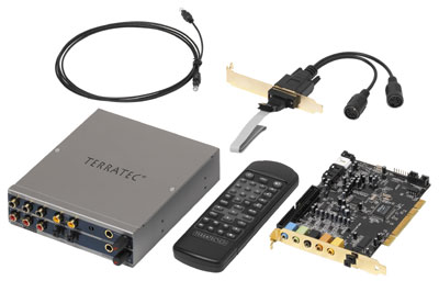

hello
i dont know if i did something bad
but i ordered a Terratec Universe - soundcard
eventhough they have
Firewire, which my computer supports!
I wait for my package delivery to arrive anyday.
what you think, friends
should i have chosen the firewire???
info: http://sounduk.terratec.net/
Regards and thank you for any opinion

I was thinking like this:
I have my old have EF86 tube based oscilloscope HEAVY as a fat man!
I have used this 2-channel like 5 MHz analog scope for some looking at output of my amplifiers. Sine and square waves.
i use it in final developement stage, for the trimimng with small caps, to get squarewaves not to have too much over-shooting.
But it is a drag to start up this old 100% tube scope.
Only warming up all them London english tubes, will take half an hour of time ...
Remember them vintage tube-radios!
now as i use my New super Pc so much,
I thought getting a good link into my computer and use some smart technology software
( why not best freewares like http://audacity.sourceforge.net/ )
and some software Oscilloscopes add.ons
and so get my signals into where I sit the most.
And easily be able to present my results onto my webpages:
http://lineup.awardspace.com/
I also would love a good link to PC for my DAT, Digital Audio Tape recorder machine,
16 bit 96kbps sampling, for maximum recording,
for example from my discrete transistor microphone amplifiers, like one shown in my own pictures:
http://www.diyaudio.com/forums/showthread.php?postid=1008980#post1008980
Short, i have never owned a dedicated sound card - only had those built in stuff
on the motherboard.
When you are into audio you ought to give yourself something better.
Dont you think?
Regards to ellada or sidney or whereever you are right now my friend, John
from lineup
another good thing,
has built phono RIAA amplifier
just to attach my Grammophone and start copying my old Vinyl Long Playing 33 rpm albums
from 1965 and forward .... .... ..

You did OK ...
... " 24bit S/PDIF input/output with 44.1, 48 and 96kHz " (from http://sounduk.terratec.net/ )
This is the critical spec on any sound card = the ability of any sound card to pass 24 bit / 96k audio in and out.
This sound card is as good a choice as any, certainly much better than most.
Interestingly, by using the Coaxial Digital (SPDIF) or the analog @ 24 bit 96k to connect to your sound system, the quality differences will not be detectable by your or my ears, unless the computer you have allows the internal power supply noise to "escape" through your cabling to your system (digital pre-amp input). The external "breakout box" will prbably do just fine filtering any of this off the lines.
Let us know how it goes / how it sounds.
(That Aureon 7.1 FireWire item shown above your sound card is about as good as it gets = Oxford Semiconductior chip set and good power supply filtration: http://sounduk.terratec.net/modules...Sections&file=index&req=viewarticle&artid=333 ... compared to your card: http://sounduk.terratec.net/modules...Sections&file=index&req=viewarticle&artid=329 )

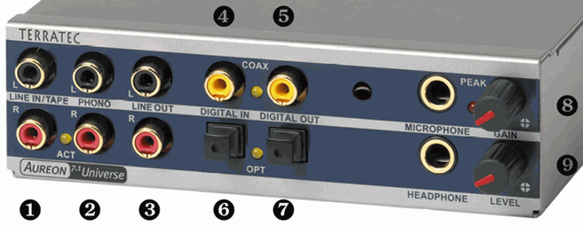

thanks, FastEddy
I visited your website - so I noticed you most probably have some good knowledge :)
What I am glad about, is that there are BOTH type of digital connects on the soundcard Front Module.
SPDIF and TOS-link ( Coax and Optical ) Digital Input and Output of 24/96 digital signals.
You know there are some devices that have only one type of digital,
either Coax or Optical.
I notice some playback can be done with 24/192 but everything else is in 24/96.

Aureon Universe comes with an advanced CD software interface
with most any feature.
And a remote control!
Here are the details of FrontModule 5 1/4" for put in my computer Chassi.
See also attached picture:
Front Module Connectors
* Bit-true Digital output, optical/coaxial, 44.1/48/96 kHz (TOS link)
* Bit-true Digital input, optical/coaxial, 44.1/48/96 kHz (TOS link)
* 1 Line Out, stereo (Cinch) 24 Bit/96 kHz*
* Line In, stereo (Cinch) 24 Bit/96kHz
* Phono In, stereo (Cinch)
* Microphone In, mono (6.3 mm) 24 Bit/96 kHz with Gain Control
* Headphones Out, stereo (6.3 mm) 24 Bit/96 kHz* with Volume Control
* IR Remote Control Receiver
lineup ;) getting ready for a digital future, using his PC as Sound Center!
