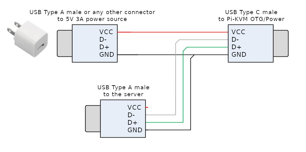

Normally gadget mode expects to take power from the host, but I don't want to do that (and my host couldn't necessarily supply enough for a Pi anyway). So I need a way to use a second power supply without endangering the host machine or the Pi. It has been suggested (on other forums) that using a supply for the Pi could in some circumstances try to back-power the Host's USB port (e.g. if the host was powered off), and that this could be bad.
An obvious way to avoid that is to connect only ground and signal from the host (below picture as an example). However.. there is criticism of this as if the Pi is powered down the host can supply signals that would then be higher than the Pi's (powered off) positive rail. The theory is that this is bad for the Pi.

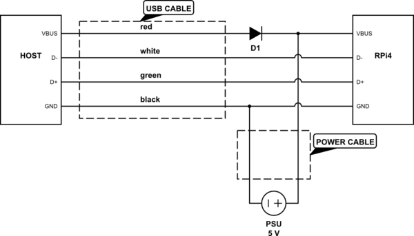

So another suggestion i've seen is to connect +ve from the host via a diode so that it cannot be back-powered. The voltage drop across the diode is unimportant because it is only used in the event that the Pi's supply is turned off before the host.
Not sure I want a low power host potentially trying to power the Pi though, if the Pi's power supply gets turned off first, for example. I would prefer to endanger the Pi rather than the host. So I suspect it could be better to (instead or also) use a relay that disconnects the host USB cable if the Pi's power goes down.
But.. I'm not sure how much of this is unjustified internet FUD, or whether there is a better way. Does anyone know?

I do not think there is any problem with feeding USB data signals to powered-down RPi. Many USB devices have external PSU and are kept connected to the host when powered down.
It's true that using standard cable the RPi4 is kept powered on through the USB host 5V, with the chances of low-power if more is needed by RPi.
Why not using standard cable with the 5V wire cut and power the RPi through 5V GPIOs directly? What's the advantage of using the USB-C connector for power?
Thank you (as ever).
It is hard to tell which pieces of information are based on fact and real knowledge, and which on paranoia or misplaced logic. But I too have not found any issue leaving powered-down USB devices connected, so cutting the 5V line seems easier. I might use a small extension to a rear panel-mount USB socket, and omit/cut the wire in that extension; then standard USB leads can be used externally.
Yes, I may well power through the GPIO. I believe it is electrically the same as using the USB-C connector on the Pi4, so just whichever seems most convenient at the time.

I sorted out a separate power supply for the Pi4, and made sure the incoming +ve wire in the USB lead from the host wasn't connected (just connected ground and both USB-2 signals). On the Pi, I then:
