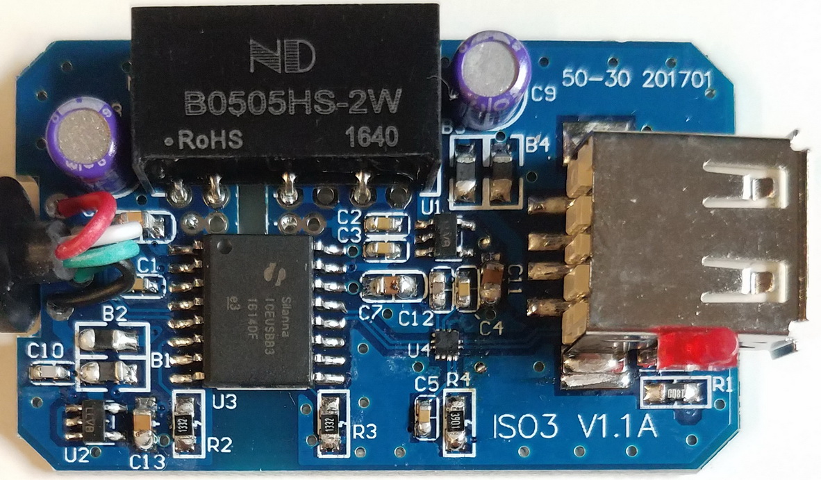

I was wondering if it is possible to remove the isolated DC-DC converter and instead feed the isolated side from a dedicated power supply.

I don't have a datasheet of this specific Silanna USB insulator chip, but on all the other chip I know it is possible to use an external 5V supply. On the Murata NMUSB evaluation board (12Mb/s maximum data rate), the external power configuration is the default. You may also disconnect the input of the DC/DC converter and feed the external 5V power to it. This way you will keep the USB power line segregated from the main power supply.
