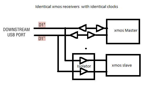

Seeing that many people have success with different USB isolating gizmos, I
want to find out if it is possible to make a cheap usb isolator.
Please chime in and share your knowledge if you think my suggestion is
technically impossible:
I want to hook up a cheap xmos the latest generation device so the computer
sends out audio via usb. Parallel to this device I want to put a USB (one way)
isolator followed by a good DDC with the same Xmos chip as the cheap one.
The question I have is this: will the isolated xmos work since it receives data,
or does it also need to send back data to the computer to work properly?
Any input is greatly appreciated.
Klaus

Cheap isolators are limited to full-speed USB (12Mbits/s). Going to high speed gets significantly more expensive - presumably its high speed you're wanting with an XMOS interface. Seeing as that's going to be an async interface, your proposal to 'piggyback' off the transmission isn't going to result in synchronization with the isolated interface. They'll have different clock rates.
The TL;DR answer is yes, the isolated one does need to talk back to the PC in order to work as an async peripheral.

USB communication by principle is bi-directional. It really does not matter what protocol is being used.
As of isolation - audio devices have the advantage of typically using simple-to-isolate buses behind the USB receiver - I2C and I2S. Therefore most isolated USB high-speed audio devices use isolation behind the receiver chip (XMOS).
For the actual USB isolation - high-speed USB isolators start at 150EUR.
There is another option - using ethernet (galvanically isolated by principle, standard requires 1.500Vrms for 60 secs) and an inexpensive SBC running linux with USB-IP server Galvanically-Isolated USB (+ longer distances) - USB over Ethernet
For the USB audio async protocol - there is a small FIFO in the USB soundcard (the smaller, the lower latency and wider usability the device offers). The device monitors fill level of its FIFO and reports back accordingly whether the host should be sending more or fewer samples in each USB frame - hence the control feedback.
Adaptive audio devices just PLL their clock from the incoming stream of the USB samples - i.e. the audio pace is timed by the USB host controller.

Thanks for your clarification.
I would really like to isolate the Computer from the xmos chip and buy a
DDC like the Singxer F1 that does the I2S isolation part.
So what would happen in a cenario like that in my picture?
If the slave xmos talks back into nirvana will it still process the incoming data
send by the computer?
If it receives the data with neglectable delay because of the isolator
will the small buffer compensate for this?
Please help me to see my error in this configuration.
a "write" token is generated by the host
both master and slave are then reading the data packet.
since both devices are working at the exact same speed
the handshake packets by the master should work for the
slave as well I guess.

No non-isolated USB DAC will break a USB host <->amplifier ground loop where the noise gets created behind the DAC in the DAC -> amp connection.
On the other hand it may be cheaper to break the ground loop at analog domain than using USB2 (or even USB3) galvanic isolators.
