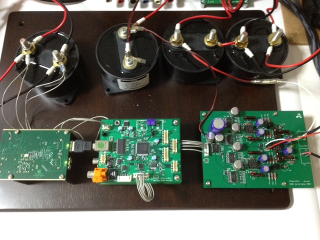

Bunpei received a bare board from ElectrArt as a beta-tester and built it based on the schematic.
Please look at the picture attached below. The board is connected to his PCM2DSD converter board ( which is connected to his USB Dual Audio board).
By using this board you can listen to all the DSD sources, ranging from DSD64 to DSD512, without any commercial DAC chips!
Bunpei thinks the resultant sound is very satisfactory.

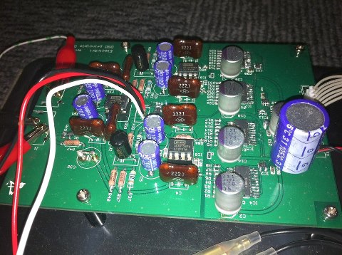

Attached is a picture of "DSD Principle Board" Bunpei assembled.
(The photo was taken by Mr. Kanda.)
Bunpei guesses that ElectrArt might design the OP-amp stage of the board based on a typical schematic given on the datasheet of DSD1794A.

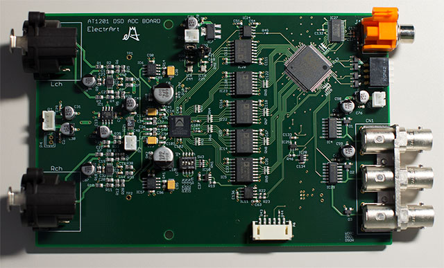

The AT1201 ADC board
is a 2-channel ADC with a XLR input. Its output is TTL SDIF-2 or DSD-raw through BNC and S/PDIF (only for PCM ~192kHz). The board supports both PCM 44.1 ~ 384kHz/24bit (SDIF-2) and DSD128 & DSD256 (DSD-raw) outputs. An output format can be selected by a setting of DIP switches.
Neither any input level control nor input-level indicator is on board.
Output signals can be isolated from other circuits on the board.
You can look at its schematic.
http://fpga.cool.coocan.jp/electrart/AT1201_SCH.jpg
The board requires 4 DC power supplies, +-8V (for analog) , +6V, +6V and +5V(for TTL output).
Bunpei tried preliminary recordings of PCM 44.1kHz/16bit and DSD256. A PCM WAV format file and a DSD256 DFF format file were obtained on his PC without any problem by using PlayAudio program. His Windows PC is an i5 Ivy Bridge CPU based Windows 7 (64bit) machine.
An ASIO driver is also available though Bunpei has not tried it. A PC spec required for operations might depend on what you want to do in your system.
