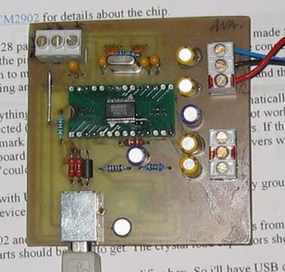

ukram's USB-DAC
Just finished & tested!
Arne K
Hello,
i have built the USB-DAC based on the Ukram project in order only to use it as an interface for USB to S/PDIF. Now that i have finished the board and it is not working :xeye: i have a few questions.
I get no signal out of my Parasound DAC when plugging in USB, what might be wrong? The supply voltages are there (4,8 V USB and 3,39 V from regulator) and i checked the whole board three times for mistakes.
Is it right that i can plug it in right between USB out and digital IN of my DAC?
Do i have to change something in my PC setup?
Thanks in advance
Frank
