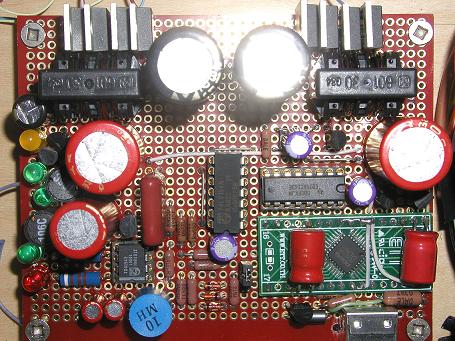

I did all the modification designed by ECdesign posted on TDA1541 forum.
48M clock, feed async shift-register reclocker, 1/4 to feed PCM2706.
I2S attenuator and dynamic attenuator for BCK, LED regulator at 5.2V for 1543, LED shunt regulator for 1543 bias at 3.8V as I am using 910R I/V.
Hi 2A3SET,
