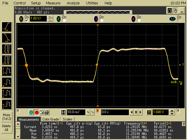

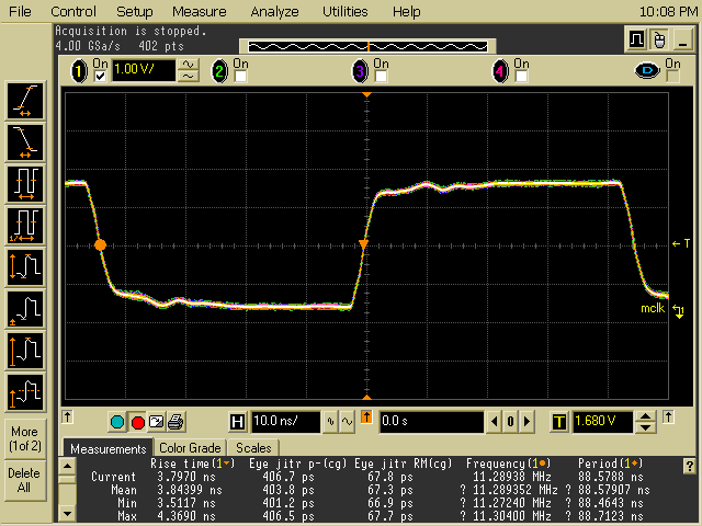

I managed to grab a good scope for a couple of hours, so made some jitter measurements on MCLK which is sourced from the Wolfson WM8804. RMS clock jitter is sub 70ps from USB and ~80ps from a CD which happened to be just a Sony CD Walkman.

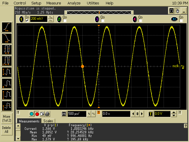

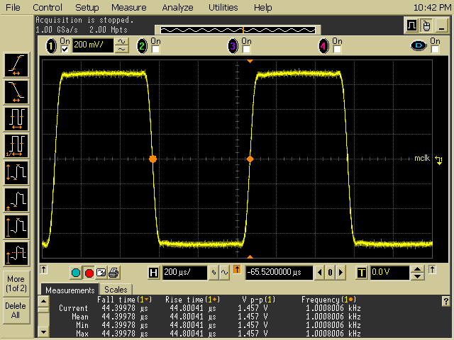

I also measured the Square response (22KHz anti-alias filter applied) into a pair of AKG headphones which looks clean with 44us rise/fall time.
