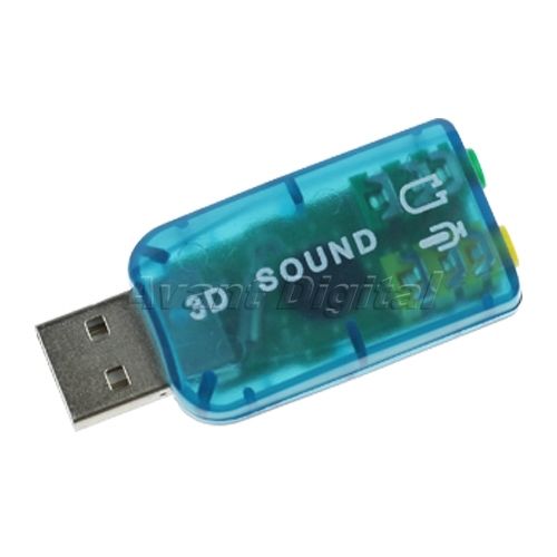

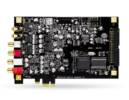

I have this Sound Blaster X-Fi titanium which is said to be "the card" for audiophools. Two weeks ago I bought this USB thing from China for $0.99 which included shipping.
When it comes to sound quality it out performs the X-Fi by an order of magnitude. On the bus installed sound card I can hear mouse movements and the hard drive access and software runs, the Chinese USB thing is King no noises just beautiful clear music!
