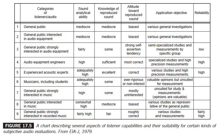

Regarding listener abilities here is a chart from a study published in EIA-J 1979 (from Sound Reproduction by Toole, 2008).
Note especially rows 3, 4 and 6.
