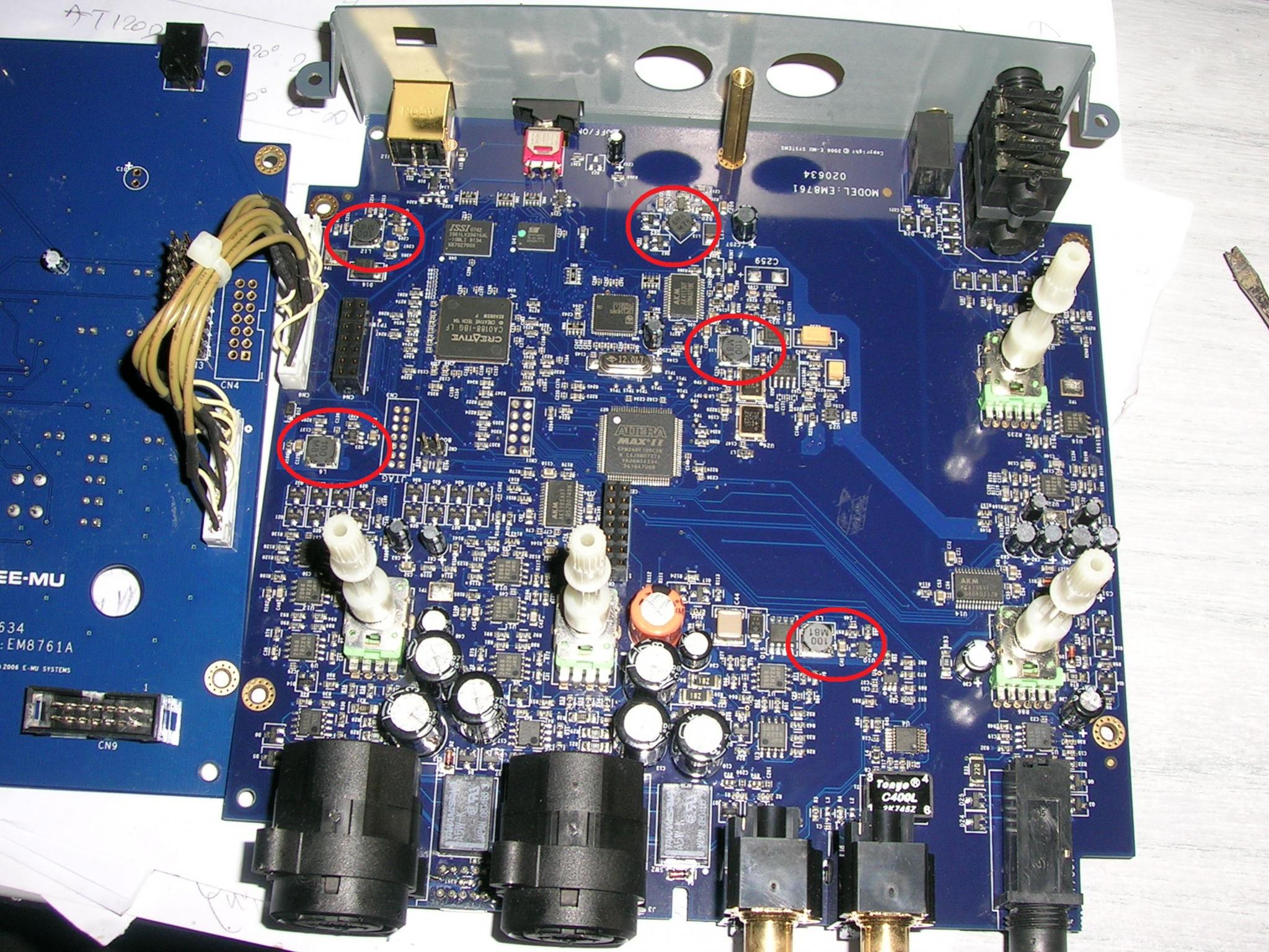

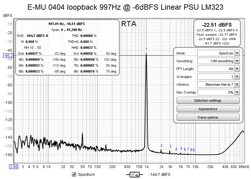

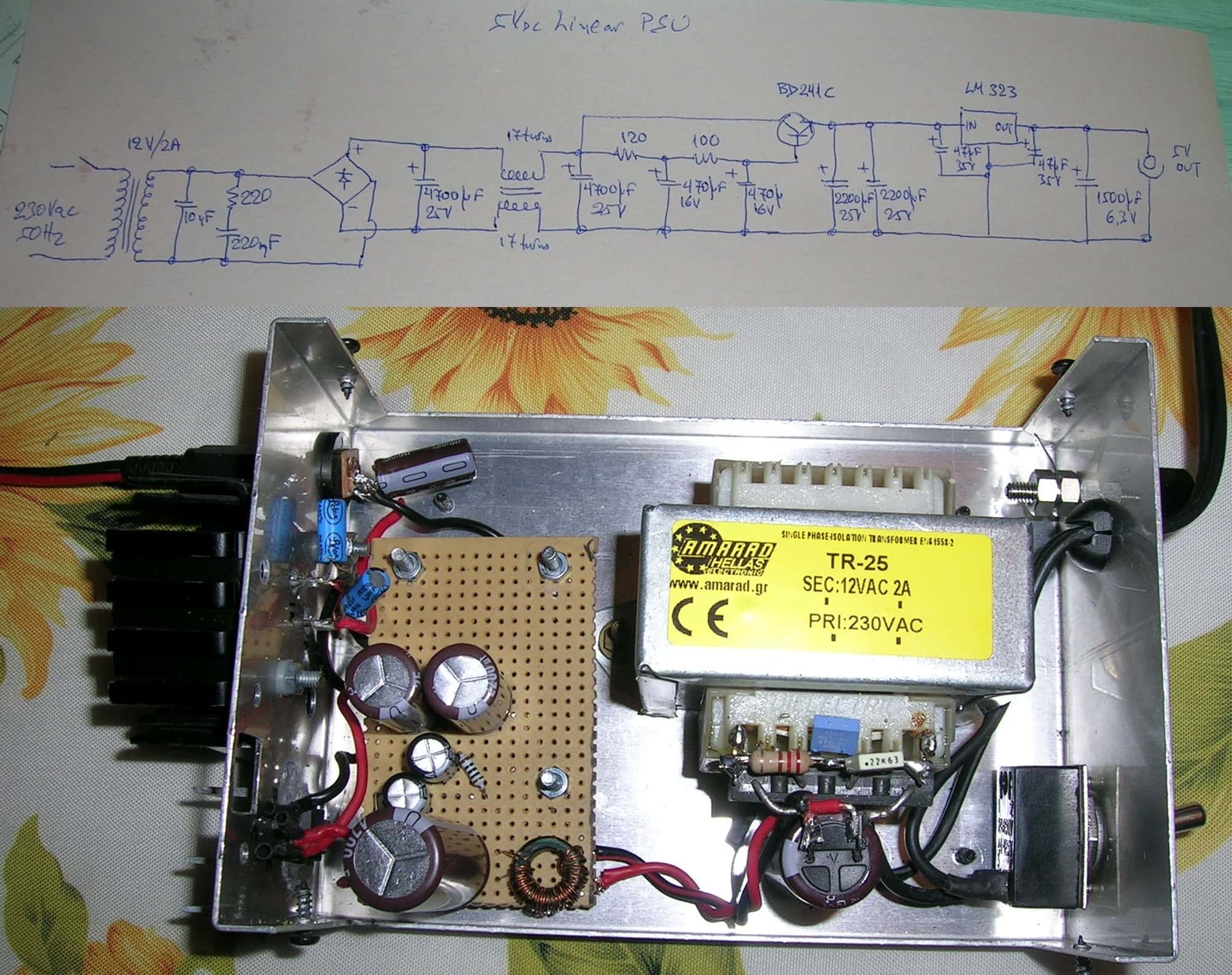

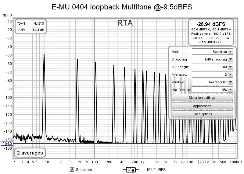

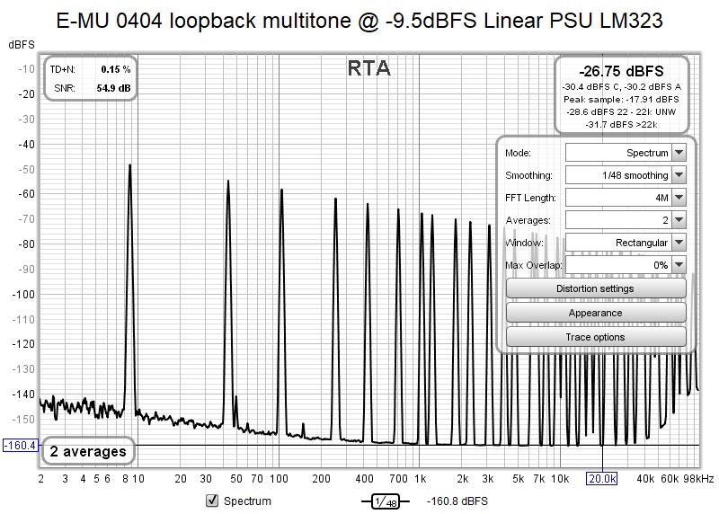

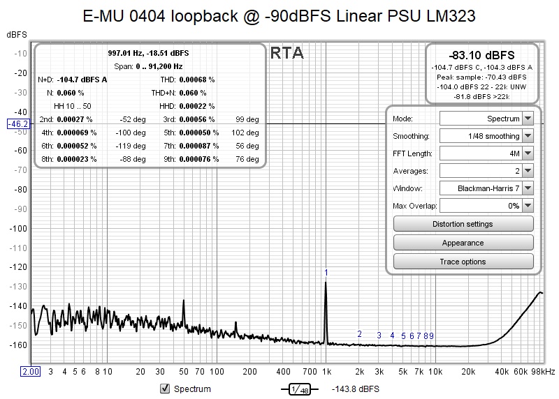

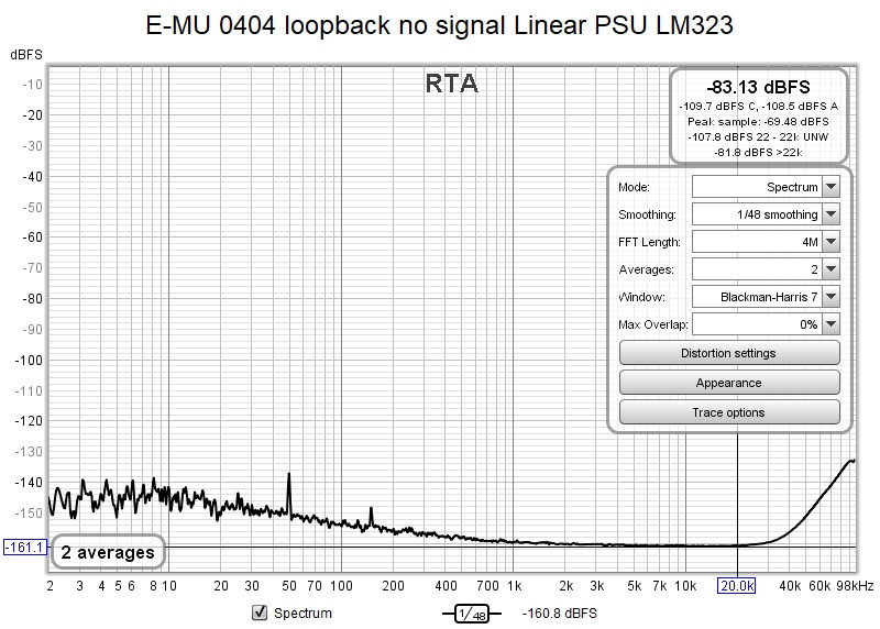

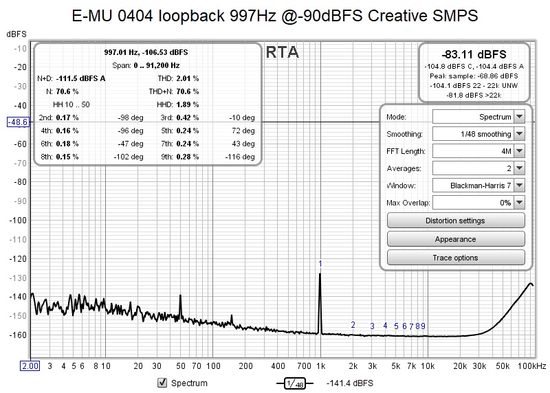

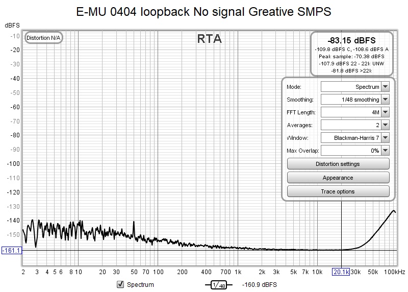

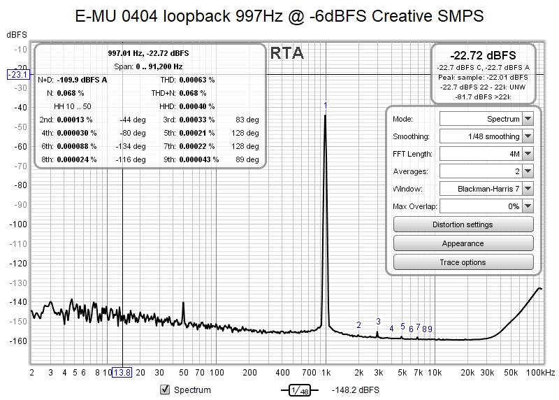

I ‘ve built a “proper” 😀 linear PSU for my E-Mu 0404. With the linear PSU, card measures as having 6 dB cleaner noise floor on the multitone test, otherwise no difference.
On board E-Mu 0404 there are some five switching DC-DC converters, don’t expect much of a change even with the best outboard 5V PSU.
George
