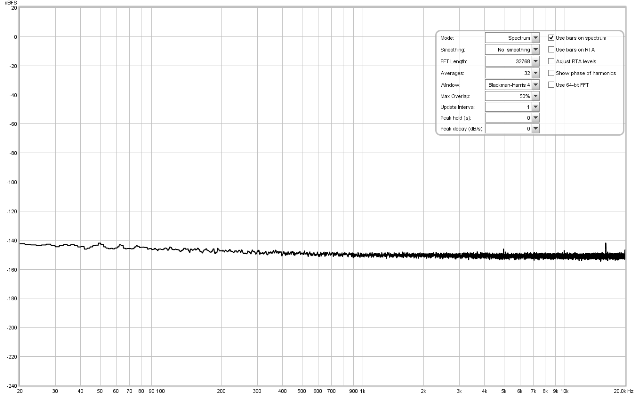

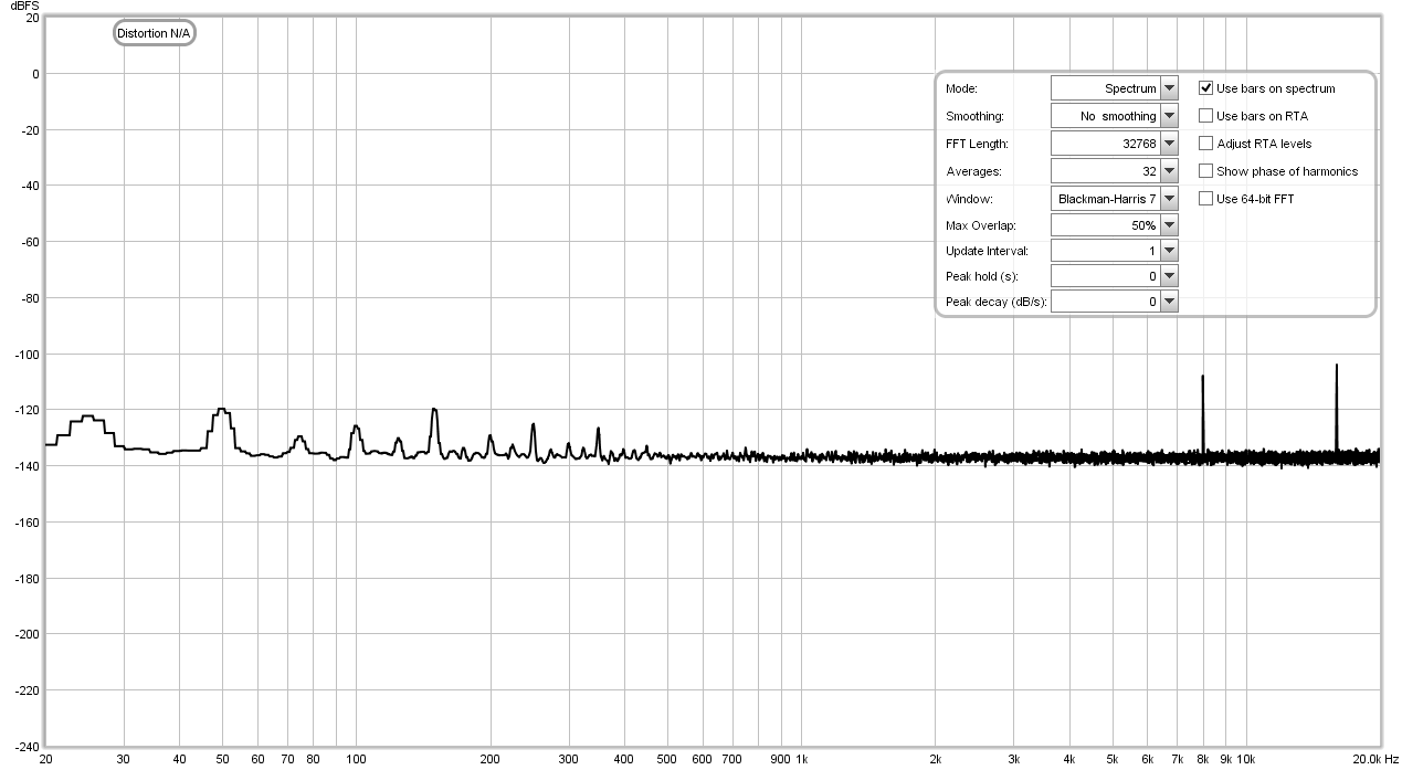

Hey David, i am by no means any expert on this but i recently dipped my toes into the waters with REW. I happen to have two different interfaces that i tried to use for various amp measurements, so i can relate my experiences from this if thats any help.
Now, i don't know exactly what qualifies as ultra low-noise for your purposes.
The noise specification of both scarlett and clarett interfaces is below -128db.
I have a scarlett 18i20 gen2 (which is mains powered), and the noise floor of this is around -140dbFS, see below.
On the other hand, i also tried using my mbox3, which is USB powered. Its noise specification is the same as the scarlett, but it seems a tad cleaner and doesn't have the mains noise (this measurement was done without the laptop plugged to mains).
So from my point of view, the mbox3 offers an excellent measurement system for these purposes, it is also fairly light and very robustly built, and they are pretty cheap used.
Hope that is of use.
