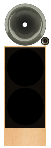

Second thoughts..
Rodd,
You are using dual JBL LE10A's from 70Hz to 1200Hz, right?
I could fit a 350Hz tractrix on top of the woofer cabinets, and use dual 10'' woofers to drive the frequencies below 500Hz, for a reasonable WAF design (see the attached image)
In this scenario, I would like to get away with not using subs, so the woofers would have to cover 30Hz-500Hz. Any woofer recommendation in such a setup (10 inchers) ??
Rodd,

Re: Second thoughts..
You're getting closer and closer _big grin_
Actually, in the final anlysis it looks like Roddy and I think more alike than we do differently _even bigger grin_.
Conceptually a 350hz tractix with the Tad handling down to 500hz is a solid concept, although I'm not as technically minded as a number of the _horn_ enthusiasts -
I don't remember the specs and how high a bandwith he was covering with it but Linkwitz had an H frame dipole with 2 12"s in it, one facing forward and one back - The frame was just barely large enough to mount the 12" drivers -
The proportions were similar to your drawing ( as I envision it - you didn't give dimensions) and if it went up high enough might well be a satisfactory solution.
If you were using a digital crossover you could EQ as needed for the dipoles.

Rocky said:a 350Hz tractrix on top of the woofer cabinets,

It seems that there is no shortcuts in such a system. I am fortunate to have your help or I would spend years walking the the extra miles..
Rodd; I am not willing to compromise on efficiency in the midbass area, as the extra octave 30Hz-60Hz is simply not worth it. A single subwoofer can do the trick at this frequencies, and I can live without it for a period.
Now, with regards to midbass solution, I would like some more input.. The "no-sub" criteria is no longer valid (as it will not be feasible) so the area to focus on is 100Hz-500Hz, preferrably as low as 60Hz. Dual drivers will be my preferred choice to get a large pushing membrane area with a relatively narrow box width. The dipole suggested by Ken (I assume it's this one):
looks like a very interresting solution, however, if I were to use such a setup, I would use 10'' drivers instead of 12''.. but are the dipole my ideal choice? a better choice than vented or closed box?

And would the JBL LE10A be dipole suited? or are there better choices?
Would I get the same result by pointing both woofers forwards, but inverting polarity on one of them?
Rocky said:And would the JBL LE10A be dipole suited?
Well I guess Ken and I must part ways here. I'm not a big proponent of dipoles... at all. That's not to say that it can't be sucsessful, they can. I'm just not a big fan.
The character of the mid-horn will have a lot to do with determining the configuration of the mid-bass driver(s). As mentioned before, the characteristics like dynamics and to a little lesser extent impact, should match or "blend" across the two ranges. I've alway believed that the dispersion pattern through the x-over range is also important.
