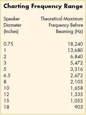

I'm not sure, without the experience, that it can work because of roll off and not because of beaming or distortion.
I would say, from a theoretic point of view, that it would work to 150/200Hz but I'm not comfortable with that.

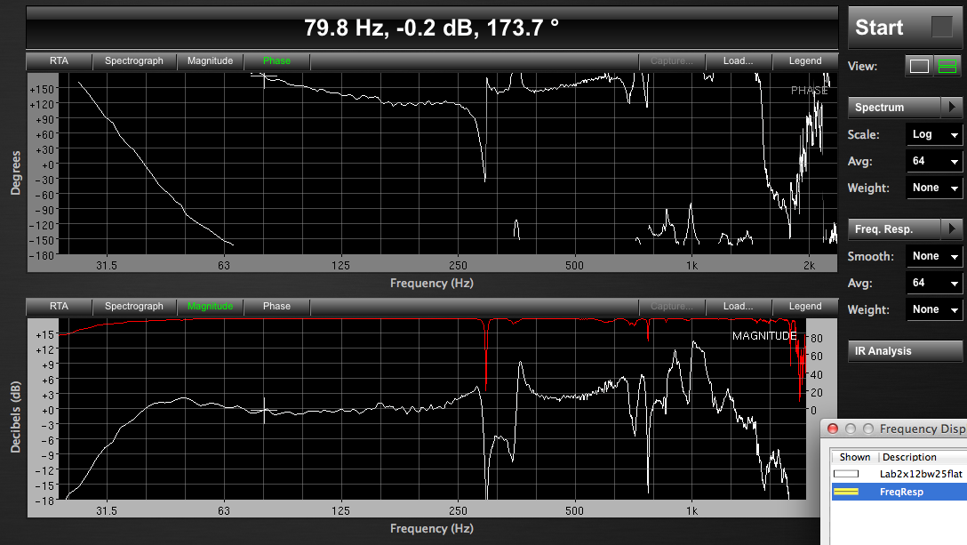

I think 200 Hz would be OK for the Lab12, and distortion would be low in the upper range, probably less than 4% THD.
I have not tested that high, but here are the results for lower frequencies, outdoor tests using sine waves at 800 watts (49 volts into 3 ohms) at one meter.
The calibration was probably 3 dB low.
30 Hz 110 dB 9% distortion
35 Hz 114 dB 6%
40 Hz 117 dB 3%
45 Hz 121 dB 3%
50 Hz 122 dB 10%
60 Hz 117 dB 13%
70 Hz 119 dB 3%
80 Hz 117 dB 3%
100 Hz 117 dB 4%
The peak and dip in the response curve around 315 Hz of the white curve is a port resonance.
The purple chart shows the same 2x12" enclosure with the ports sealed, other than a little glitch around 360 Hz, response is smooth to 630 Hz.
I would say the Lab12 sounds good up to a 300 Hz crossover, but port resonance could be a problem using it that high depending on tuning.
