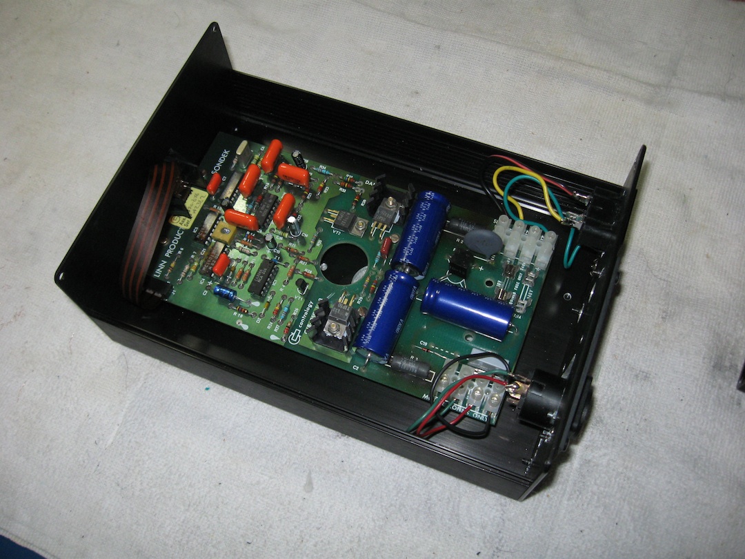

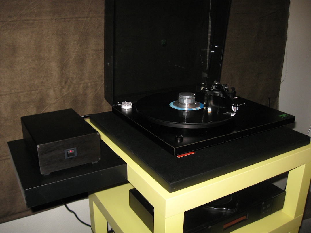

Another option....
Locate a Linn Valhalla power supply, put in a separate box, get a 50hz pulley (oh wait, you already have that).
I did this and the improvement was significant. The Rega motor is virtually the same as in the Linn. For an umbilical I used a std. 16/3 power cord which will fit in the stock power cord hole on the plinth with a little coaxing. For a connector I used a "SpeakOn".
If you ever go back across the pond you can easily swap the Valhalla to operate on 220v.
No more Rega "runs fast" issues and speed stability was markedly improved.
Just a thought.
Just a thought.
