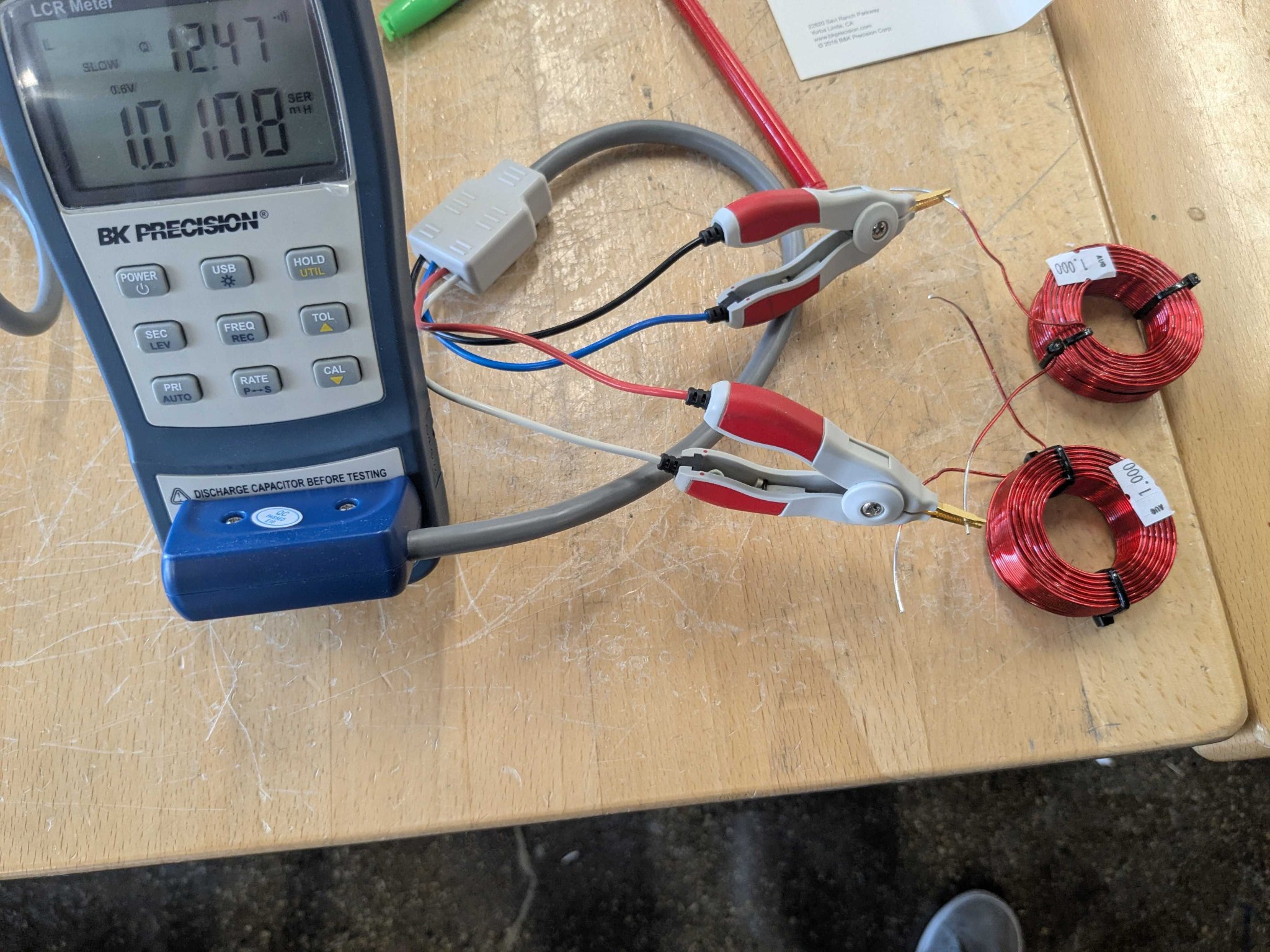

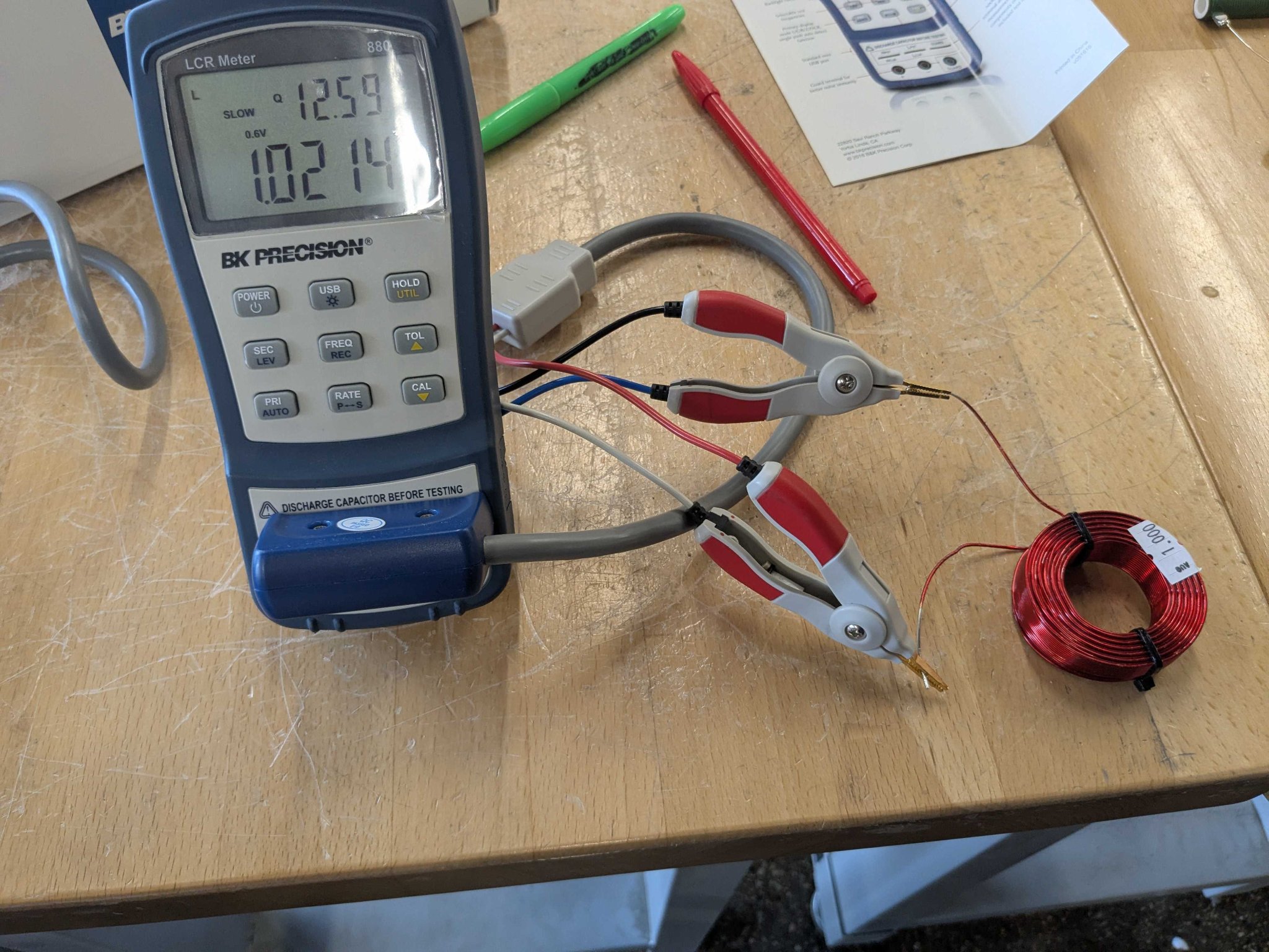

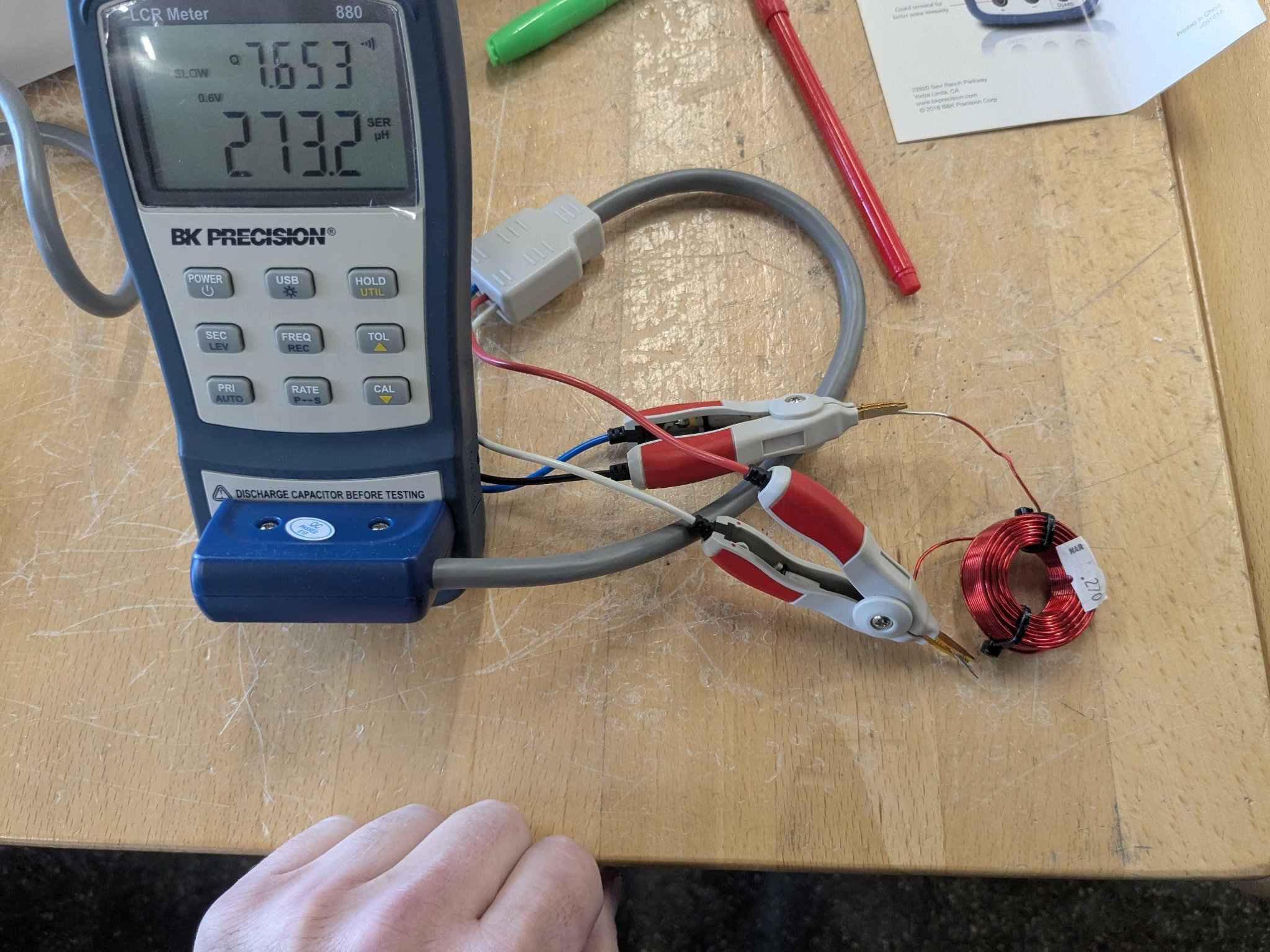

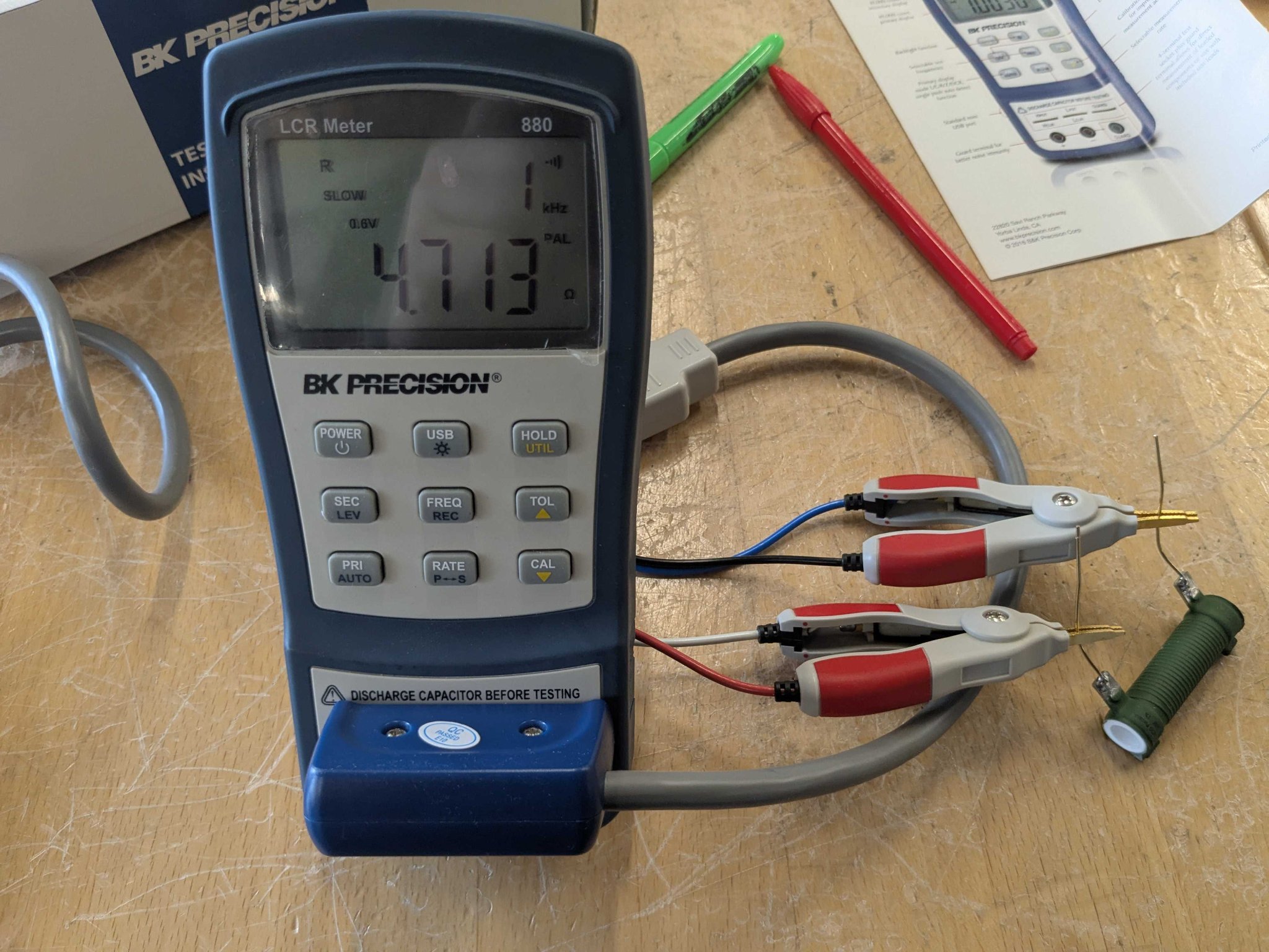

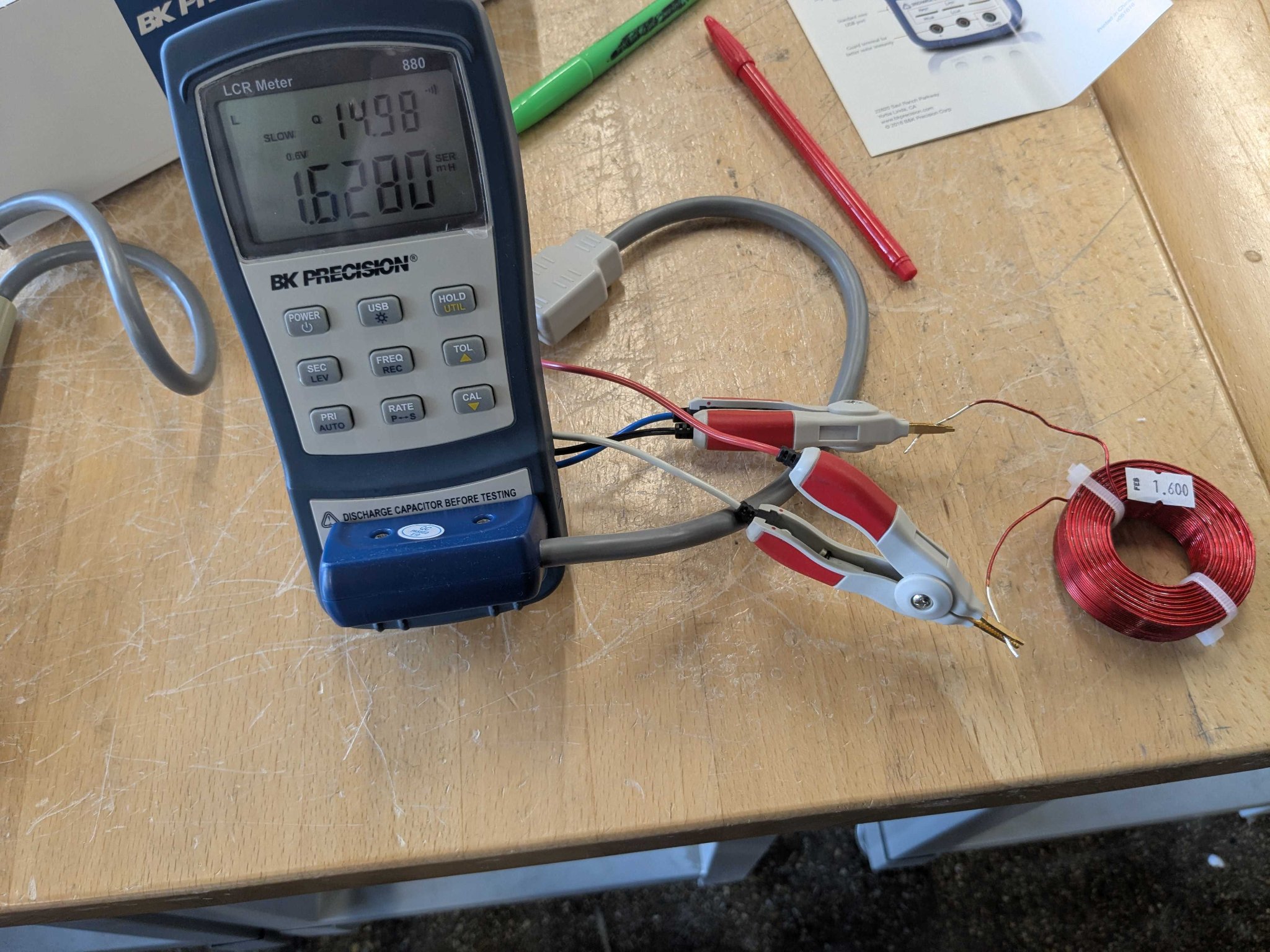

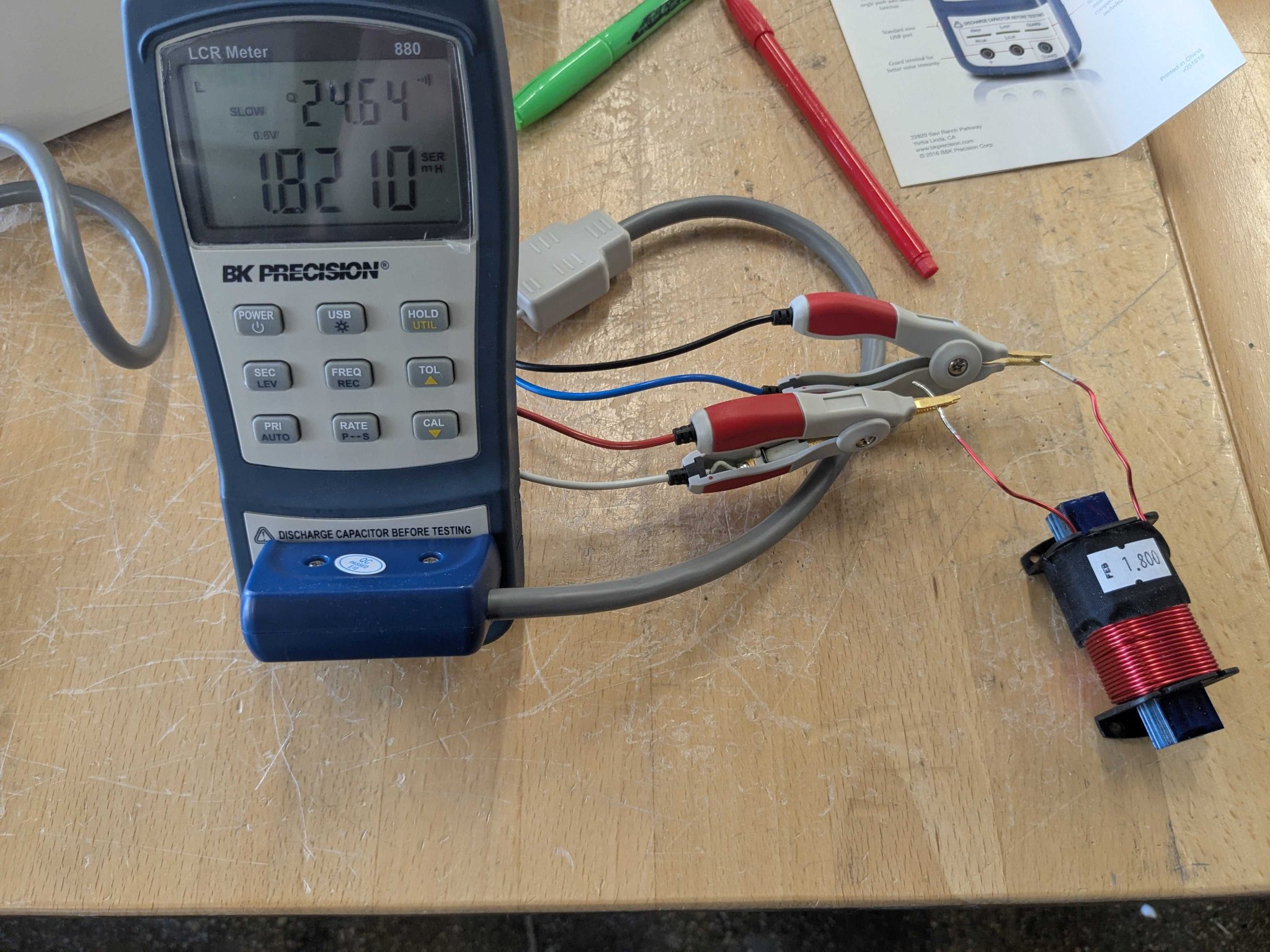

Got it. I figured my test wasn't accurate with how far it was offOfficial data on inductor dcr are accurate, and you can't rely on dcr values measured with LCR meter.
Basic multimeter will confirm it. 1mH coil has about 24m of 16 awg wire. 1 m reads 0.013R.
I have a couple of iron core coils from Madisound with the same type of mounting. I affix those directly to the cabinet walls since the 35 mH parts are a hefty chunk of metal which would rip through a circuit board with a moderate impact, and the values seemed to be off by about +10% to +12%. It turned out the #8 alloy steel screws protruding about an inch (2.5 cm) from the end of the iron core were enough to significantly increase the inductance. A switch to stainless steel screws fixed the problem.
For DCR, you can use the 4-wire method. Just inject a known current (1A to produce good voltage on small resistance) and measure the voltage across the inductor. For the current source, you can use a voltage power supply with a resistor in series. E.g.: 10V and 10ohms to get 1A.
At the bottom of this page, Troels has a link for how to measure low-DCR coils using capacitors to target specific freq range for the test. http://www.troelsgravesen.dk/coils.htm

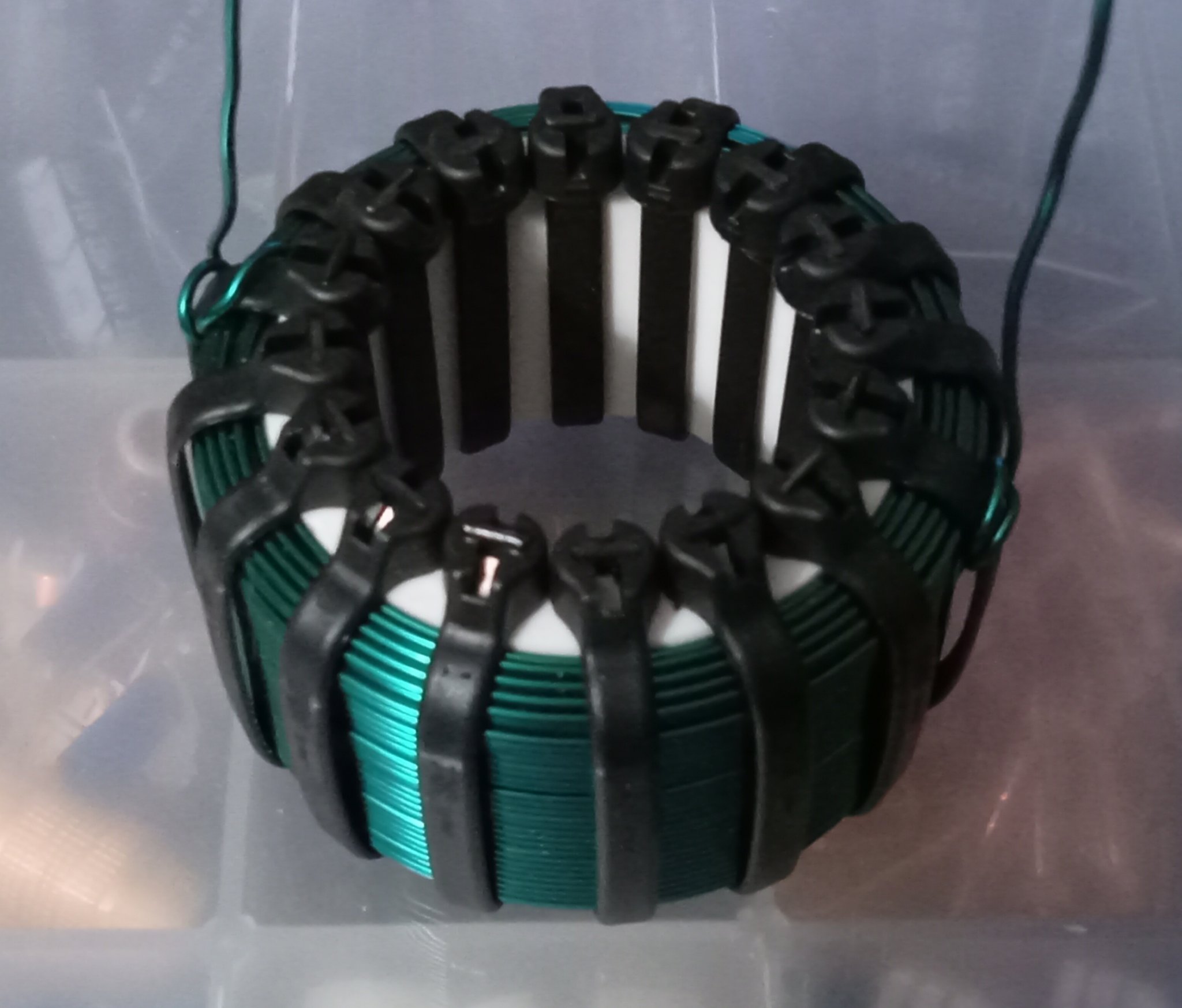

I'm using tie wraps but I did test brass screws VS stainless. Stainless still affects it quite a lot. Brass has basically no effect static, however, if you start playing music it then DOES have an effect as well.Obviously being within hailing distance of an inductor core matters, but I generally order stainless steel with more non-ferrous metals in the alloy for fasteners in my audio gear (with standoffs, barrier strips, etc.) A bit more expensive but not bad.
