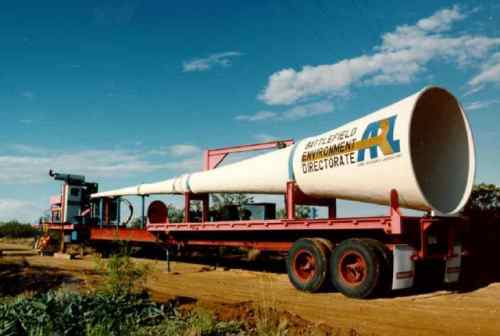

I don't think they use this as a weapon as such. Maybe for training simulators or maybe for the development of acoustical homing devices. The infrasonic waves generated by tank engines or helicopter rotors travel quite far in the open space.
For this purpose they once developed a thingie they called MOAS (mobile acoustic source) that could generate 145 dB down to 15 Hz. It was a huge horn on a trailer fed by a steerable valve, controlling air-flow from a car-engine driven compressor.
I wasn't able to find any pictures on the web anymore unfortunately (it looked impressive to say the least).
