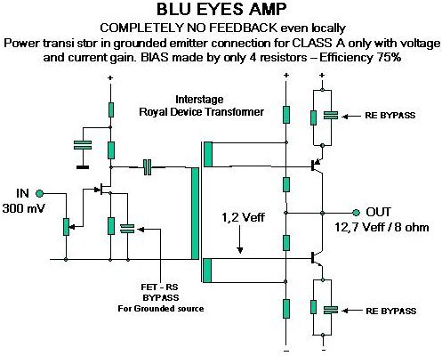

royaldevice "BLU BAY" (driver transf. + SEPP Power-Amp)
http://www.royaldevice.com/BluBayEng.htm
http://www.royaldevice.com/BEmeasures.htm
http://www.royaldevice.com/BEschemaeng.jpg

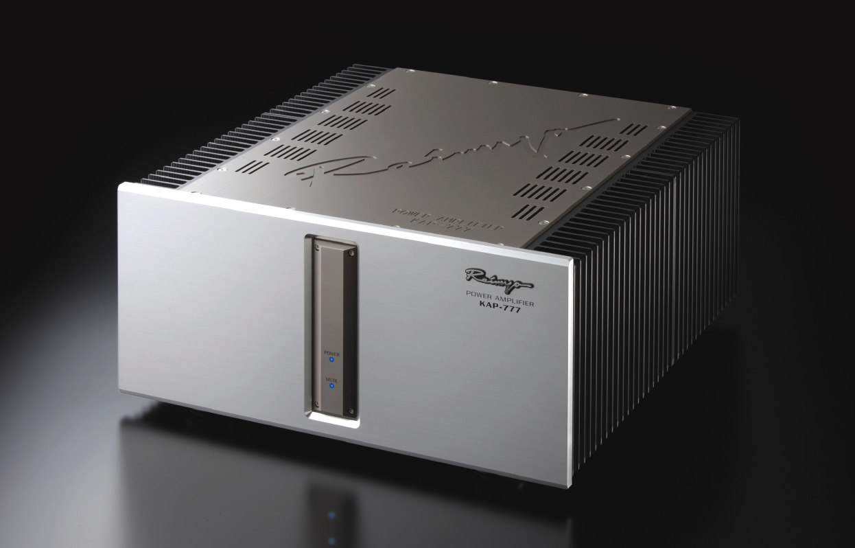

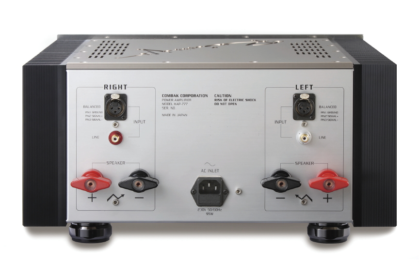

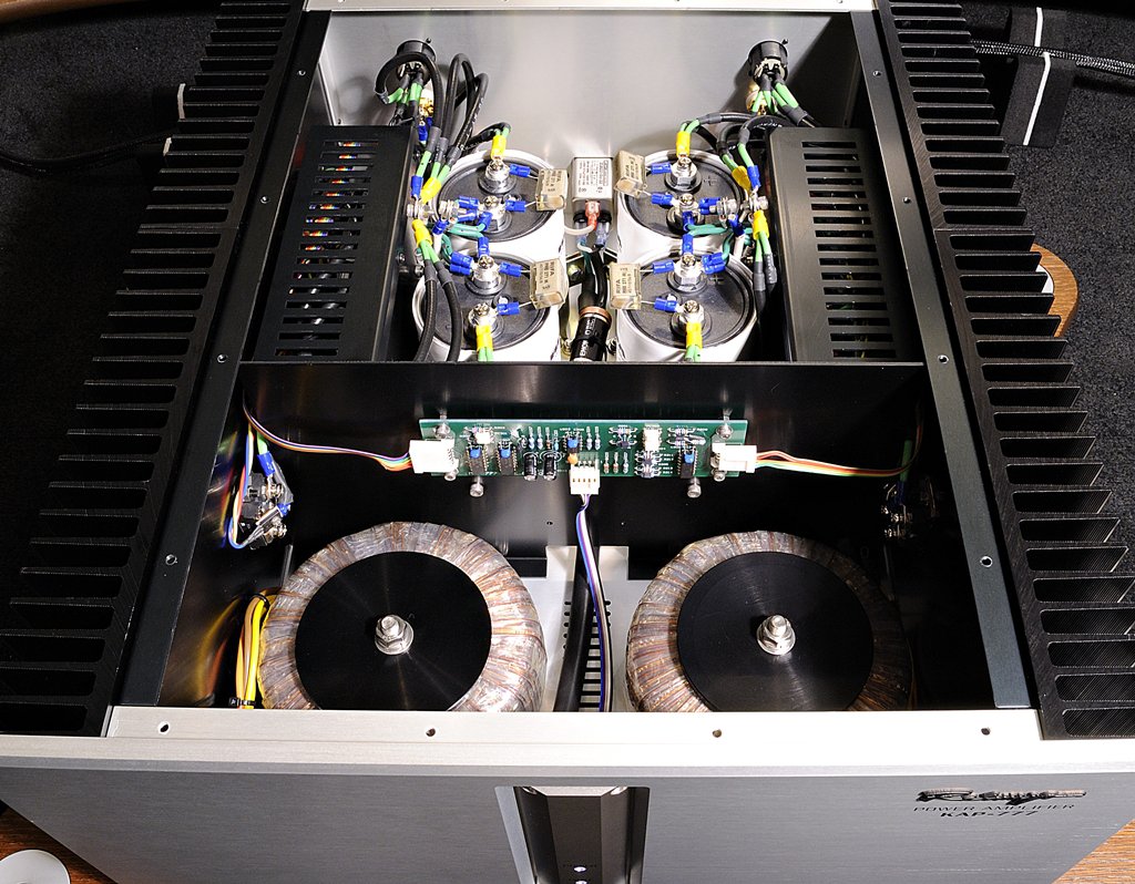

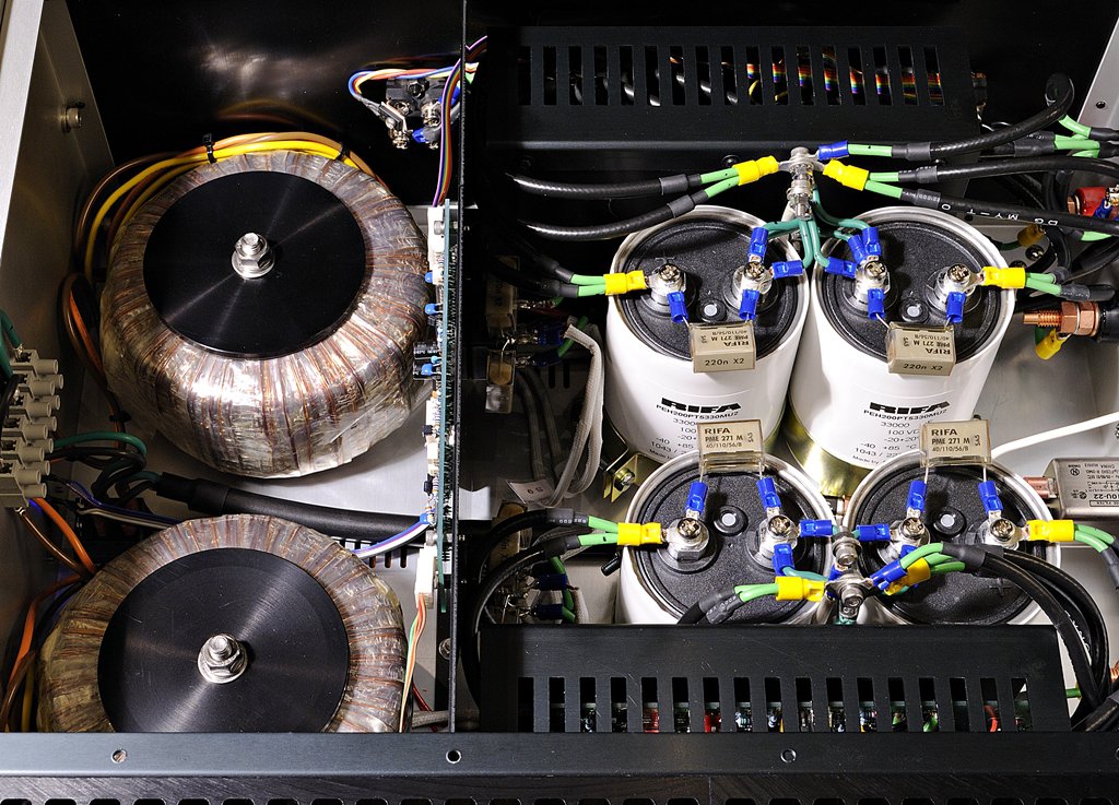

A new power amplifier from Reimyo:
model KAP-777
perhaps a "Single Ended" classA
about
REIMYO KAP-777 Power Amplifire
I read
It’s a unique Single Mos FET driven power amplifier
Perhaps Class-G with Single Ended Class-A main part (see data for output power)?
Who knows more?
https://web.archive.org/web/20081216052432/http://www.royaldevice.com/BluBayEng.htm
