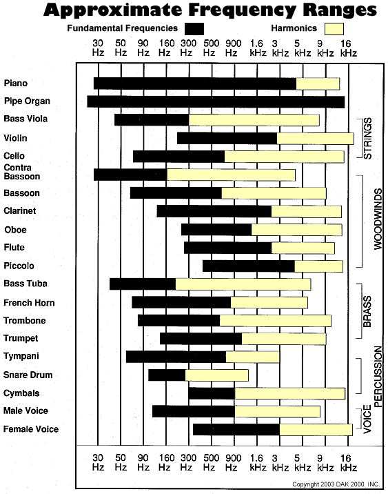

Hi Guys,
I've attached a gif pic that maybe of interest. Brian from Diyhifisupply sent me this graph a few years back. Note the frequencies and harmonics for orchestral music instruments and vocals. None reach 20-kHz.
I don't have the background to how this data was measured or generated so should you know more about this work, please tell us more
I'm not advocating the argument that its not necessary to develop audio beyond 20-kHz. I'm posting this information to give folks an appreciation for some of the likely acoustic elements involved in generating music.

Hi Guys,
I've attached a gif pic that maybe of interest... Note the frequencies and harmonics for orchestral music instruments and vocals. None reach 20-kHz.
