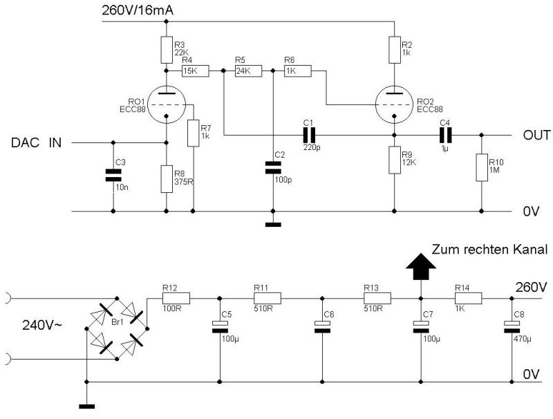

I've built Thorsten's tube stage for TDA1545 (see pic), but at the time of bulding it I was sure that the triodes in the envelope were interchangeable.
Now, after reading some datasheets I'm not that sure...
Amperex datasheet for the 6DJ8 says that triode 1(pins 6,7,8) should be the grounded cathode amplifier and that triode 2 (pins 1,2,3) should be the grounded grid amplifier in a theroretical cascode amp.
All the datasheet I read about E88CC/6922 don't mention this limitation.
My implementation, by Murphy's law, uses the triode "2" as the first stage (at lower voltage) and the other for the output cathode follower.
Now the question is: am I worrying too much or it is mandatory (or at least suggestable) to re-do all the work?

The crucial thing is leakage between the heater and the cathode. As you increase the voltage between them, the leakage current rises. People tend to treat Vhk as a hard limit, but it's really very soft. Given that your DAC is stereo (making an assumption here, but I expect it is), the best solution is to use one envelope for the cathode followers and another for the gain stage. Then, you feed the heater for the cathode followers from a supply sat on 120V or so (thus dramatically reducing Vhk), and the other envelope from a heater sat on 0V to 40V. (+40V turns off the diode between heater and cathode.)
....Given that your DAC is stereo (making an assumption here, but I expect it is), the best solution is to use one envelope for the cathode followers and another for the gain stage. Then, you feed the heater for the cathode followers from a supply sat on 120V or so (thus dramatically reducing Vhk), and the other envelope from a heater sat on 0V to 40V. (+40V turns off the diode between heater and cathode.) [/B]
I'm using this solution in my implementation of this I/V stage (the Dac is stereo of course).
Due to the fact that I've drawn a pcb for this stage, I've found this solution more comfortable, not only to provide the right heaters reference but also to draw a compact layout.
The ground grid stage has the haters ref. set to 0V, the cathode follower to 110V.

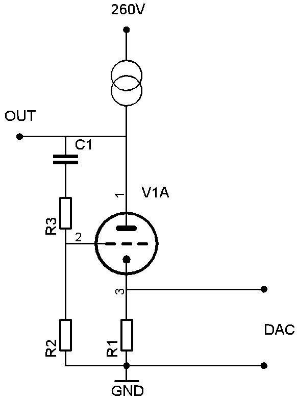

Regarding the gain of the first stage I'm thinking to a different solution:
1)add a ccs as anode load. In this way I'll provide better PSRR, higer gain, better linearity and the chance to fix in a better way the input offset from the dac ( I need 3.3V at the cathode of the input stage if I want to connect the dac in dc)
The gain of a grounded grid is (mu+1)Ra/Ra+rp so, with a good css, now is near (mu+1).
2) to lower the gain, distortion, noise and output impedance, I'm thinking to add a parallel feedback path, from plate to grid.
Look at the pic I’ve attached
Mark
Yes but is there any difference....
... between the triodes in the same envelope (in the cathode-heater ratings)?
This is the point I wanted to know...
Cheers
Andrea
Some data sheets suggest that there is a difference between the Vhk ratings of the two triodes within the same envelope, and others don't. I say it's better not to stress that particular rating at all. Use a separate heater supply for the valve with an elevated cathode.
