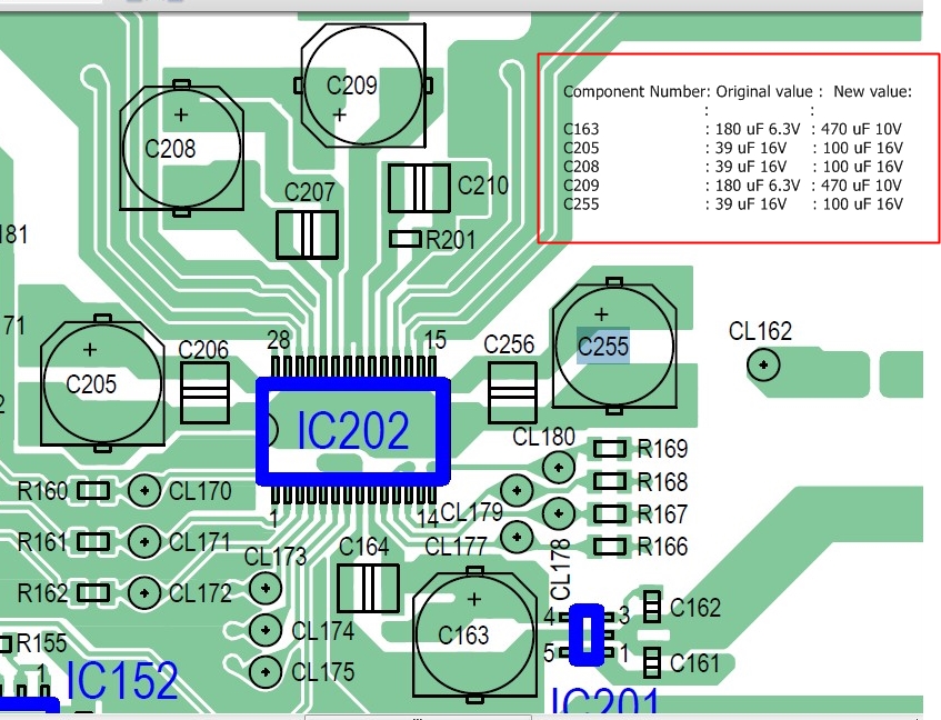

Hi Marce, thanks for your reply!
I have copied the page in the service manual and circled red is the caps i replace with the Elna's.
Why on earth would i do that you might think..
I have found a webblog of a person in Italy that modded his player and documented it thoroughly, this mod he describes as being a worthwile mod.
I maybe very stupid now.
Especially since i am almost done allready..
Please if you think it might be a very bad idea, can you than explain why?
Would be obliged!

C164, 206, 207, 210 & 256 are local decoupling caps, these should be left alone. As to changing the SMD electros, I would doubt you would get much if any sound improvement, the added inductance of leaded devices will change the decoupling scheme somewhat, but as they are larger reservoir caps not as critical for placement as the lower value caps mentioned above.

Anyhow, can someone please have a look at the values, they are in the right above corner of the picture. (BTW, the IC202 in the middle is the DAC chip)
And maybe clarify why there is the change in sound?
Would very much appreciate it!:snowman:
And maybe clarify why the different values change the sound so much?
Can you simply change values for these caps?
BTW, how sensitive are the (very small) ceramic caps to heat?? , i might have touched one with my iron, just a second or two but still.. (C206, C207 etc.)
Thanks, Rgrds, Simon

For critical power integrity I use this software at work....
CADSTAR Power Integrity Advance
This software was originally designed for a certain large electronics company for their power integrity verification. Changing the value of these decoupling capacitors has altered a lot of things, mainly the power supply impedances at the operating frequencies, this can have a negative effect! I would suggest that Sony did choose the values for a reason.
Heat on the ceramics shouldn't be a major problem, but if they are MLCC's they may have been damaged if the iron banged against them.

Hi Marce,
Thanks for the checkup with your program!
I checked the service manual, the small caps are not ceramic caps but described as:
Film chip, 0.1uF, 16V, 5%
Might have touched one or two of these (because of the very very tight space) for a second or three (at most) with an iron at 450Celcius..
Could this have deteroriated the sound or would they simply just fail?
resulting in a dead player, which is not the case with mine[emoji4] thankfully..

But have you looked at the values in the picture?
What is your opinion then? E.g. the voltage 6.3V oposed to the 10V? Isn't this value that crucial either?
I'd have to "decode" the board drawing to know which caps are doing which jobs for the dac. If you post the relevant section of the actual schematic diagram, I'd be more easily able to comment.
As for voltage rating, the only thing that matters is going with same or higher voltage rating, although I have to say I am not comfortable with 6.3V caps unless they are Nichicon. I've found that 6.3V caps from other brands are a whole lot less reliable than 10V+ of same brand, regardless of actual operating voltage.
