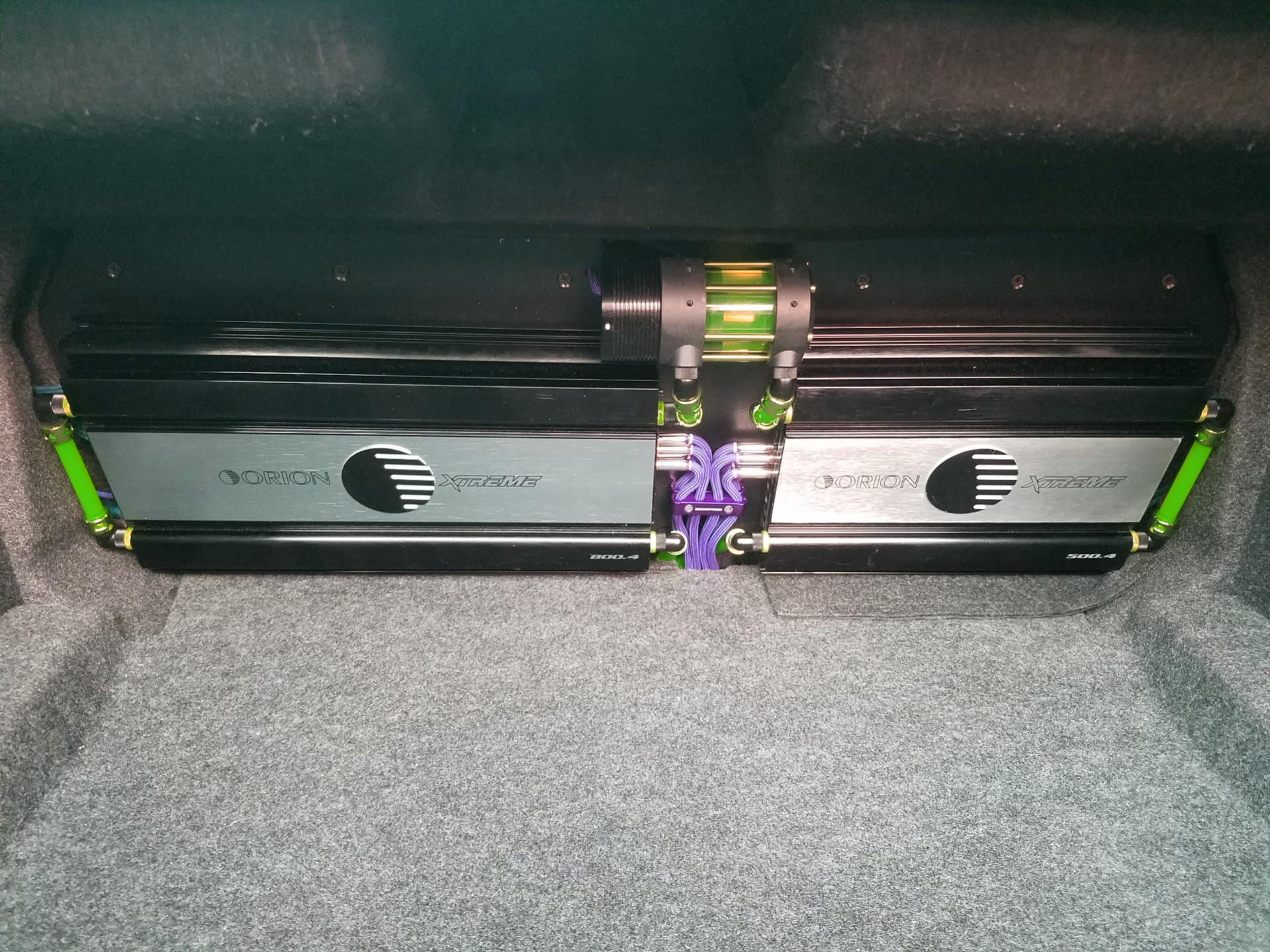

Funny you should mention water cooling those amps (see attached photo). Those are the amps I am currently running. They aren't the specific amps I was going to do this to but rather the same board, as I mentioned I have a couple brand new boards that were never populated...only have the resistors installed. I also have some new heat sinks of that same style.
